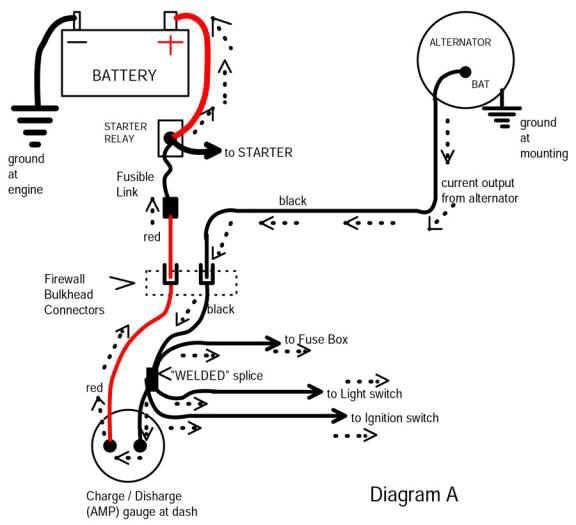

Cool. Regarding the amp gauge, the one on my '84 gave me serious electrical issues... fried wires, etc. I may have had other problems, but after bypassing the gauge, all was well. Last year I found an in-depth article online (which I can't find now) on how those gauges were melting wires, and themselves, due to how much juice was flowing through them... the plastic lens on mine was warped. Someone else here might be able to provide more details. They eventually changed to voltage meters, but I picked up a 12v voltage meter that's been doing the job well.
I wasn't sure what you were getting at. Thanks for the tip. Can I just disconnect the wires from the guage? Technically the wires going to an amp meter guage runs in series with the heavy wire going to the battery. They call it a shunt or something. Is that how it's wired up on this van? In other words disconnecting the guage won't affect the charging system?

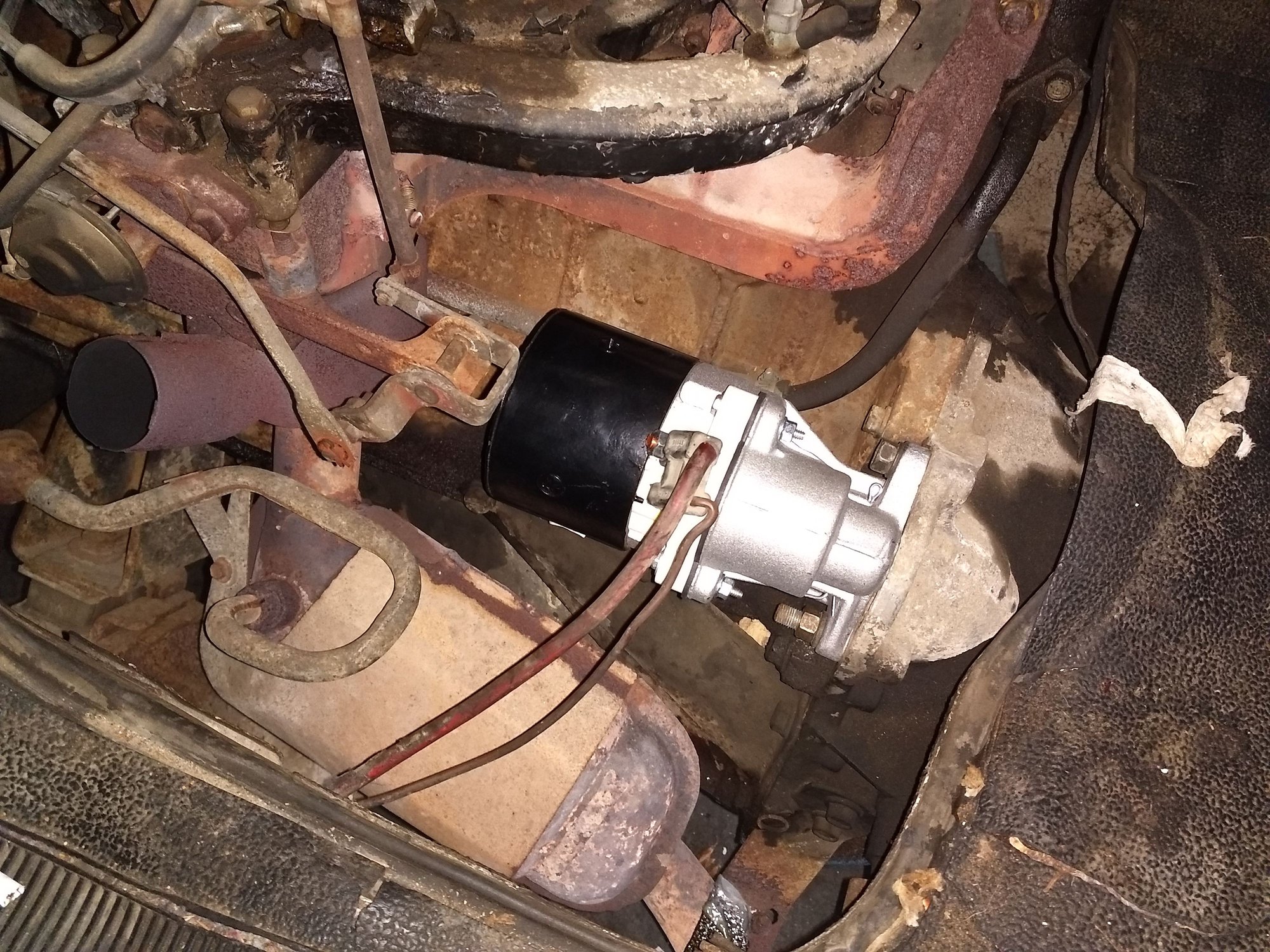

I thought the battery was weak on this van because the engine struggled to turn over. Eventually it got to where the starter just clicked. Luckily it did this in my garage.
After testing I found the Bendix was engaging but the starter motor wasn't spinning. I bench tested it off the motor with jumper cables to confirm.
This was the easiest starter by far to swap. The only time I've ever swapped starters from within the vehicle!
It was a while ago, so I don't remember the details on how it all played out. But these diagrams helped us troubleshoot the problem:
Old Jan 17, 2020 | 02:17 PM
James Siebold's Avatar
James Siebold
Joined: Oct 2019
Posts: 88
Ok based on that looks like all power has to go through the guage rather than a smaller shunt wire in series. So yeah I can see how that would cause an electrical fire. Looks like running a second thicker wire from the battery to the alternator would be an easier fix than messing with the guage wiring. I think the guage cluster is a printed circuit board and those connectors pull apart after awhile if unplugged. The top diagram is not showing the voltage regulator for some reason.
