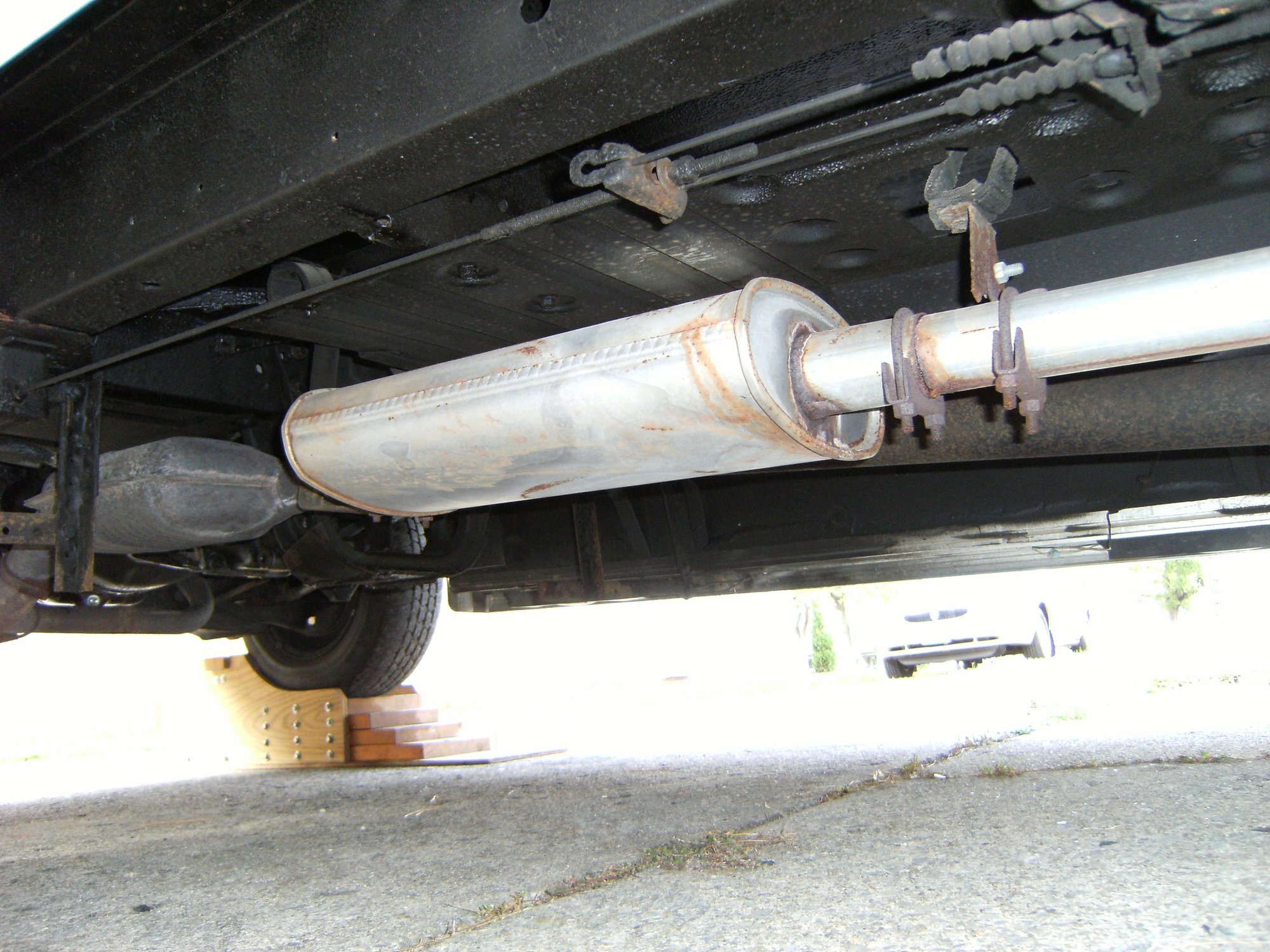

wca_tim has a great idea. There's lots of room for the fabricator to work with. It's been said already that these Dodge Vans have a "hybrid" frame ' with fully boxed frame in front & unibody in back. The unibody is better than most vehicles since it has frame-like rails & crossmembers. See my pics for front stub frame & rear areas. The rear is sheet metal thickness, but it's reinforced in areas for spring & shock mounts.
ANOTHER UNDERBODY PIC
UNDERCOATED WHEN NEW. NE OH, 30 YRS OLD
