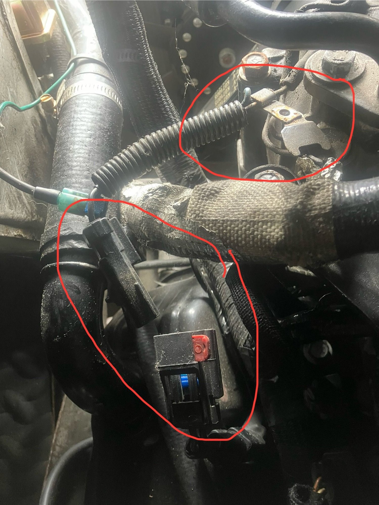

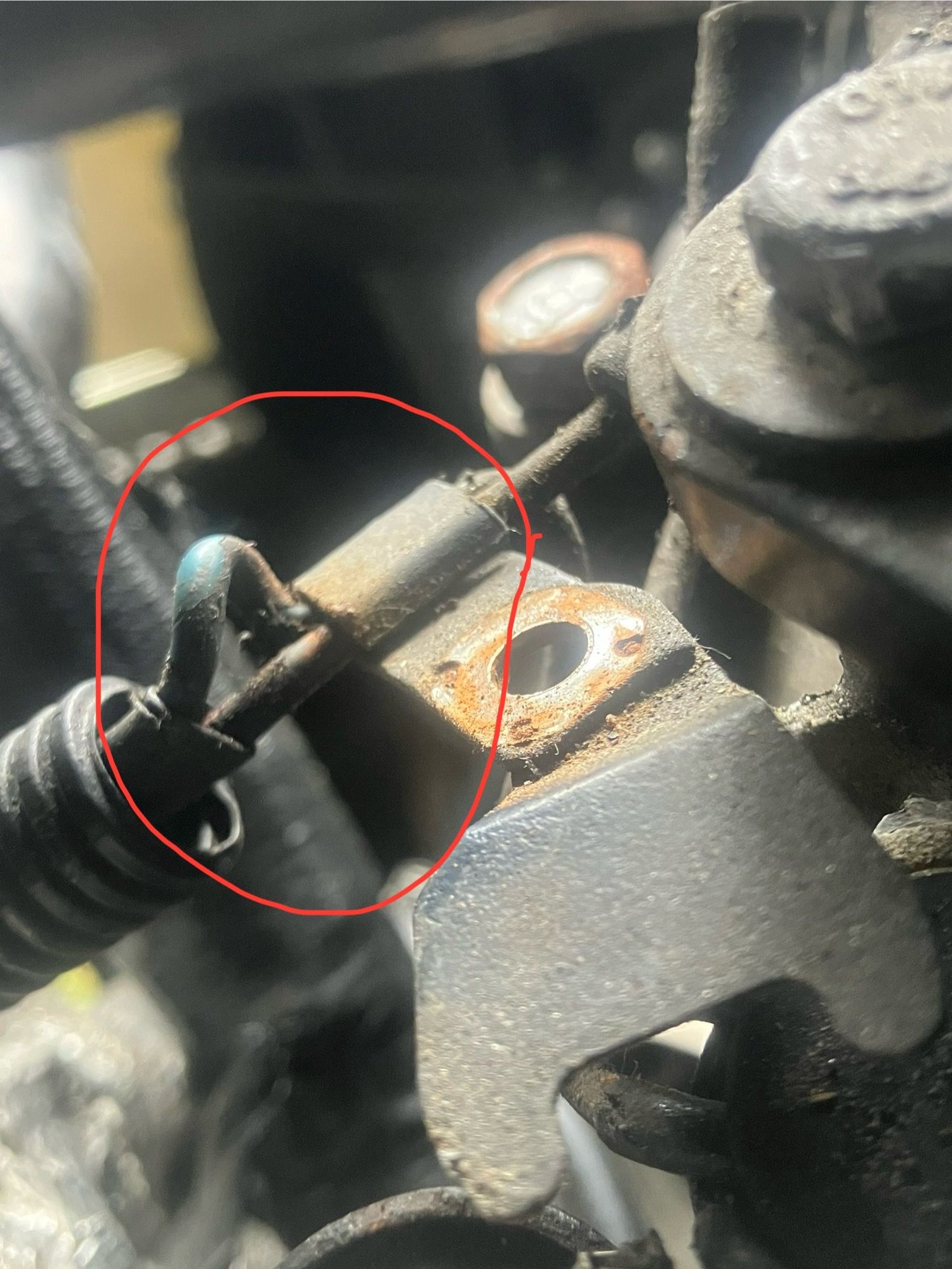

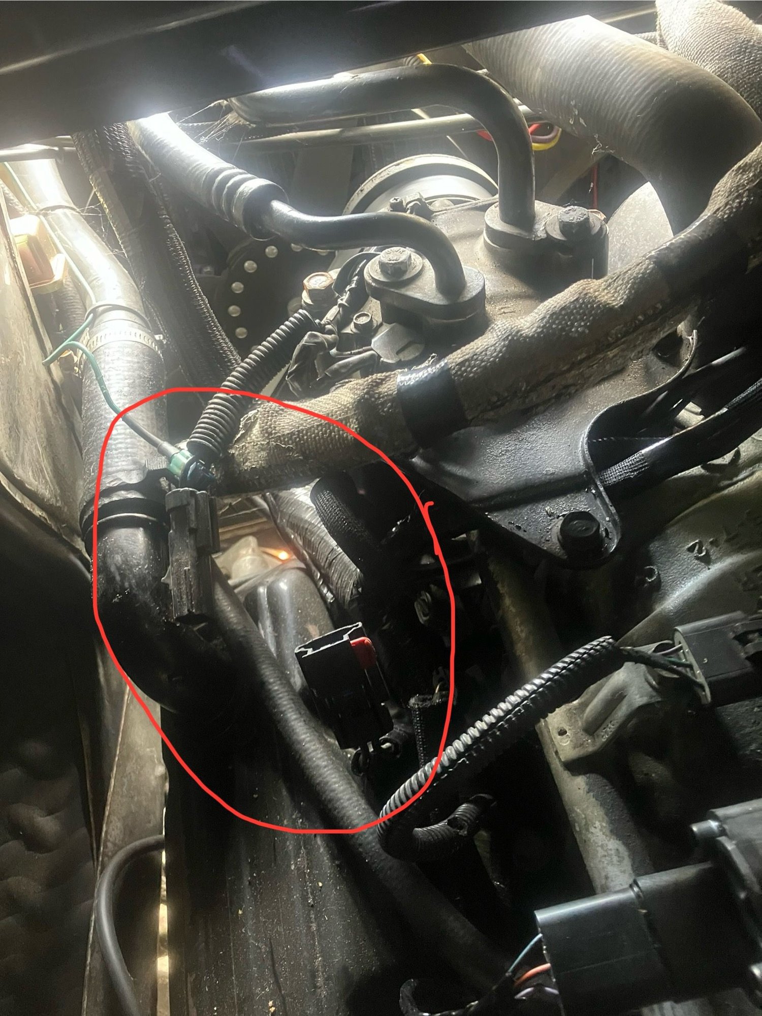

I have solved intermittent stalling issue by unplugging Air Conditioner Compressor Wiring Harness. Small bracket holding harness doesn’t have rubber grommet and therefore cuts into wire creating a short. Please see included pictures. I hope this helps.
