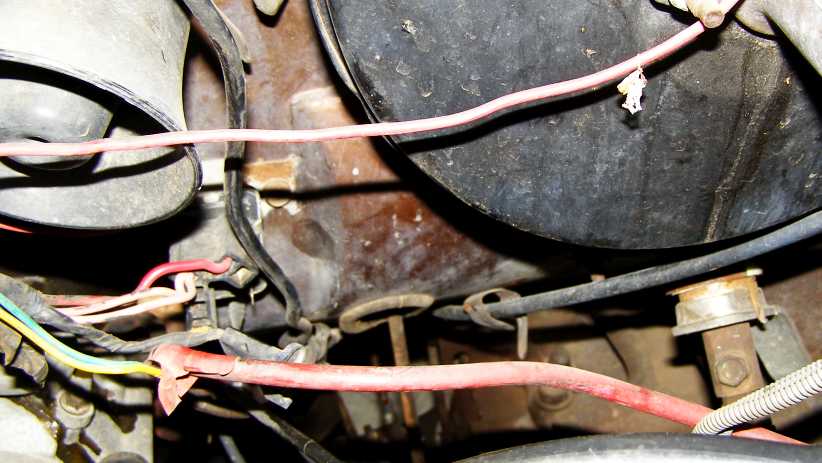

I got it out of the garage today. I took pics, but could not make the measurement you asked for. There's a trim panel that needs to be removed. Ordinarily no problem, but I attached an A/B speaker switch (12 wires) & an aftermarket time delay wiper module. It's a job (& a risk!) to take it off.
There is an indentation in the firewall where the grommet goes through. I took a couple pics just reaching the camera up under the dash showing the clutch pedal & pivot. I hope these help.

That firewall pressing is definitely different to mine, though it's hard to tell how different. Not impossible, I guess. But your pics of the clutch pedal are at the pedal end, what I need is what is at the other end of the shaft. The bit that pushed on the rod to the master cylinder. Any chance of getting something of that?

I thought that's what you wanted, but there is no room to get a pic easily on the other end of the shaft. That bracket that holds both the brake & clutch pedal pivots blocks the view from beneath. I'll try to get a mirror & flashlight to see if I can get a "reverse angle" view on the clutch pedal shaft that actuates the master cylinder. There's a chance I might drop the steering column to get a better look. I have a rebuild kit for the steering shaft coupler (above the steering box - it has two shoes). I may not be able to do that job & end up sending it to a shop in May. If so I'll ask if they can take a picture of the exposed clutch pedal & master cylinder.

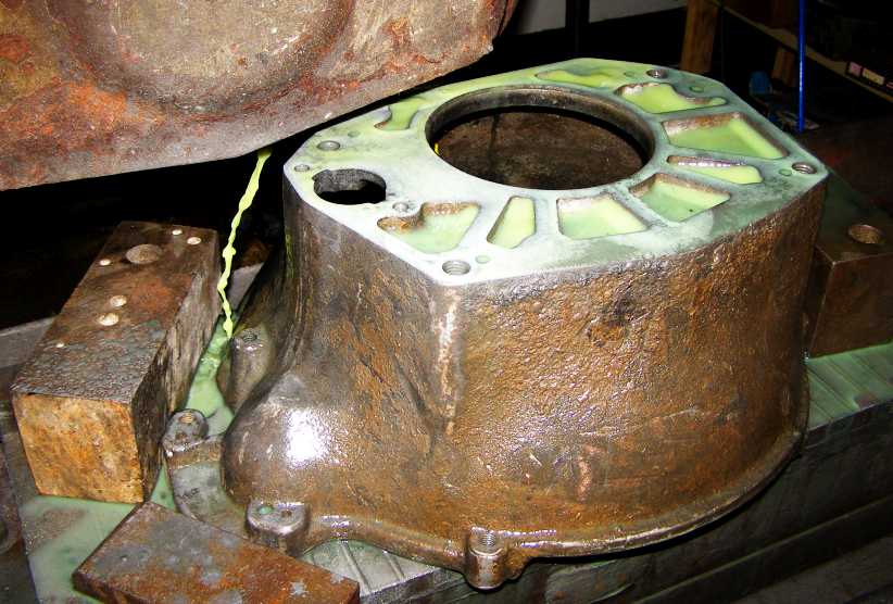

My nephew has refaced the back of the bellhousing for me...

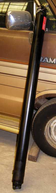

...and I'll get on a lathe somewhere and make some offset dowels to make sure the thing is absolutely straight and square. I did get a driveshaft from a pickup (very rare here, only private imports) and had it shortened. I have to replace it next time I go to the US, of course.

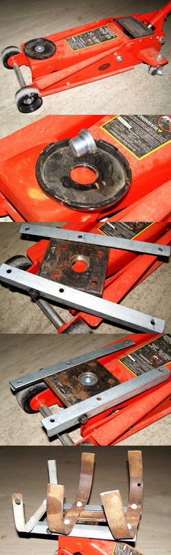

And the floor jack has been looked at with a view to using it to lift in the transmission. I made a frame which swivels on the original mount at the front of the jack and then worked up a frame which will carry the gearbox and also tilt to get the right angle:

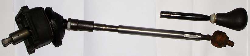

I've started putting together the gearlever for the van. The gearbox only has a stub sticking out of the top, this has a 16mm x 1.5mm thread. A couple of weeks ago I started looking around my stuff and found that a Falcon steering rack I had had the same thread for the tie rod ends. I pulled a tie rod end off that (it was knackered), then I cut a tie rod out of a scrap car at a friend's place in case I needed that piece to bolt into it.
The intention was, and has become the fact, to cut the tie rod end and use it as a joining piece to screw a lever into. A while back I sourced a bunch of odd bolts at the wrecker's when I was after something else and one of these bolts had a step in it to take its OD to 16mm... handy... and the other end had a 14mm x 1.5mm thread. Which is the thread found on the (mostly hollow) tie rod of a Peugeot 504. I have a few of those things lying around.
I went around to a friend's place to see if he had the tooling for his die-chaser to cut a 16mm x 1.5mm thread. I think it was the only metric one he had, anyway, he turned off the head of the bolt and cut the thread. And squared off the end of the remains of the tie rod end I'd sliced in two yesterday in the lathe... I cut that at the point where the internal thread ended, so there's plenty of thread in contact at both ends.
For some reason or other I had cut off the gearlever of the Mazda 626 I scrapped a couple of years ago, probably so I could get the boot, but anyway that's a piece of tubing about the right size to get itself welded to the other end of the Peugeot tie rod when I hack off the ball (which is knackered anyway) tomorrow. I'm not sure what length the lever needs to be yet, so I'll leave that until last, I think I have about two or three inches to spare there.
And guess what? The gearchange pattern on the **** from the Mazda is the same as the NV4500. Which matters because you must have the pattern showing to comply with local laws here.
Nothing goes to waste here, the lock nut from the throwaway tie rod still needs to go on this assembly to lock it up at the bottom end, I now need to go through my Peugeot nuts and bolts to find a 14mm lock nut from the Peugeot tie rod assembly, I do have them...
