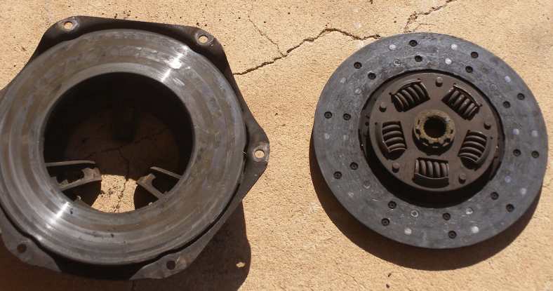

...as I had taken all the necessary tools with me too. It was an interesting day because I learned that the real problem was the pressure plate. This was a finger-type and it must have been out of adjustment (ie. one finger applying either more or less pressure than the others) as there was serious wear on one side:
If only I'd taken one of my spare pressure plates!
Needless to say, this maladjusted pressure plate caused further problems, principally in that I could never get a complete release and this meant that going into first or reverse gears would graunch the gears. Graunching the gears meant that filings would be generated, they would circulate in the oil and get into the bearings and by the time I got home that beautifully silent A833 was a long way from silent.

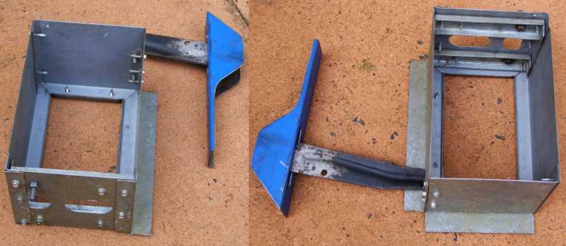

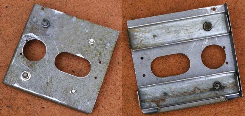

Here's the fabrication so far, starting with the front of the box to which the master cylinder will actually bolt up:

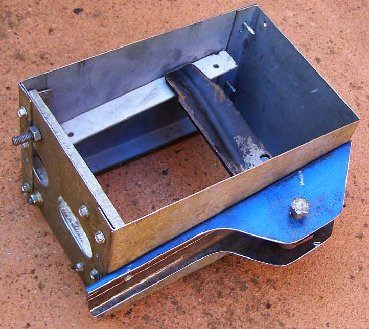

Finally, with the 'core' of the operating lever in place. Note that it's operating at the same angle as the master cylinder:
By the way, that lever and also the core of the bell-crank I've made are both adapted from pedals from a Peugeot 504. In fact, all of this is pretty much made up from things I have lying around. The box itself is either 18g or 20g steel cut from some department store display shelving. Hence that nice lip at the bottom of the box and the fine 90° bends at the corners. Other bits are made from RHS tubing I've sliced up using the angle grinder.
As it stands it's all held together with TEK screws, but they'll be undone one at a time and the holes welded up, thus spot-welding the whole thing together. Other holes will be drilled so there will be more spot-welds and those mitre joints at the bottom will be welded up.

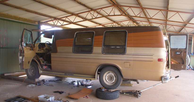

I'm progressing with this as we're subject to very restricted outside movement due to the virus. The gearbox, clutch and hydraulics are all about 600 miles from me and I can't go there to get it. When we can move I will drive there and do the installation there because it's at the home of a friend who had more gear than I have... mill, lathe, better welding gear and a lot of experience at fabrication... he used to build racing cars for a living.

Once I as home I changed that gearbox, the Arkansas box was in very good shape and all was happiness. A little while later I detected clutch slip, so when I set out on a big trip to Central Australia (8,600 miles) I took a spare clutch plate. And I needed it, changing it in a deserted shed out in the South Australian desert where the local horse racing people had abandoned their racing...

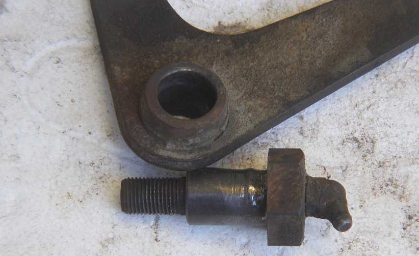

Meantime, here's a pic of the poor neglected bell crank setup pulled apart to see why there was lots of slop in it:
