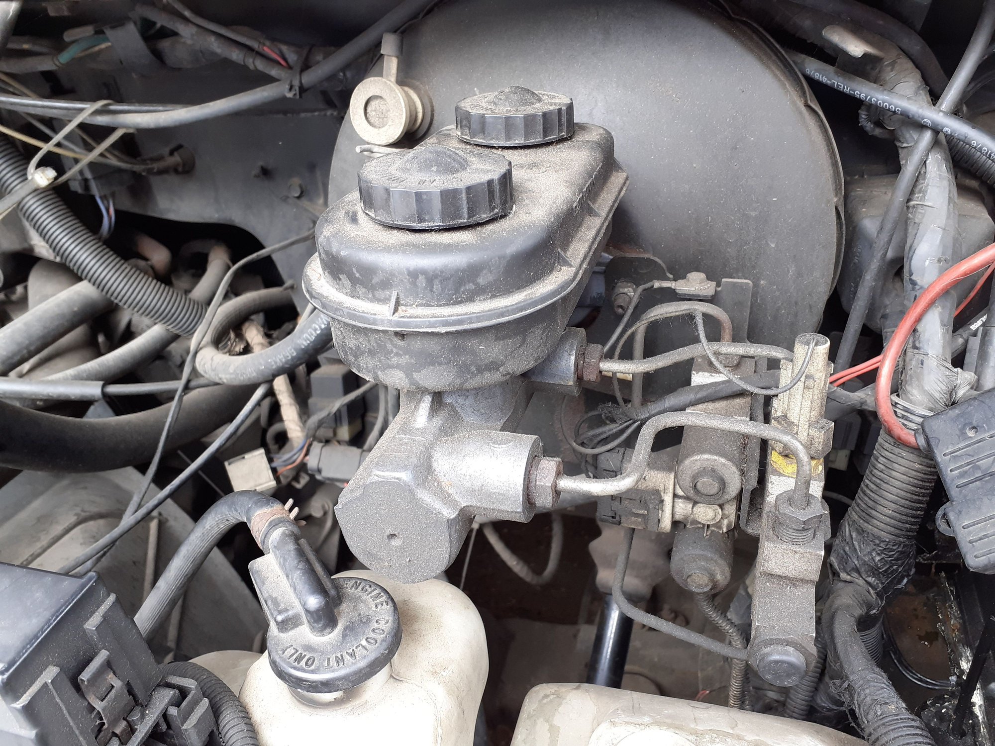

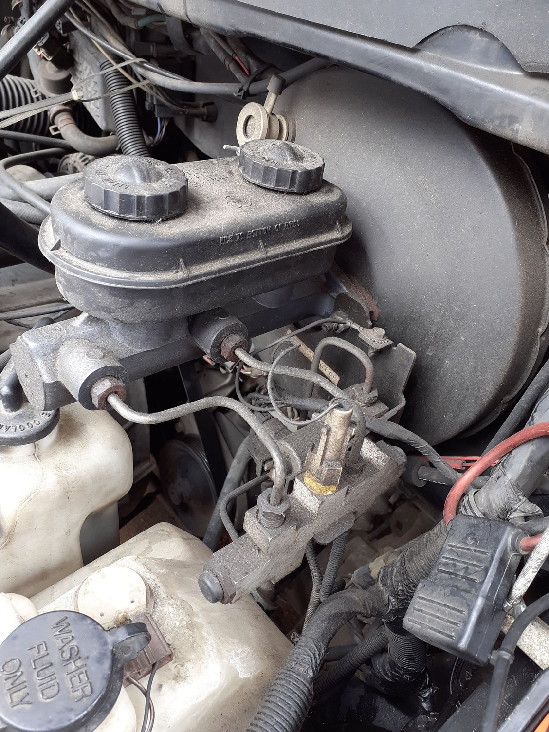

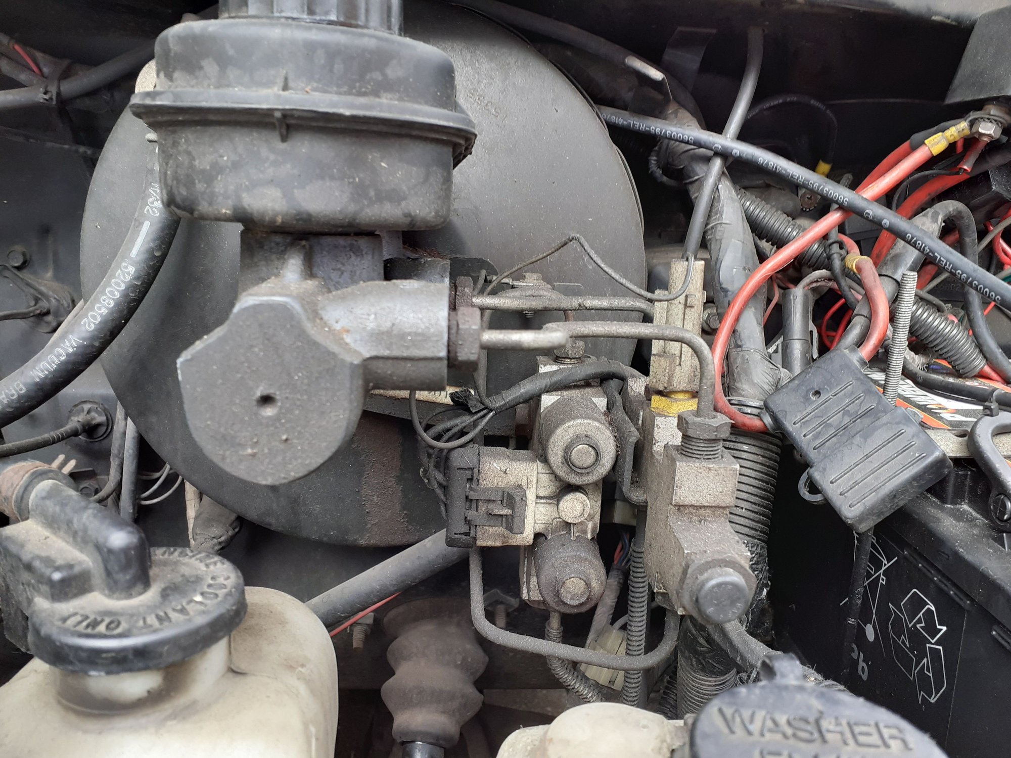

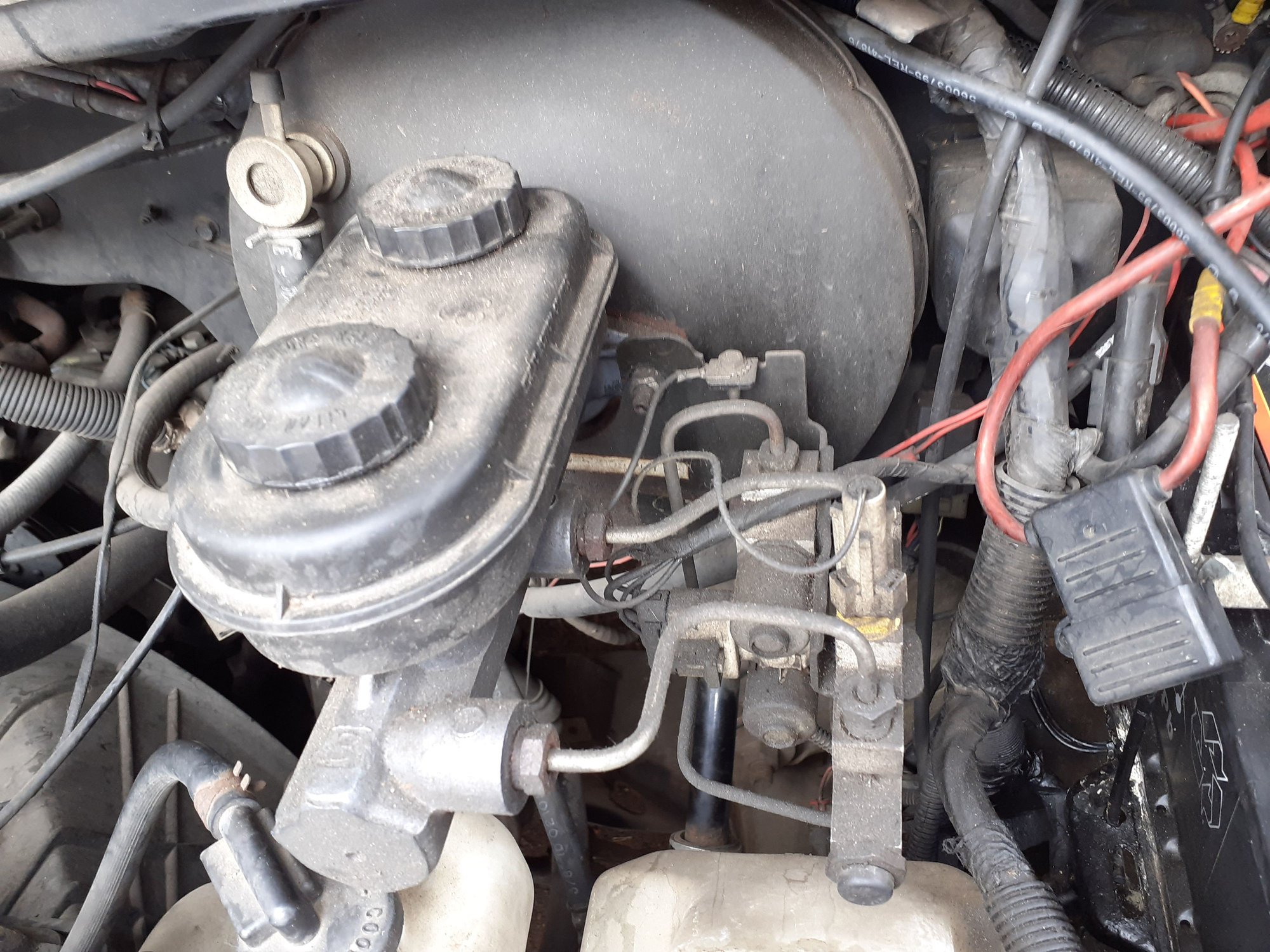

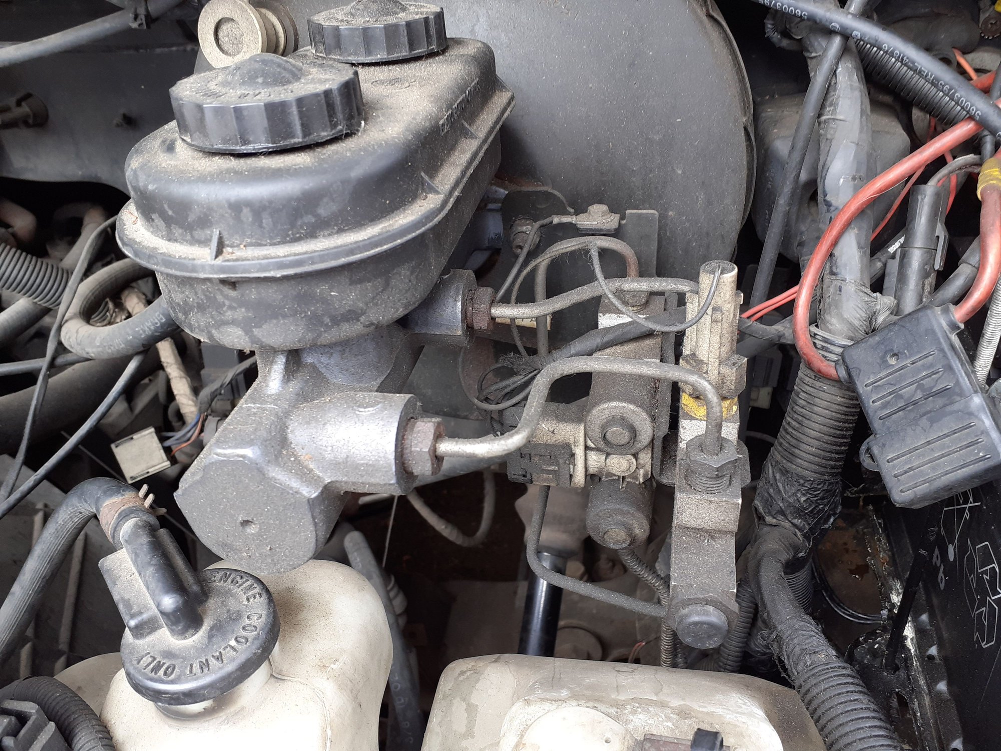

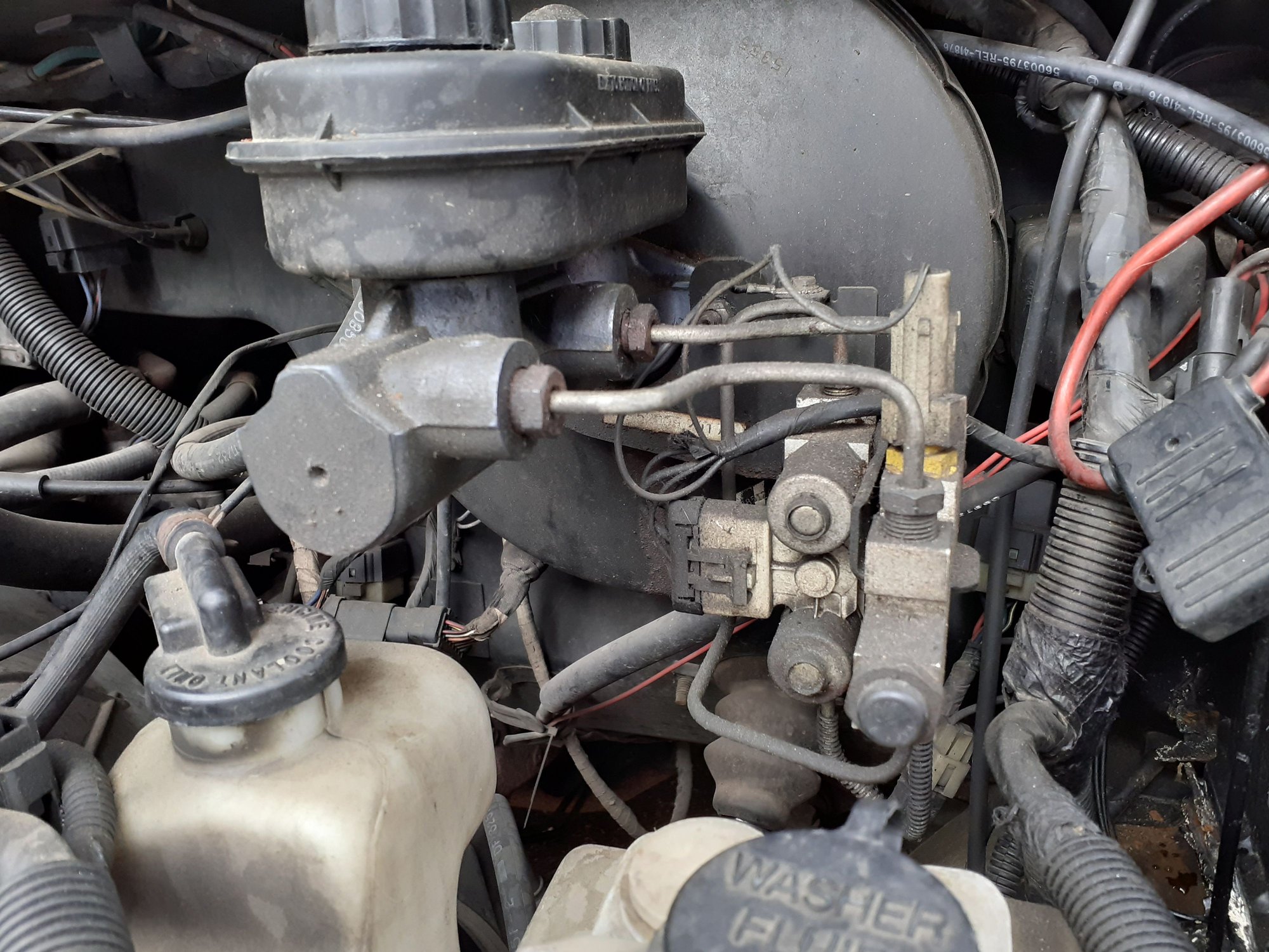

This is my brake master cylinder, it only has 2 lines coming out, does that mean only 2 wheel abs?
Can anyone confirm please?
Thanks
Old Jun 5, 2020 | 11:20 AM
Posts: 87,453
Likes: 4,218
I see a dump valve there, not the abs controller you would expect on 4wal, so, yeah, you have rear only abs.
