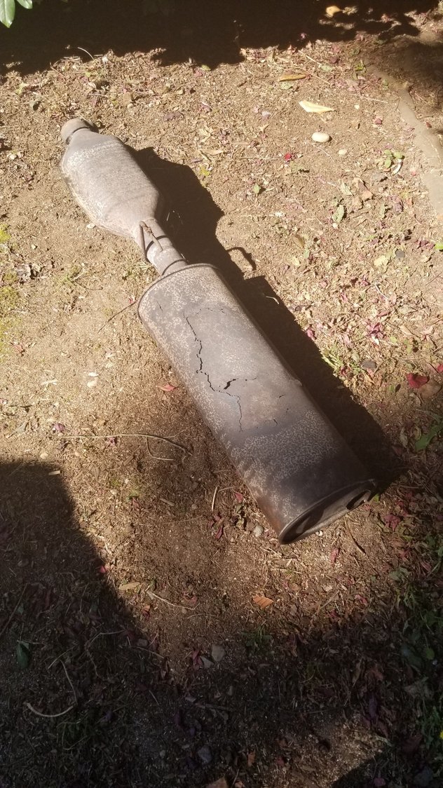

...and now this... new muffler installed.
Only problem is I need an adaptor from the exhaust pipe to the catalytic. I need something to join that pipe to catalytic converter which requires 2.5" OD to the exhaust pipe. Something like a 3.75" OD to 2.5" OD adapter.
Can anyone confirm the diameter of the exhaust pipe, the end opposite of the manifold flange? Couldn't find it in the manual or find a stock replacement to reference... I searched for everything I could think of and can't find an OEM replacement for the y pipes that go from the manifold to the catalytic converter.

Pipe *should* be 3 inch at both ends of the cat, I think......

Thanks! Got the proper adaptors, but dang exhaust systems suck. Not a fun job.
Any ideas on what that hose is? I'm now getting minor backfires from the exhaust manifold area. Wondering if that has something to do with it...
