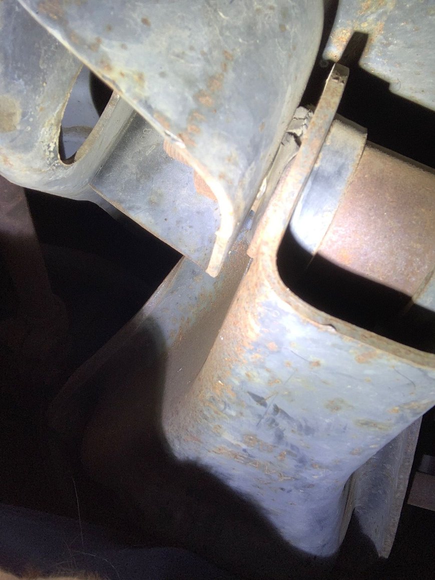

Default Passenger Lower Control Arm rear bushing
Thanks for the guidance Busted knuckles and Hey you.
I did jack up the right side. Grabbing the wheel, there is a mild slop of I believe wheel bearings. I would estimate 1/16" play. I didn't remove the wheel, but can. I got a late start today, like 1 hour before dark, in my driveway. I also had my wife lift the wheel with a lever while I observed the ball joints; no movement.
Next I re-inspected the steering and sway bar. The sway bar links look ok, and I could not get any wiggle or motion out of the system. All the rubber looks ok, but old. Ive read that they wear inside and need removal to really inspect, so I think I should just do the sway bar bushings if Im going to dissassemble. Tie rod ends look good (and steering itself has been fine. no play)
Next I inspected the control arms and the related parts. (I dont have all the part names down yet and no diagram). I think I may have located the culprit. Take a look at the pic. This is the only bushing that looks deformed. However, if this lower control arm bushing needs changing, it seems I should just change all the rubber/bushings both sides. Am I correct here? I have done lots of wrenching, built engines, etc., but really have no front end experience. It seems control arm bushing replacement will require removal of pretty much everything. Am I accurate here? Thanks for the help.

Next I looked at Sway bar system. All looks pretty good and I could not play tugging and prying on things lightly. Hardware all tight to end wrench. Lastly, I looked at control arms and related parts. (I dont know each part name, as I have no front end experience and no diagram, but each fastener was tested and bushing looked at. The only one I found that looked bad was the passenger lower control arm rear bushing. Attached is a pic. I think it may be the problem.
However, it looks like a bear to change that part. Am I correct in thinking this requires removal of pretty much everything to change this bushing? If so this is a job for a front end shop, as I dont have time and special tools for this larger job. Also , I read you need to remove the sway bar links to really inspect them as the bolts/bushings wear from inside. Is that true. Thanks again for any input.

Those come with the whole control arm assembly...I would just replace that...
I am unsure if the springs are uncompressed or still compressed when jacked up (can someone verify?). It wouldnt be that bad of a job - just the ball joint and center bolt to remove...
Old Nov 30, 2020 | 05:08 PM
Posts: 87,479
Having a spring compressor on-hand for the job would be a good idea.....
