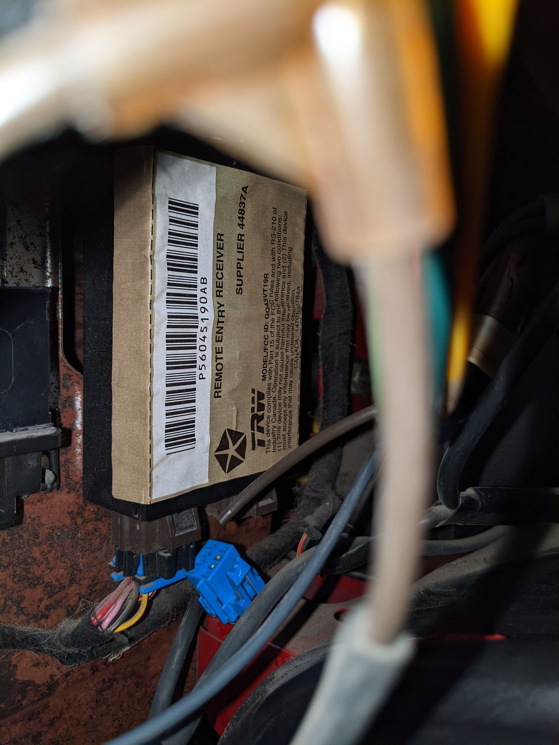

I opened the doghouse today, and found where it goes:
So apparently this van had remote entry at one time, and it was probably unplugged when the original keys were lost. It is probably possible to get a new fob and get it working again, but right now that is low on my list of things to fix.
Old Aug 6, 2021 | 06:26 PM
Posts: 87,475
Yep, get new fobs, but, I think the dealer has to pair them with the van.
