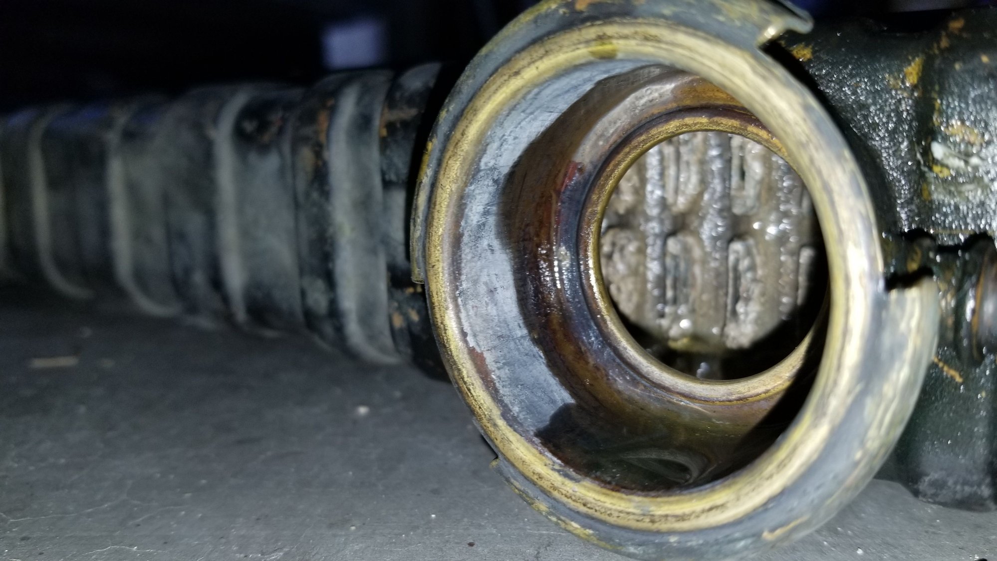

I'm still running the stock clutch fan. In my case, my radiator turned out to be badly clogged. I tried to baby it to get home, but it ran hot all through the Rockies, even in cool ambient temps at night.

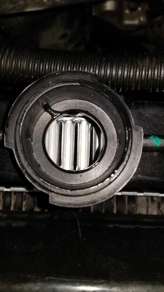

I didn't want to risk crossing the desert with it in that condition, so I spent a day in a friend's driveway in Las Vegas replacing the radiator. I wanted to go with a 2 row all aluminum radiator, but at that point I had to go with whatever was in stock at the store. So, 1 row plastic/aluminum it is. I had hoped to find something better, seeing as how Vegas has some big radiator warehouses, but no suck luck.
The good news is, I was able to cross the desert that evening and get home to central California with the temp gauge firmly in the normal range. True, it wasn't as hot as it would have been in the daytime, but that just means 90-100°F ambient instead of 110-120°F ambient.
​​​​​Old, clogged radiator
New radiator
