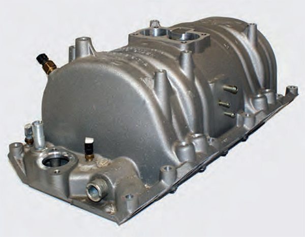

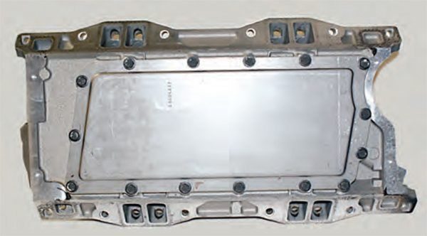

To be losing that much oil I'd probably rule out rings or valve seals. On the bottom-side of the intake manifold in magnum engines there is a metal plate with a gasket. When the gasket springs a leak not only is there a vacuum issue but oil is also drawn into the combustion process. Here are pictures of the top of the manifold and the bottom showing the plate.
