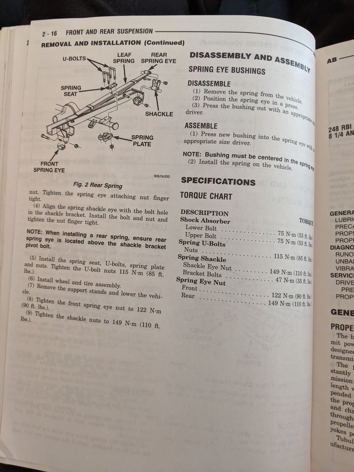

Hi. I can't offer advice, but I have the same model van and had the rear shocks replaced recently without issue. If it helps I can post pics of mine for your reference. I also have all the service manuals so I can look up the springs procedures too if its helpful.

I'd love to see pics of the original setup. What manuals do you have? I have the basic haynes or something, but I know the procedure can sometimes require cutting the bolts out. Like HeyYou said, they don't really expect you to mess with these things.
Anyway, I would love to see pics. Much appreciated.

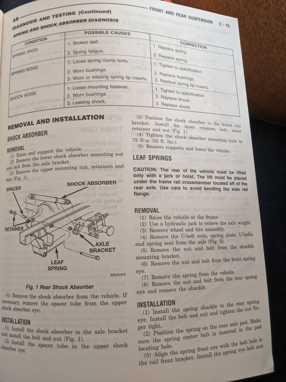

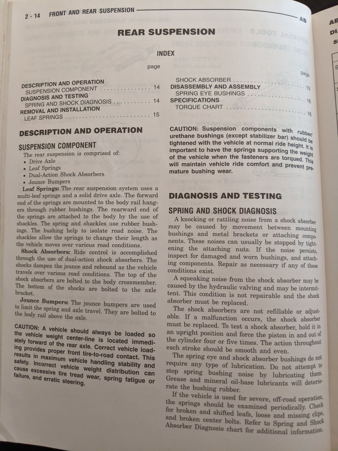

I have ALL the original paper service manuals for the 1999 Ram Van, because I am old school like that. 😂
Let's start you with this, and you tell me if I need to include more info:
