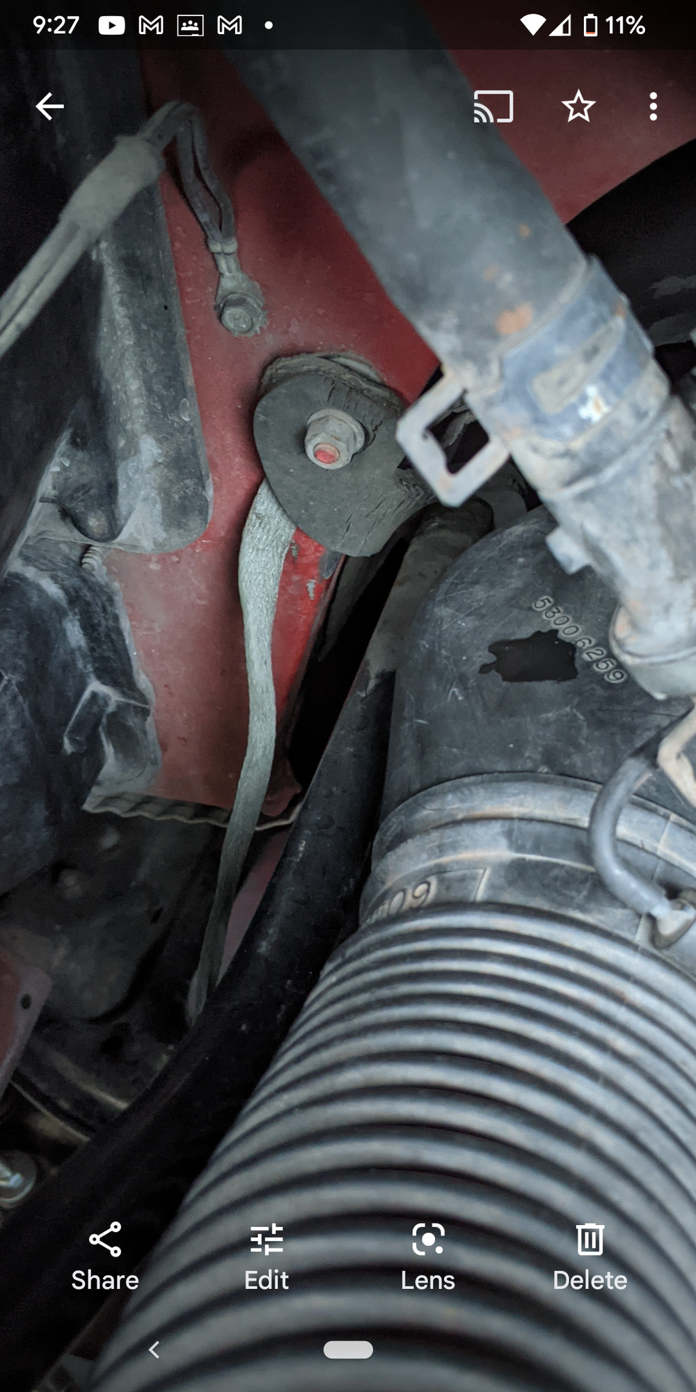

I have a 99 1500 5.9L that has been running great until a couple of days ago, when it stalled completely and lost all power to the dash going up a major freeway overpass going 75mph. After I coasted to exit and stopped for 2-3 minutes, I got a check engine light and a low gas light. Then about a minute later both warning lights disappeared and the gauges showed everything was fine, and it I was able to start it again.
So from what I read on this forum, first step is check the ground wires. I have never done this before, but I located the ground wire next to the battery and the ground strap from the engine, and they read the same as the battery on the multimeter. But I noticed two things that were mentioned in other similar threads:
First, the ground wire from the battery is a skinny, probably 12 or 14 gauge wire, and it was suggested that it should be upgraded to a 4 gauge wire? Also, I found a disconnected wire from the battery which may have been the original ground or something else that may or may not be a reason for the failure:
So any advice there would be appreciated.
Second, the ground strap was extremely dirty, to the point I had trouble locating it because it did not look or feel like metal anymore. While it read on the multimeter fine, I assume that level of grime can maybe cause a spontaneous grounding issue?
Also, are there other grounding points I should be checking?
Thanks!

There shouldnt be any JB Weld on the ground located on the firewall.
Thanks, good eye. I went back and checked because it looks like it did from the picture. But that isn't weld, it is paint badly scratched down to bare metal. A lot of scratched paint - I have no idea what the previous owner did to make it look like that.

I am now also wondering if it is better just to replace the grounding strap rather than try to clean it. I am always hesitant to replace things because they are almost never as qood quality as the original 20+yo part.
Old Nov 5, 2021 | 05:15 PM
Posts: 87,409
Likes: 4,214
Clean all your grounds that you can find anyway. The meter does not put any kind of load on the connections, so they can pass that test, but, put a load on it, and it just doesn't fly. Wouldn't hurt to clean all the positive connections you can find as well.
