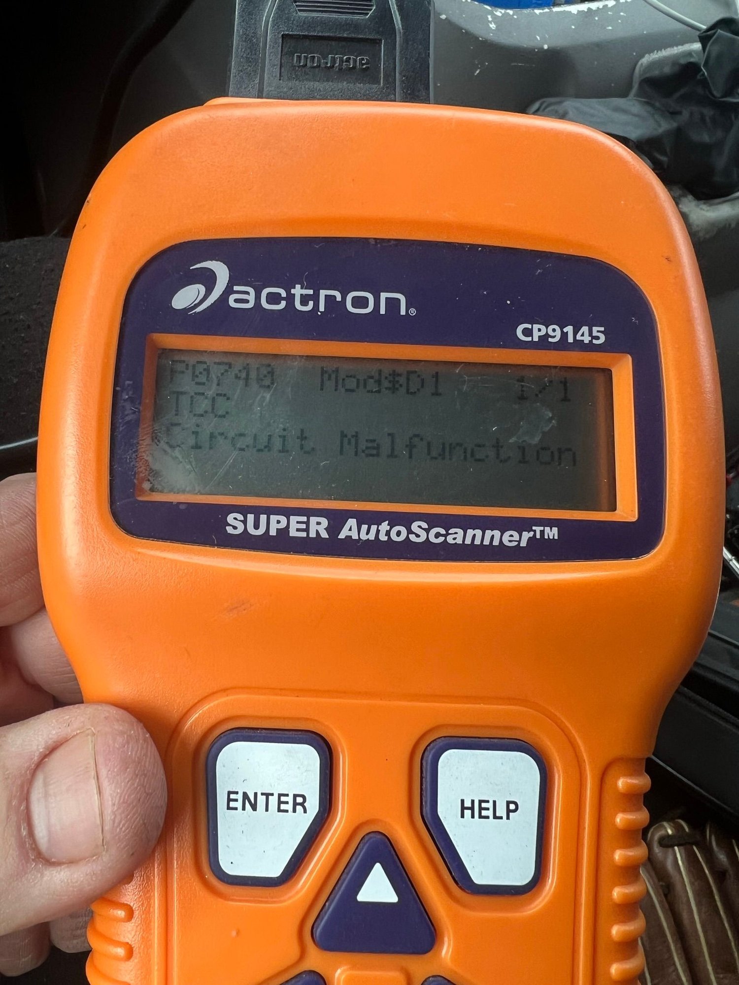

* started driving van regularly November at 119k
after 500 miles started getting P0740TCC torque converter code. Trans worked fine.

There is a 2-wire that goes to the front of the tranny to control the TCC. Sometimes this wire rubs the bell housing and the insulation wears off causing the conductors to short to ground.
