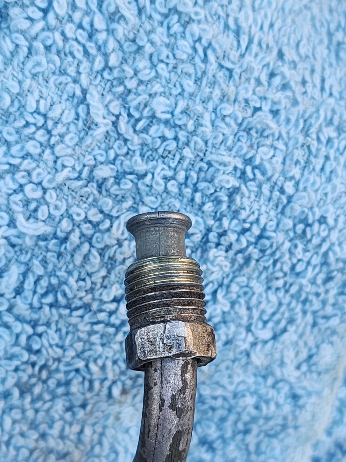

I haven't been around for the past week and a half but now that i'm back, im still struggling with leaks after the fuel pump swap. At first it was a small leak where i had to swap the hard line over, but i think i may have over-tightened it and caused the hairline crack on the flange that everyone warned me about in the videos i watched. It went from a small drip to a nice trickle so i decided to pull the pump back off to investigate closer.
Anyone know the name or part number so i can source a replacement? Can i just fit a barb and go softline up to the carb since half of it already is?
I suspect i may needed some teflon tape to get a better seal without having to over tighten the fuel line but i didn't see any used with the old one - didn't think i needed any with the new one
Good news is that we are able to get her to turn over by priming the carb with gas and she stays running on her own while i crawl around trying to fix the gas leaks

Cut the damaged flare off and get a double flaring tool and re flare it. If you never flared before practice on a scrap piece before you attempt to make the repair.
Well, i didn't think i could even do that - but i guess you're right it should be just like any other hard fuel or brake line, right?
I love that this van throws new things my way, off to learn something new! Thank you!
