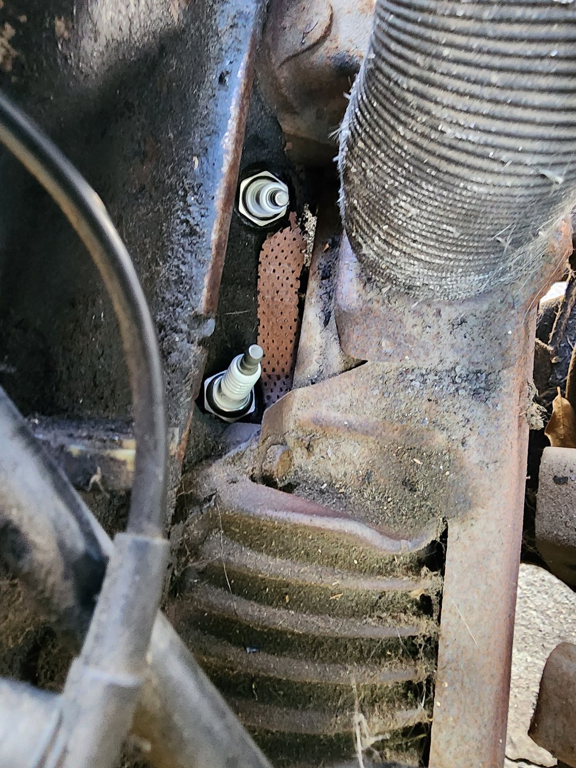

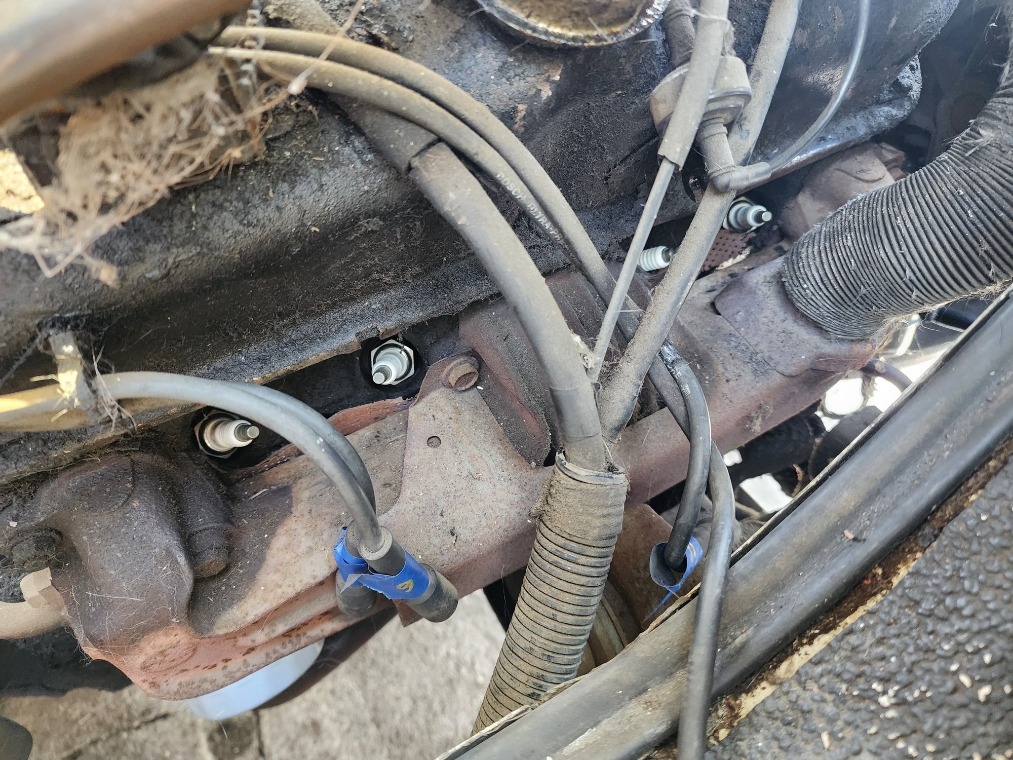

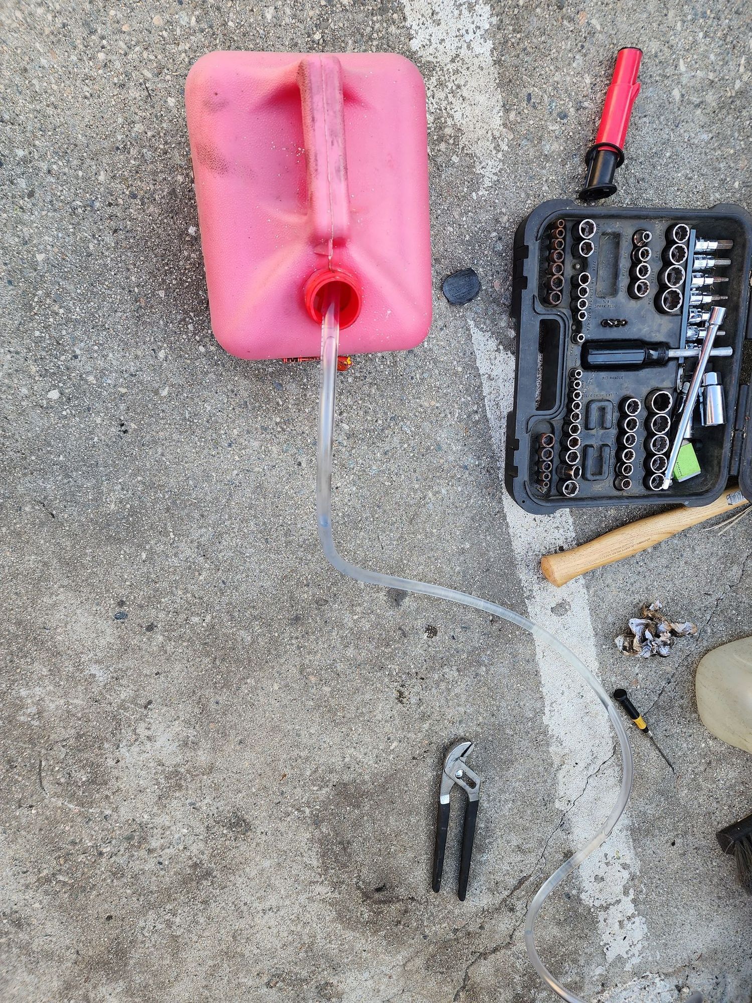

Before you guys clued me into the mechanical fuel pump, i had already put the new fuel filter back on in hopes to get some fuel flowing somehow. Gas into the Quadrajet primary worked and she tried to kick over. The good news is everything else seems to be working! We got air, spark and compression
I'm not sure if i want to rig up the clear tube to the top of the pump to test it, or if i want to just try some clean gas from the bottom of the pump out of my gas can.
New plugs in

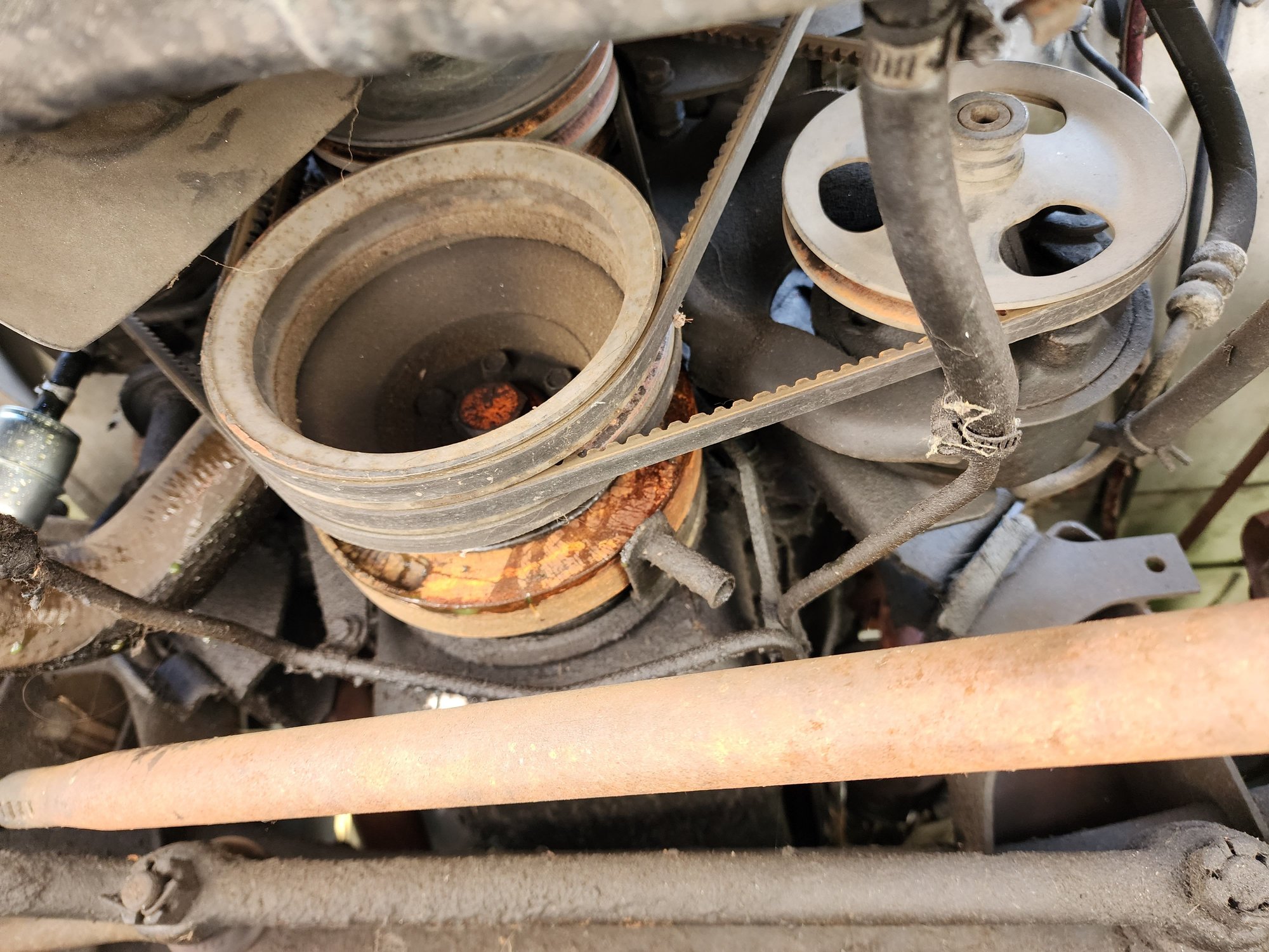

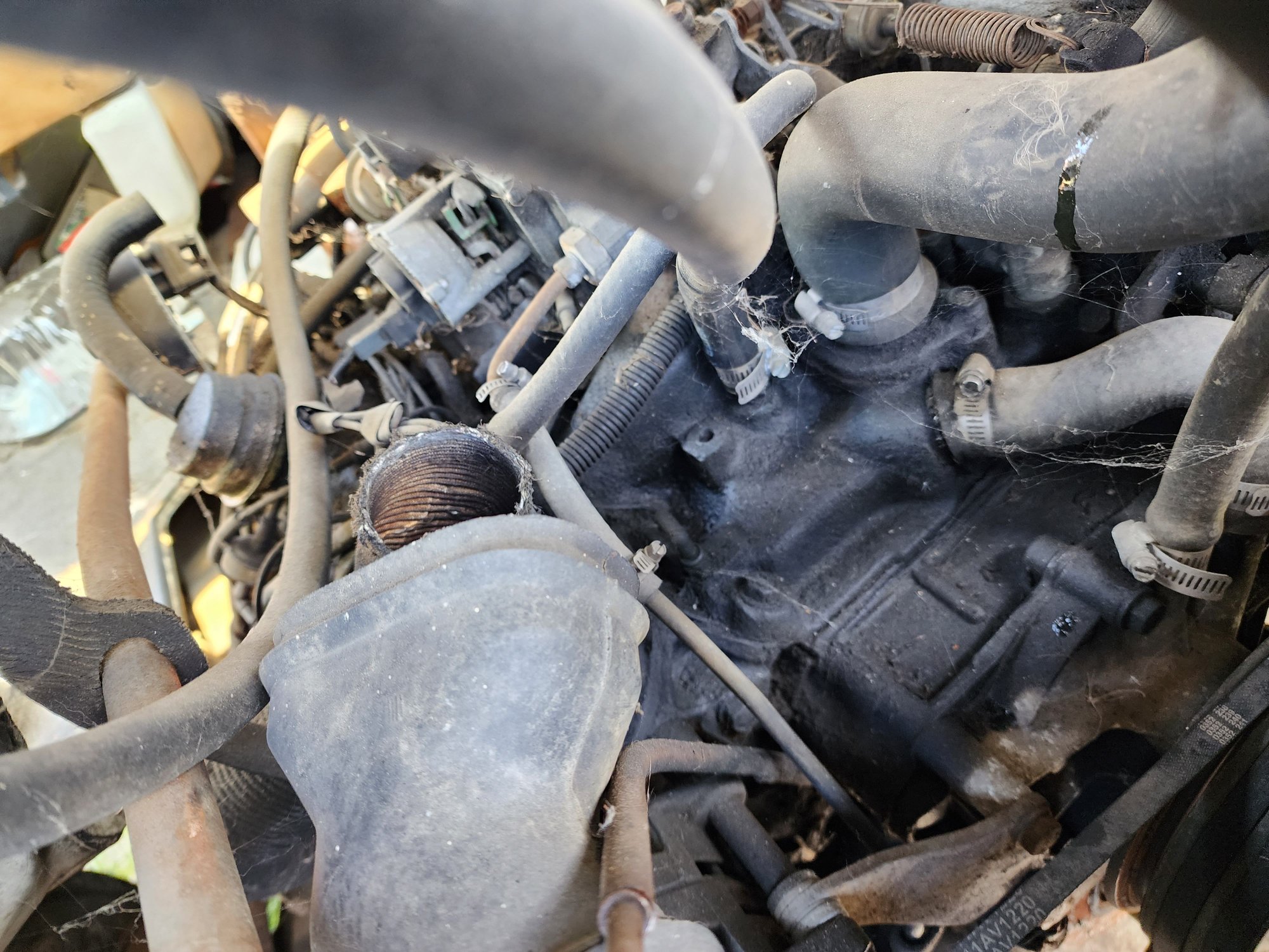

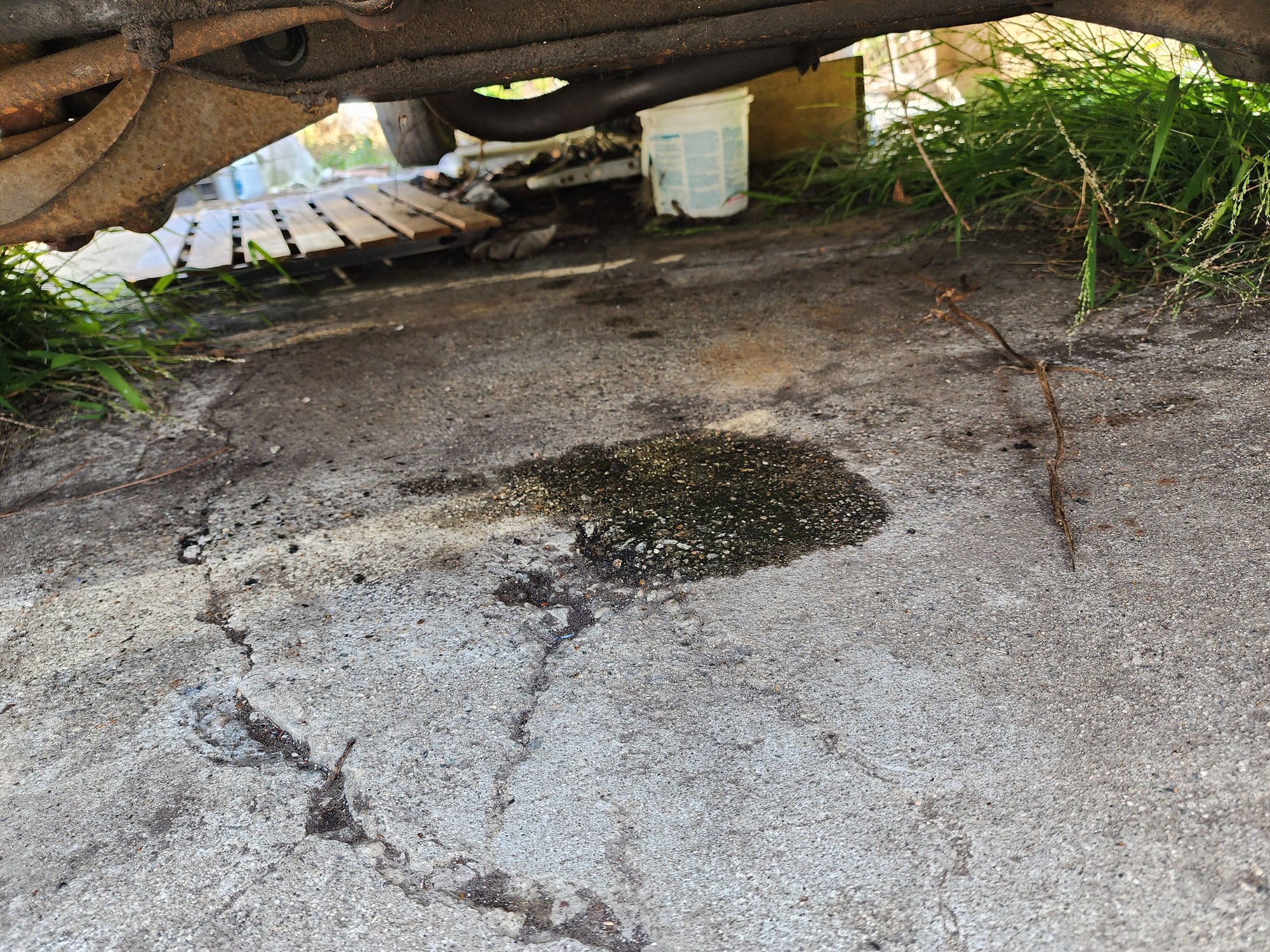

Our first leak, coolant
It's coming from the main, but i suspect its something above it - water pump?

Run a hose from your gas can (with gas in it....) to the input of the fuel pump. Crank the motor. It might actually start.
Yep, drippin' from there, chances are REAL good the water pump is the source.

How many miles on the engine? If you're over 150,000, I'd replace the timing chain set while I was in there. I've seen water pumps that were fine when a vehicle was parked, but coolant was weak, have the seal take a set and when it starts turning, breaks the seal. You can check the timing chain for slop by rotating the engine to TDC. Mark with a sharpie, soap stone, or anything BESIDES a pencil where the rotor is pointing on the distributor. Put a white mark on the balancer. Rotate the crank backwards and see how far it moves before the rotor begins to move.. If it's more than 5 or 10 degrees, you have a lot of slop and need a new chain set.
I like these old things as you don't need a computer to work on them. A vacuum gauge, volt/ohm meter and wooden dowel rod will do most of the diagnosis you need. By the way, the reason for NO pencil to mark the rotor is pencils are graphite and will cause arcing inside the distributor cap.
Spot on! Part of this was my fault because i thought the filter was before the pump, not after.
I plummed up a fresh gallon to the correct side of the fuel pump and it started pulling juice.

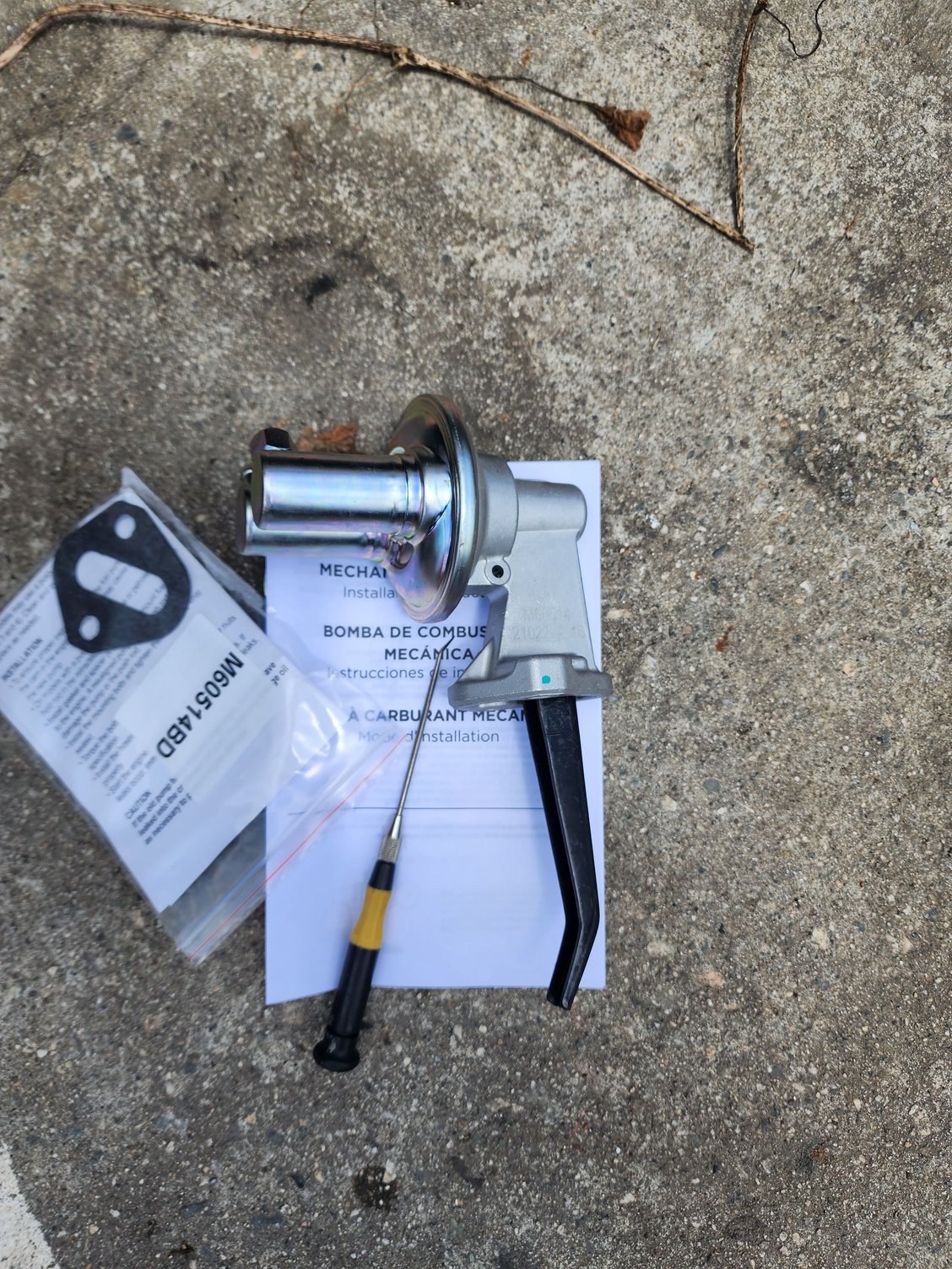

Funny you should ask! After getting her to crank over i tried going through the gears to see if i get engagement from the transmission, but i got nothing. Right then the old fuel pump stopped moving juice, so i picked up a new one to throw in. Brakes seem to work and the booster has fluid. I have time to get her running in the spot its in right now, but once it is running, i'd like to move it to a better spot to continue addressing things. When i did get it running, a lot of the caked on oil started to smoke up - horrible for these B350's as the engine is quite literally in the cabin.

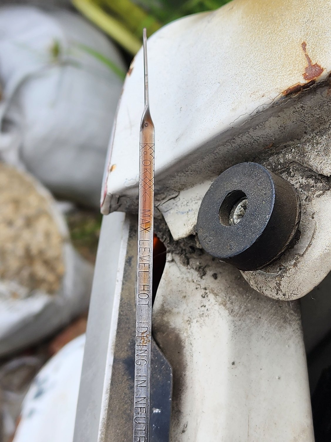

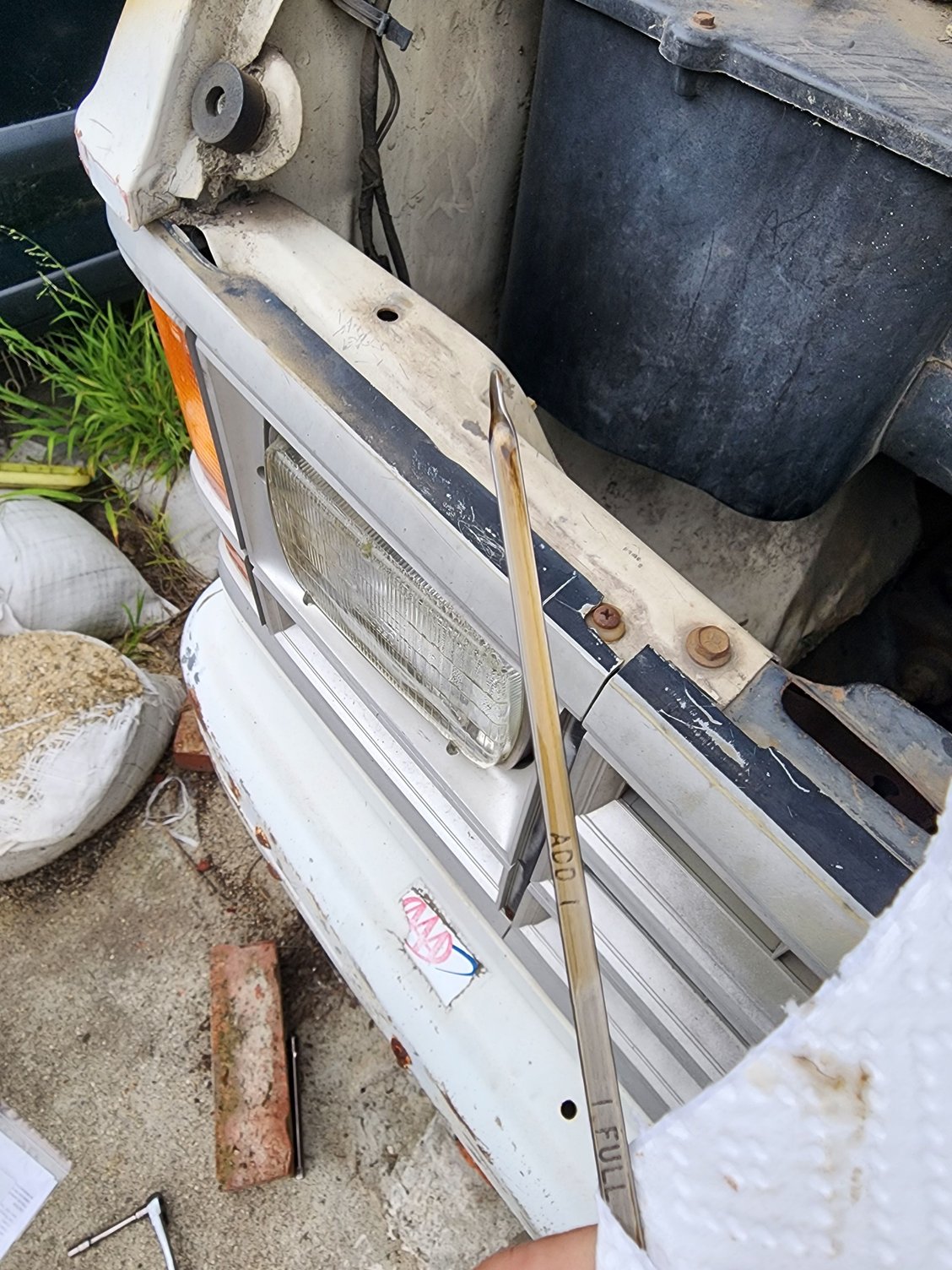

Oil needs a quart (expected as i only put in 5Qt to start)
Trans fluid seems full but the color isnt so great.
Oil level
Trans level

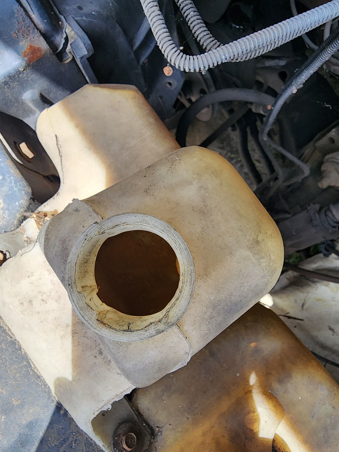

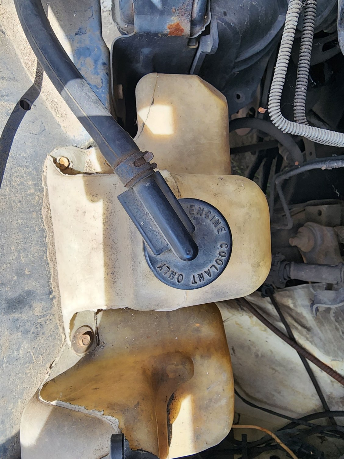

Topped off Radiator

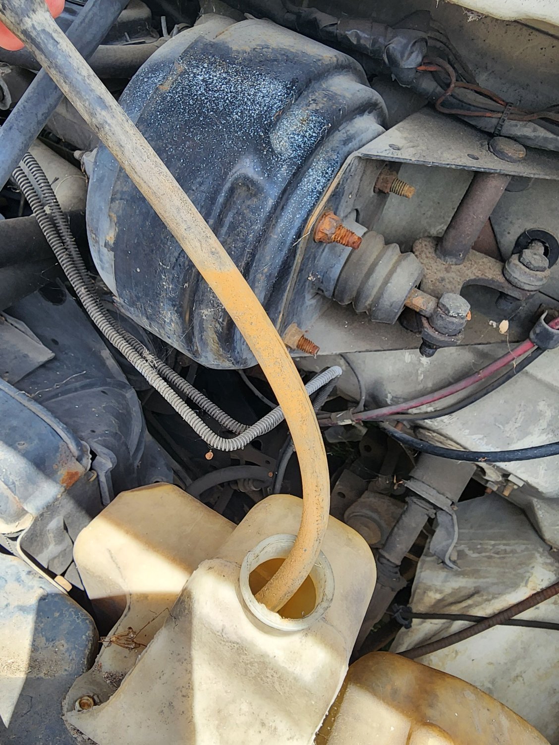

Overflow tank
Overflow pickup
Overflow tank inside

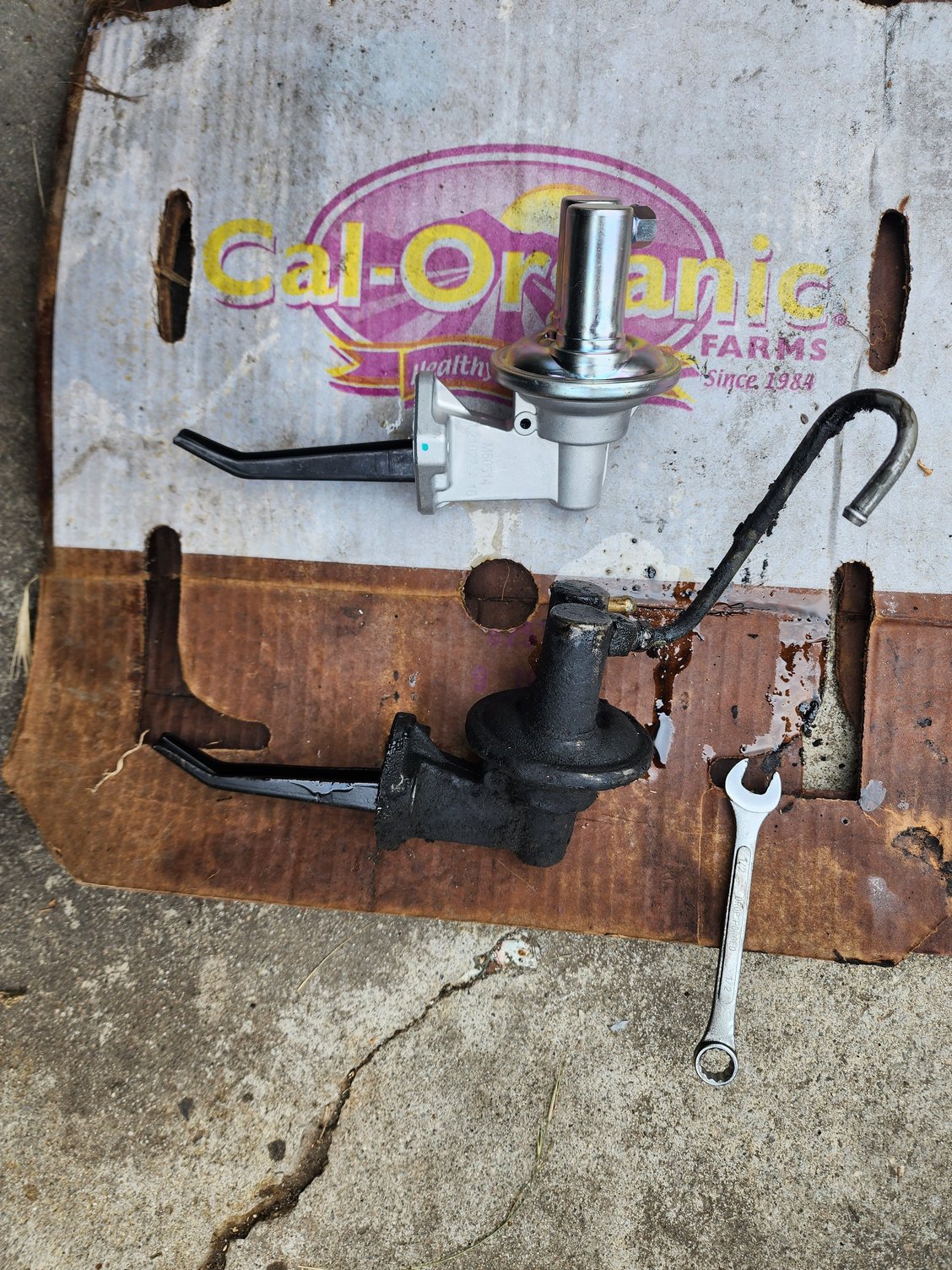

New fuel pump and gasket
Old Fuel Pump next to New Fuel Pump

A rule of them we used at the salvage yard was if an engine was bad, the transmission was probably good. If the engine was good, we'd disconnect eh pressure side of the transmission cooling line and see if it shot fluid out. If not, the trans was bad.
A little tip once you get the engine running reliably. Put the shifter into neutral to the count of 20. The front pump seal can get worn and if the transmission has been sitting, the fluid will drain out of the torque converter. Putting the shifter in neutral will let the front pump fill the converter. This may not help, but try to eliminate one thing.
