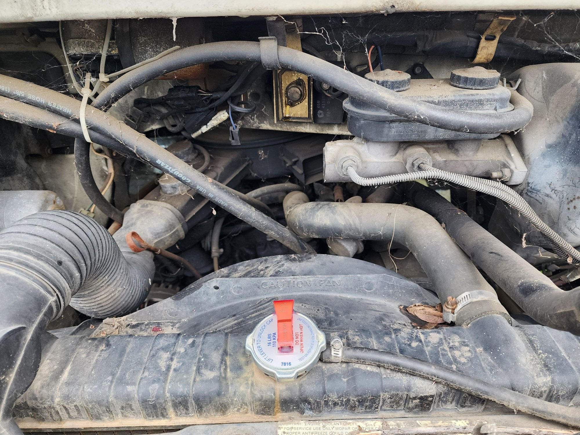

The radiator is bone dry and has signs of tap water usage (rust). I put a whole gallon of coolant in to top it off and i still haven't filled the system, no leaks so far.

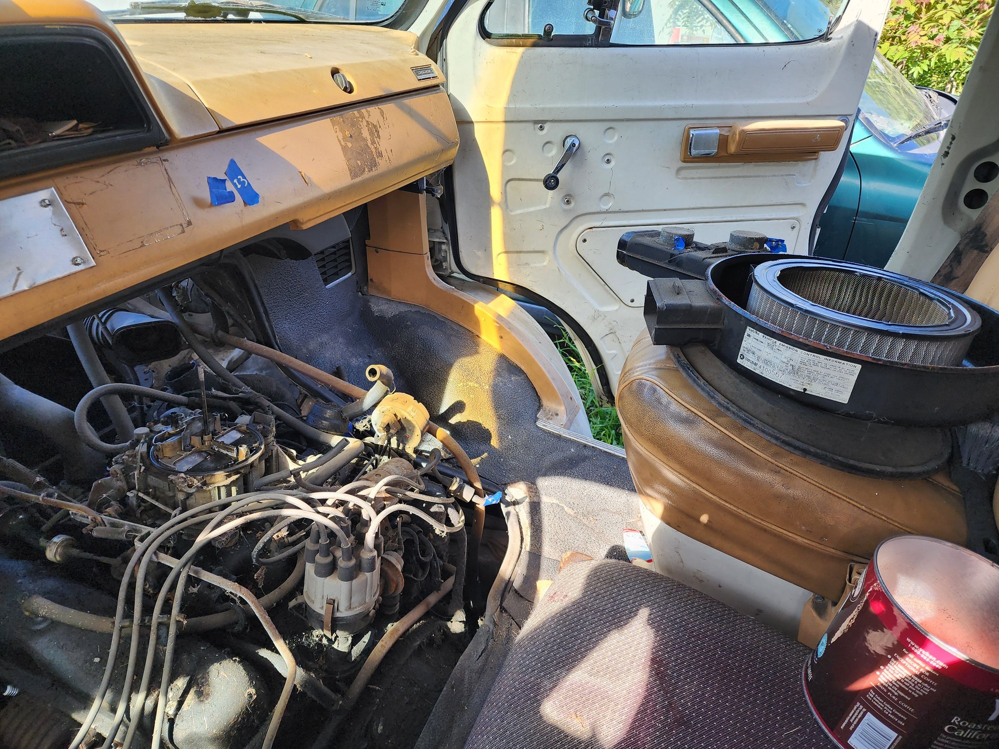

If it's been sitting that long, you are probably going to have to pull the carb, and clean it out.....

I'm going to see if the quadrajet will fire up just enough to move it from the spot so we can really work on it.

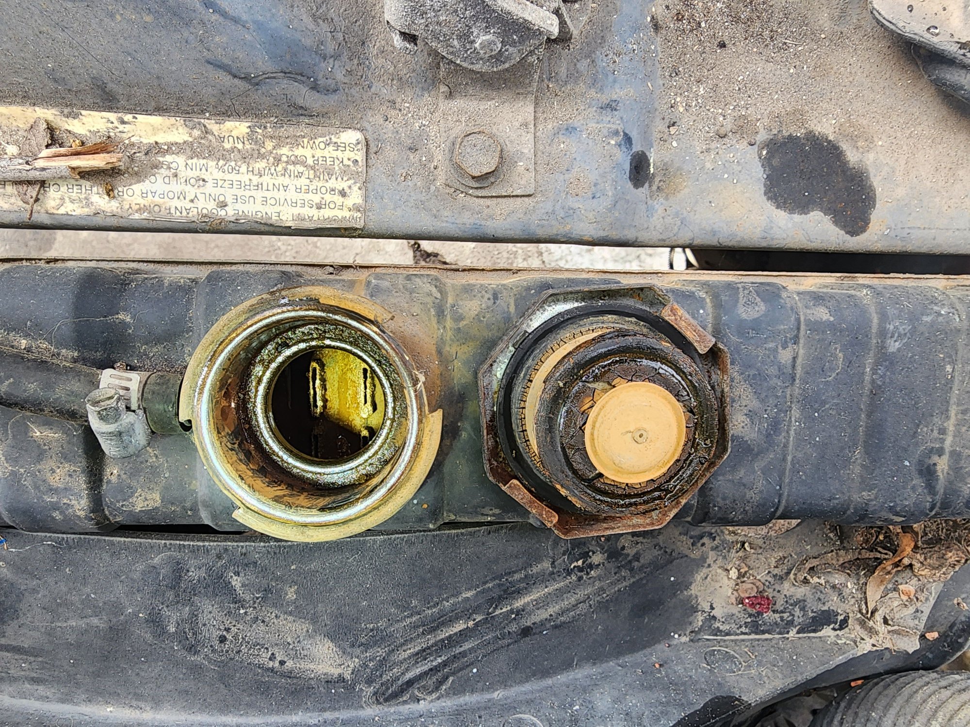

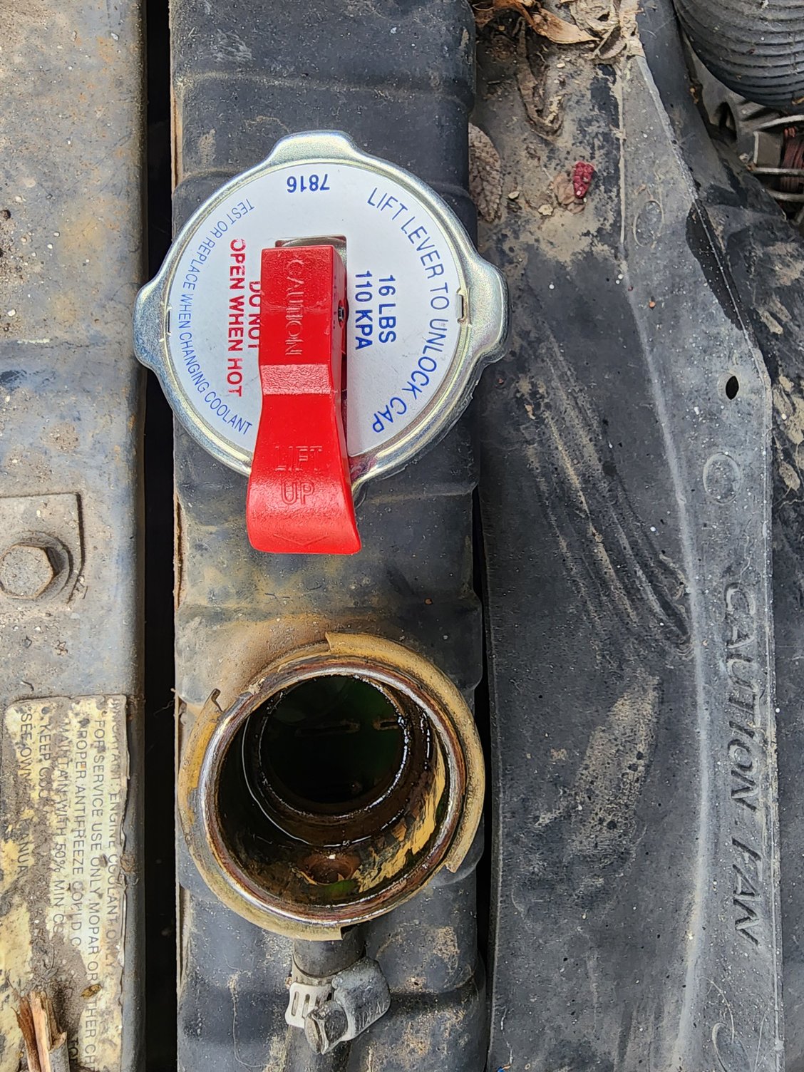

I should have emptied the radiator to verify, but im 99% this system was bone dry:
Dry radiator, dry cap
New cap and topped rad just under the overflow so we can burp it
The shiniest penny in the pond

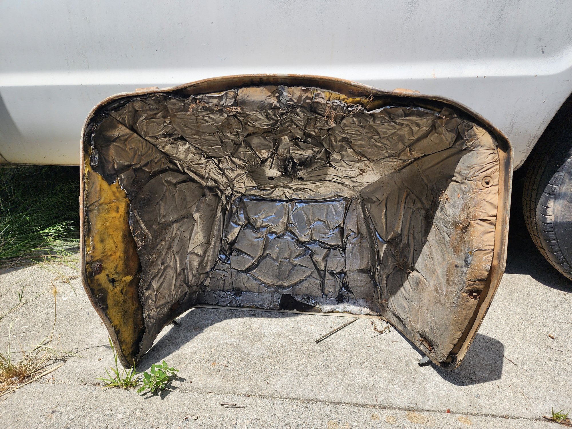

Dog house
Air Intake Off / Cabin
Air Intake Off

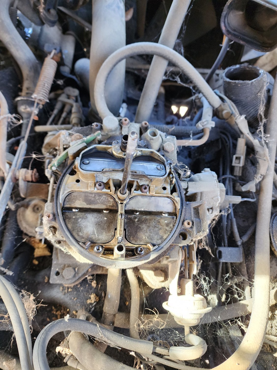

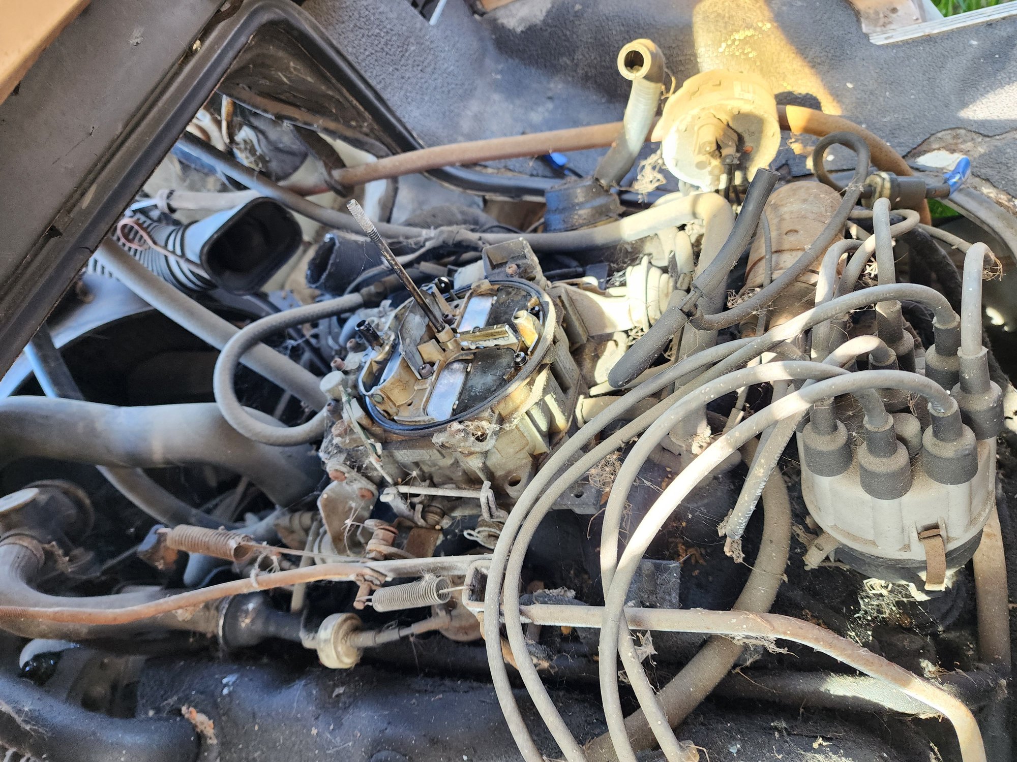

Our first look at the Carb - Quadrajet

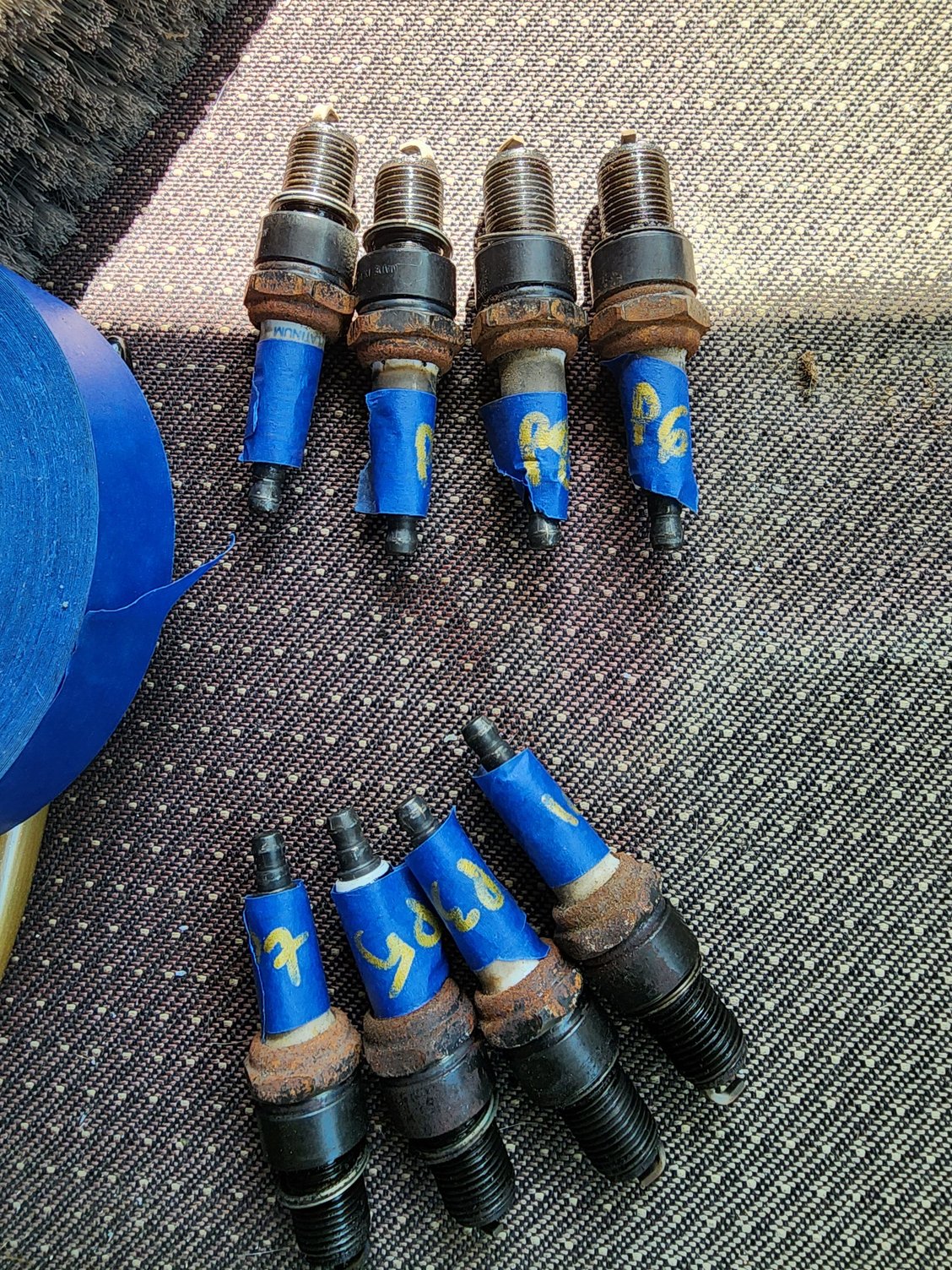

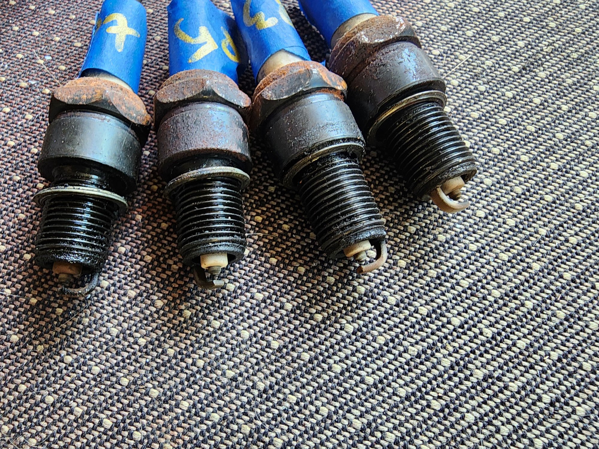

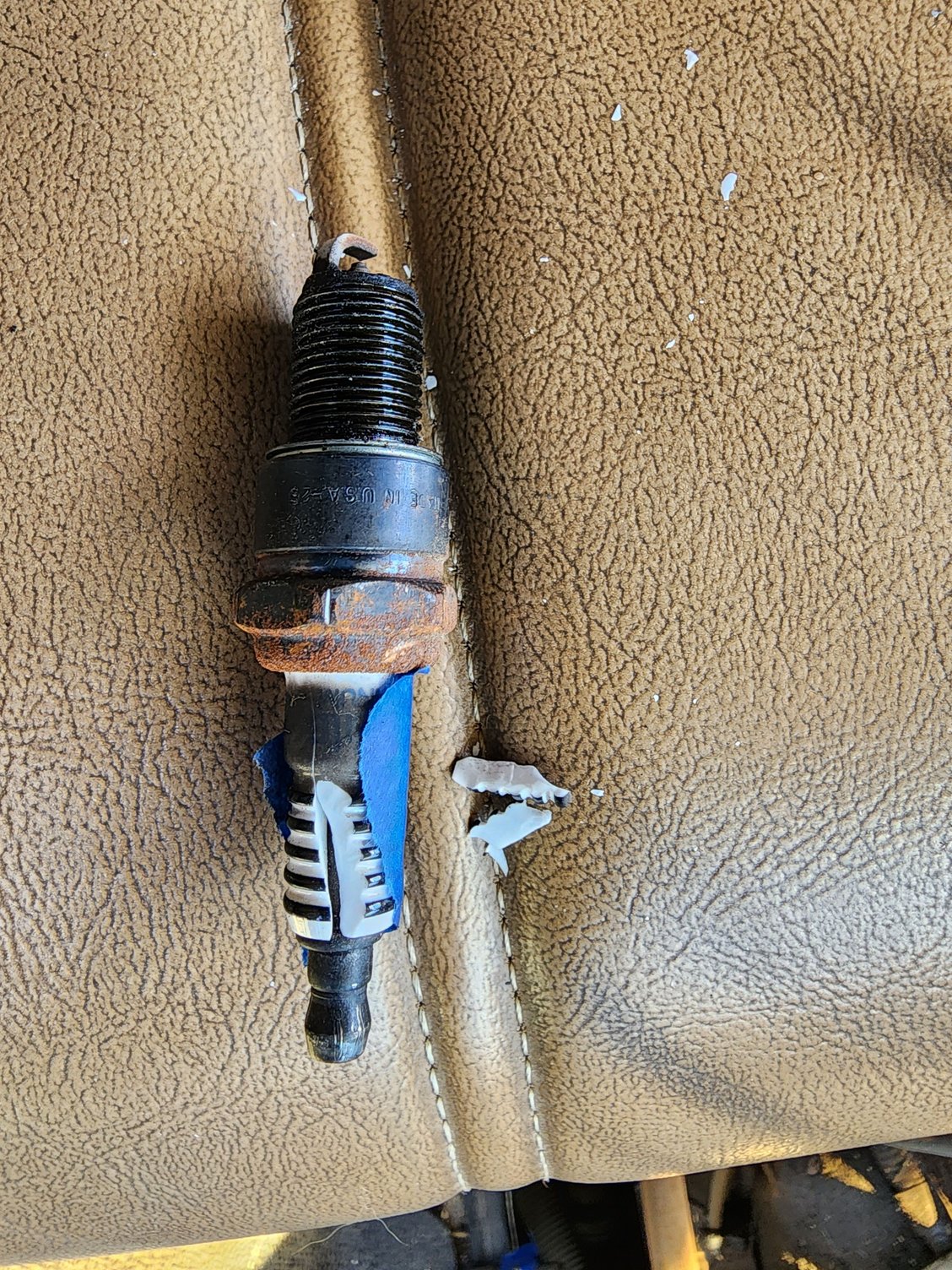

Plugs pulled for inspection and so we can fog the cylinders before test fire
Definitely used but i bet they work
Nevermind

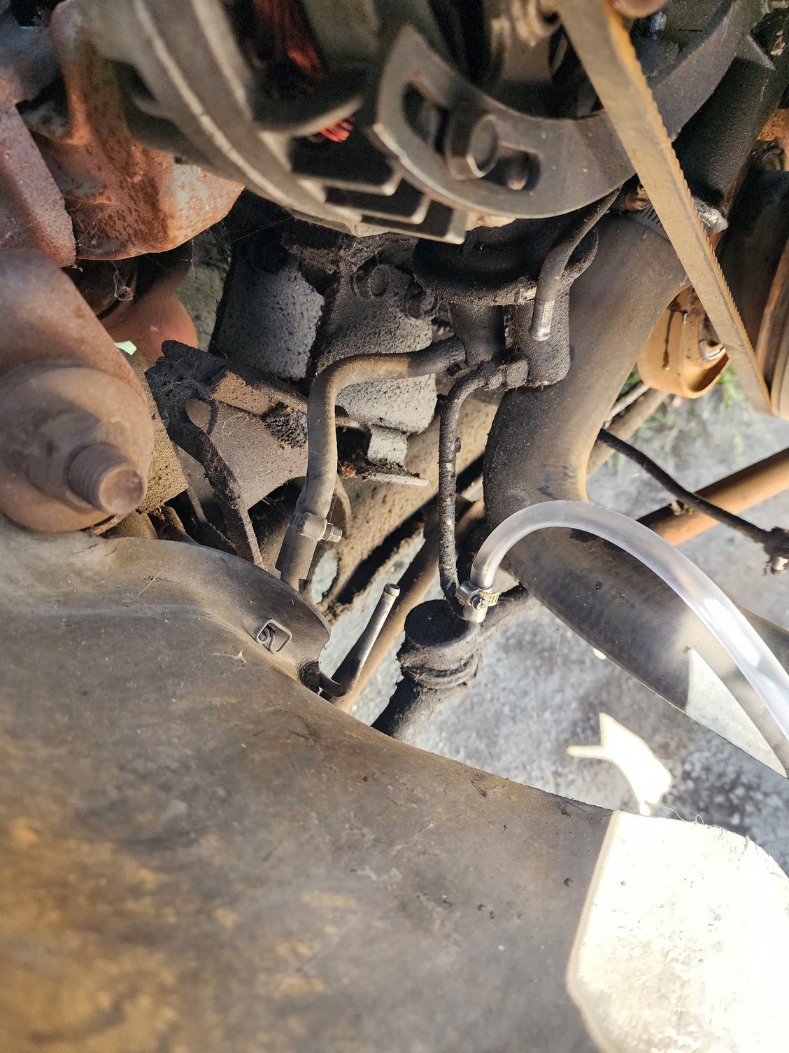

Old fuel filter off, i'm going to have to re-use the return hose here
Clear tube on line coming from fuel tank
After test cranking the engine, we still get no fuel through the line

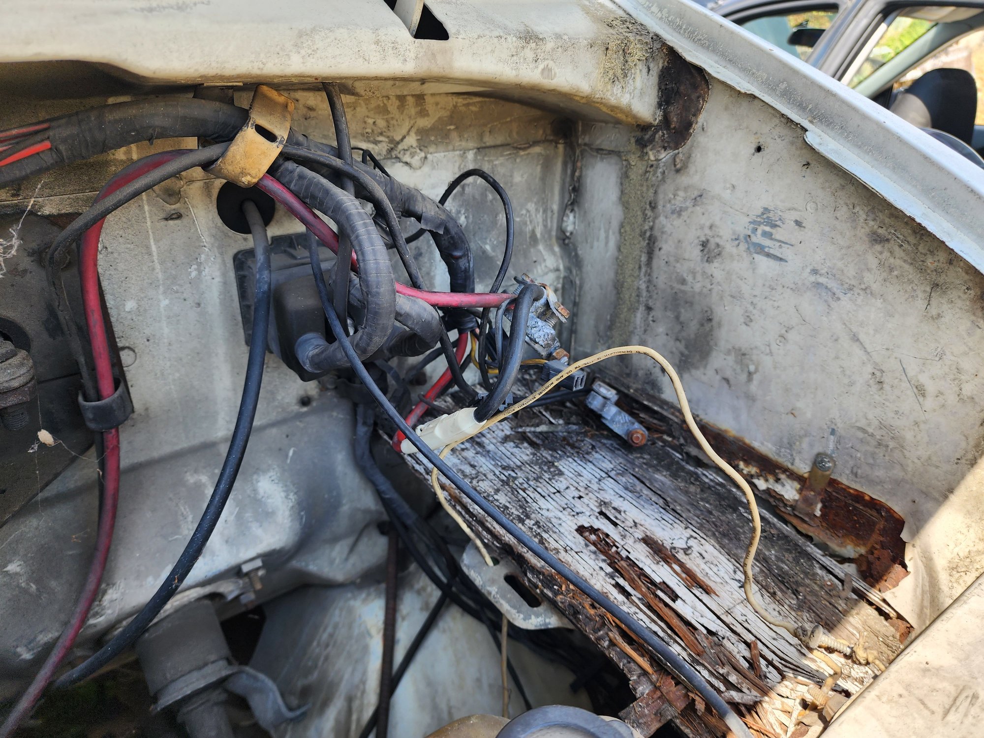

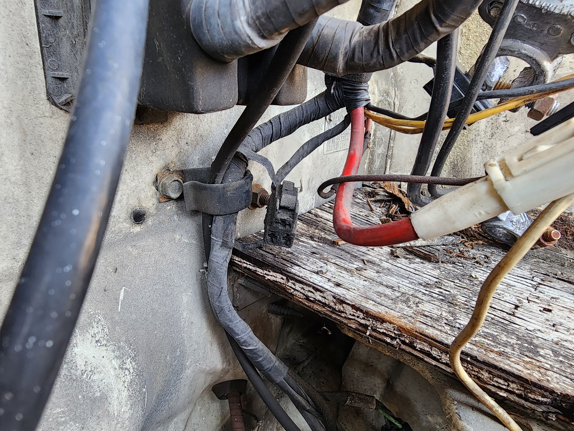

The Fuel Relay should be just under the firewall termination, or just under the brake booster - I cannot find it.
Some questionable unplugged connections behind the battery 1/2
Some questionable unplugged connections behind the battery 2/2
Old May 7, 2023 | 09:08 PM
Posts: 87,465
Likes: 4,220
No electric fuel pump on that one. It's a mechanical pump. You have a pic of it. Need to put your clear hose on the output of that pump.
If the tank was truly empty, one gallon simply may not be enough to submerge the pickup... thus, no gas at the pump.
Plugs look ok. The 3rd one though, looks like it has something stuck under the side electrode????
Hey, don't confuse the guy! The clear hose is attached to the output of the pump in his picture (5th from last.)
I wasn't wearing my glasses........
Wonder if the pump diaphragm is toast due to age and gasohol......
Very likely. My goal is to get this van to move from the spot so we can get some actual work done. The cooling and fuel system need immediate addressing.
I'm assuming the fuel pump on the block requires a gasket, so i wont pull it to peek inside just yet. I just need her to move!
