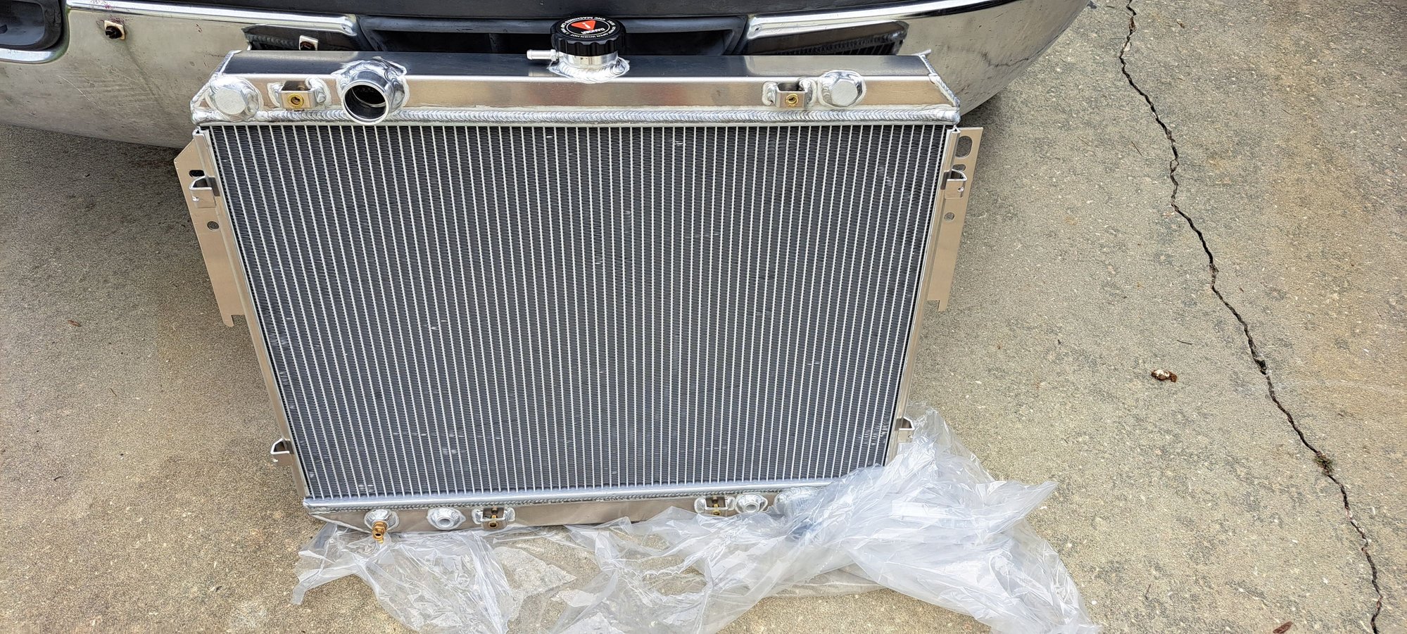

OK...this job was one of those that just didnt go right at all...it took me 7 hours to R and R the radiator...
So I got the 3 row ebay special. I called Radiator.com and another place and they only have the stock radiator...they dont have or cannot get the performance or copper ones anymore.
Now, the ebay special seemed OK and it went right in..but...I should have checked everything. The mount holes for the shroud were not tapped! There was just a hole there and it was small...M4 small...so I ended up going to the hardware store three times trying to find the right bolts for it...nothing worked. I ended up settling for self tapping stainless bolts. I used them and they worked well. That debacle added 3 hours to the job...then I actually had TWO 10MM sockets break or round out inside the socket...WTF...Im glad I had a thrid..but wow..never had that happen...I have to add I put in and took out the radiator three times...the first time I though I was ready,,,but no. the shroud didnt fit...then I had to take it out to see if I could actually match up a bolt for the shroud...then another F up thing happened...I had a bolt break while putting it in the core support...awesome huh? So out comes the radiator again along with the grille and I had to almost liquify the bolt with a torch and it finally came out with vise grips. F and A! Then I had to retap the hole..fun...Then somehow, I broke my oil cap while putting it in, so I will be getting another one of those tomorrow..along the way, I dropped bolts, tools and pretty much everything else I had in my hand during the job..a couple of time I wasted 30 mins looking for my socket...geeee..I suck and this job bit LOL...to top it off I ate some tranny fluid because when I moved the hose while I was on my back under the van, it decided to flow out all into my mouth...
I finally got it all in and done...It got dark so I still need to put the coolant in...that will be done tomorrow morning...but wow...1 hour job turned into 7
Pic of radiator...as you can see - there really are small holes for the shroud...

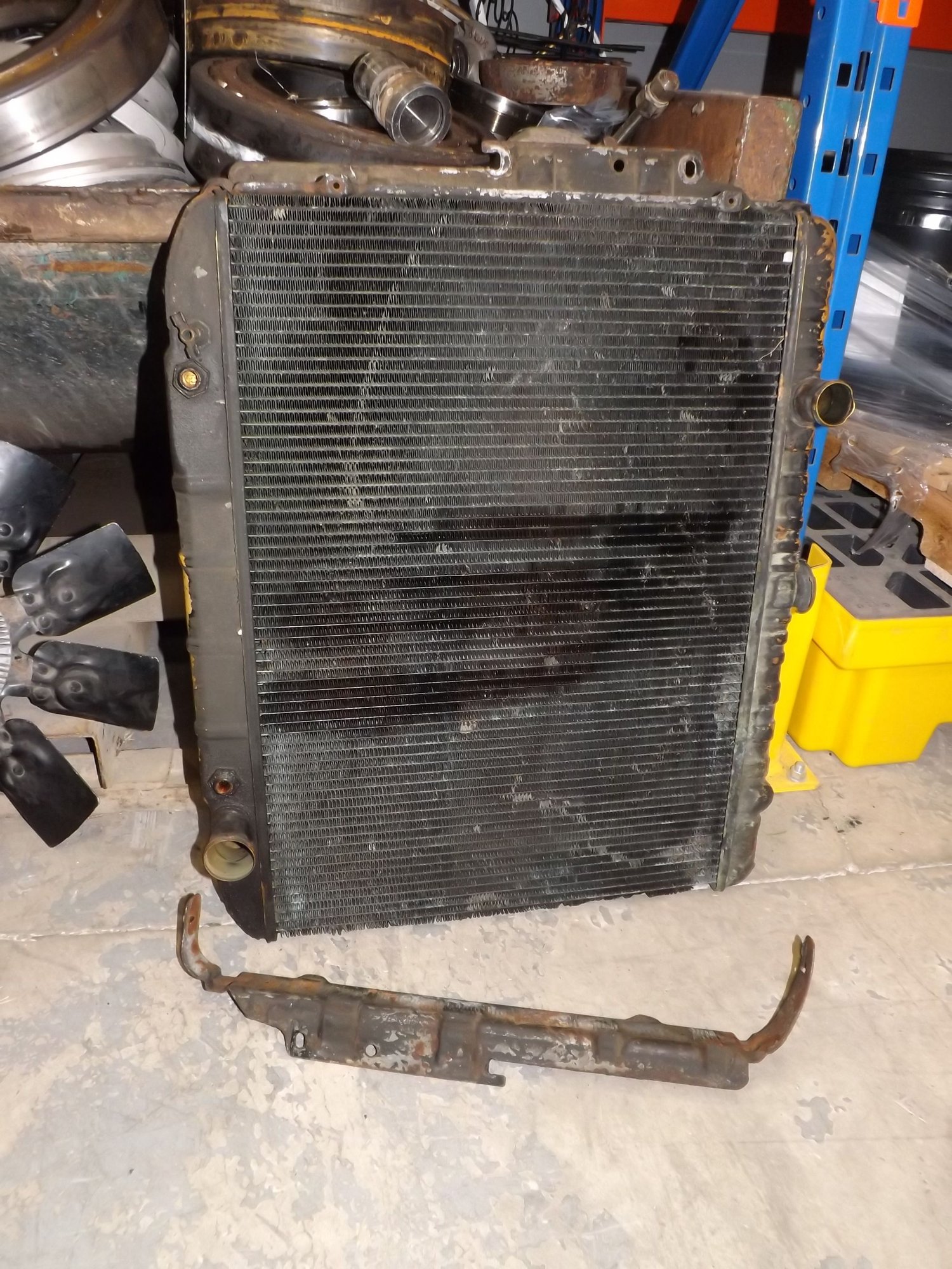

Hey, here's another thought;
Last time I looked, my 25-year-old rad was still on top of the scrap-metal skip at work. It was not leaking when pulled, and to my knowledge it had never done so, although there are a few suspicious old stains. I will be working tomorrow (Saturday) and I can set it aside for a few days. The side mounting bracket on the passenger side came off at some point during the changeover, but it looks like it just clips on. (???) Pics attached. Most of the damage looks pretty old, other than that coused during removal.
No charge for the scrap metal, but you would have to pay the shipping from here (Toronto, Canada), by your choice of prepaid carrier. I can provide packaged weight and dimensions, but it might cost more than it was worth??? Cheaper than a brand-new one for sure, anyway.

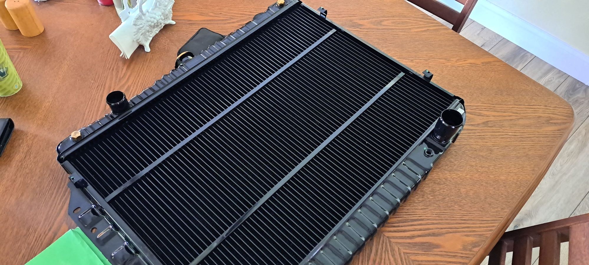

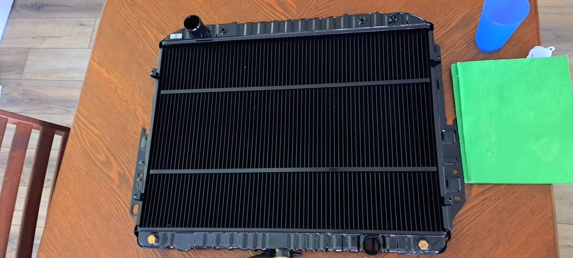

Got the new CSF in and it works well. It is a nice part and NOT junk. It really is an old school brass type.
It is not much heavier than the aluminum I replaced it with...

That is a radiator everyone should use It fit perfectly, isnt flimsy, and dissipates the heat very well... I am really happy with it. I also want to note that the fan clutch doesnt operate properly with the 3 row radiator. This one, the fan works perfectly.
