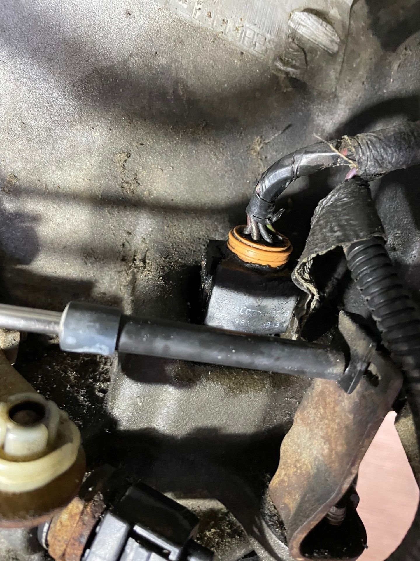

1999 Dodge 3500 Van. Transmission fluid is leaking from the connector on the rear of the transmission, driver's side, just above the pan. The service manual calls this a "Solenoid Case Connector," but gives no further information, other than the o-rings might need replacing, but not procedure for that.
Looks like the connector itself is broken. Note: it's the top one in the picture.
How do I replace this connector, and where do I find one?

It plugs into a socket for the internal harness for the trans. They are out there to be found, but, I think they are actually part of the wiring harness for the TCC/overdrive solenoids..... Any parts outlet should be able to get what you need.

Thanks. By parts outlet, do you mean a parts store like AutoZone, or a used parts outlet like CarParts.com?

Parts store. You want new there.
