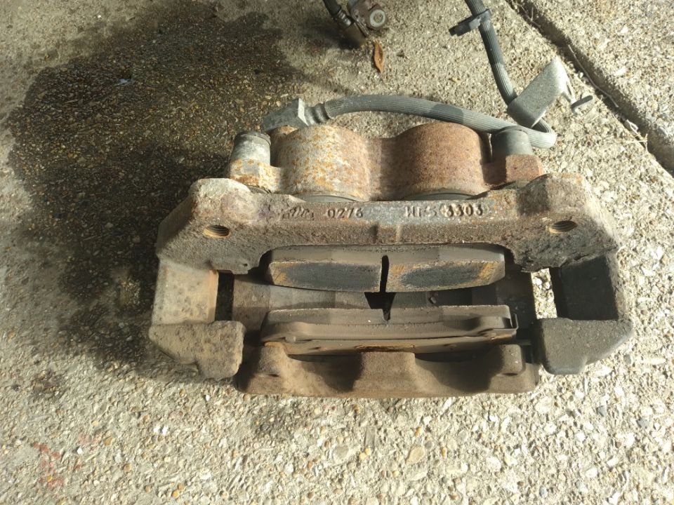

I've got a full set of the one man bleeders. None have ever had the proper threads to go into calipers or wheel cylinders. I've got an Expedition waiting on a pair of rotors and I'll be doing the looped hose technique on it. I'm hoping the rear bleed valves don't snap off as I've found when they do that, it's time for a rebuild. One caliper up front was seized and made braking.....interesting.
Occasionally, it would grab and not let go. Mostly, it did nothing. That's how rust builds up on the pads.
