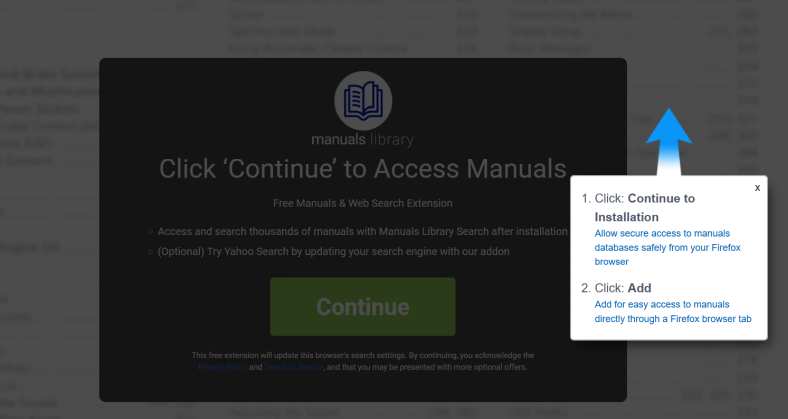

It's telling me (by voice) "almost done, just click on the continue button", but clicking on that does nothing but bring the same voice instruction again.
Erm, I have never seen that before. There is nothing to install..... Are you running an ad-blocker by any chance? If you aren't, I think you should be....
And you get that when you click on the link???
