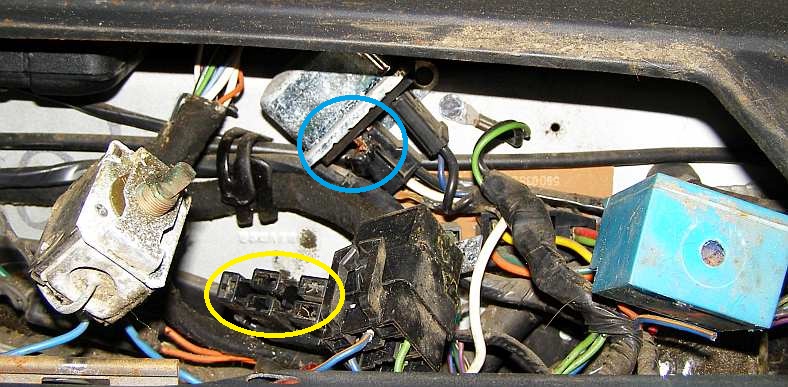

Of interest, possibly important...
Under glovebox. Is one of these the blinker canister? Of note here is the item circled in blue, I had the ignition on while looking in here and this thing was heating up. Then I noticed that it had heated up enough at some time to melt plastic on the fitting attached.
And there's what appears to be a rheostat control there, and circled in yellow is a fitting with three wires to it which doesn't connect to anything.
