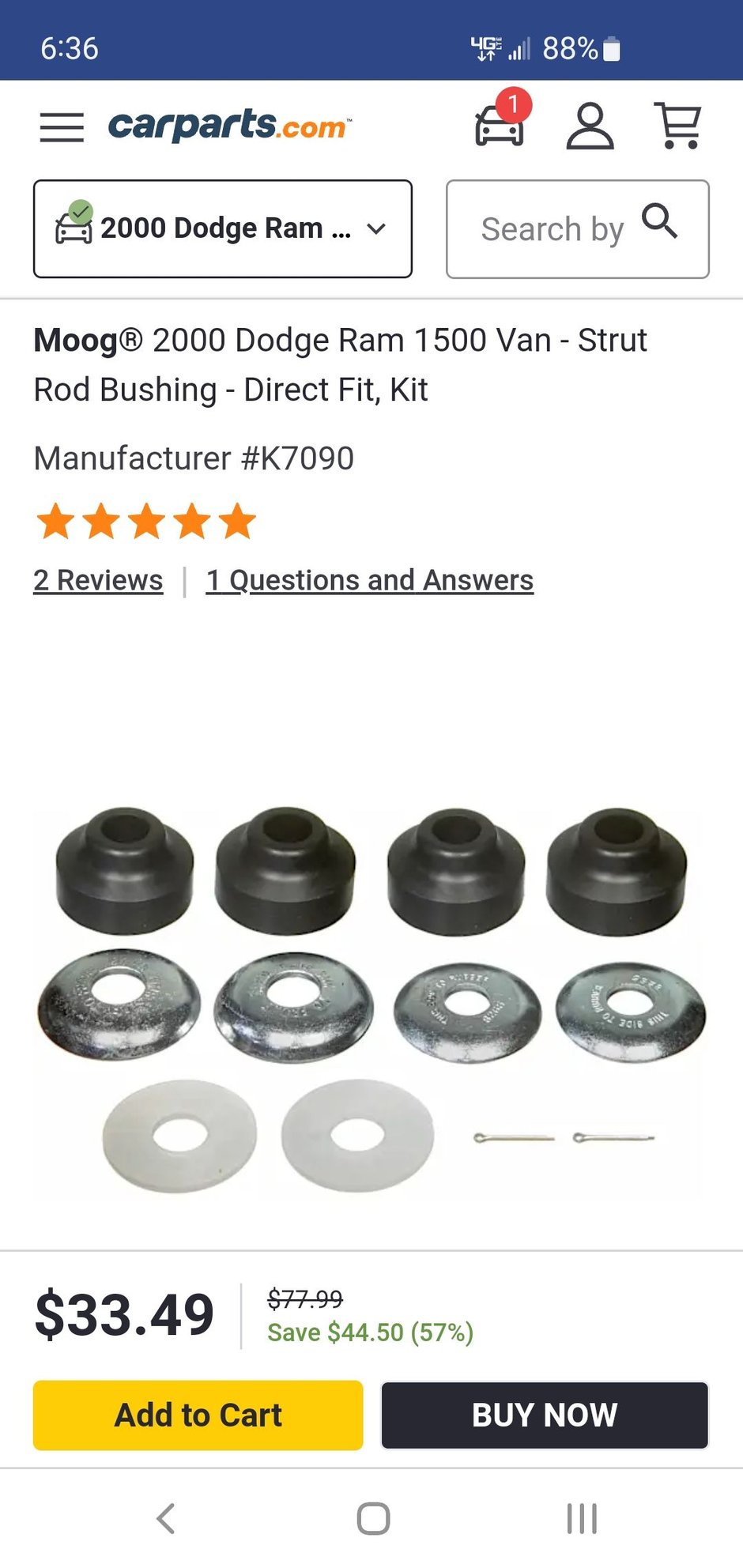

Did you look at the radius arm bushings?

Hi ElkCon - my van's also an Elk conversion! Even took it through Elkhart, IN to let it connect with it's old roots .
Are these what we're talking about? Moog calls them Strut Rod Bushings. If so, yes, I did replace these with the Moogs. But worth noting that both of the strut rods that they mount on were badly worn where they come in contact with the bracket at these bushings. The right side rod and bracket were repaired by a professional welder and went back together beautifully. The left side we didn't have time to fix, but was less severely worn. Photo of the left-side rod attached.
Again, bushings, spacers and metal plates are new. But would this kind of wear to the rod cause a right-side steering pull? I'm pretty sure the issue existed before I replaced the bushings and repaired the right-side rod, although back then so much was wrong that I might not have noticed.

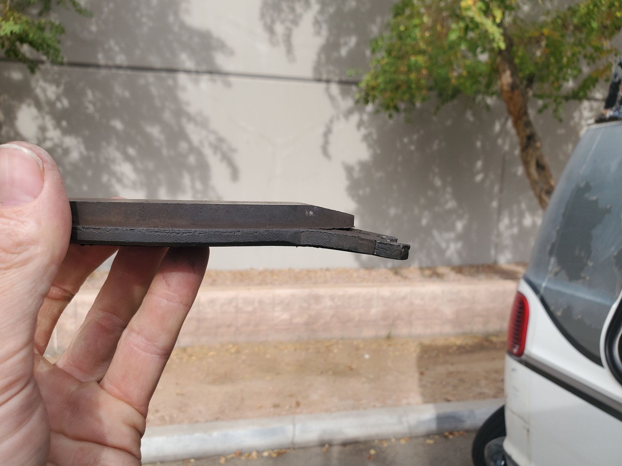

Left-Side Brake Pads - one of the pads on the driver's side (aka away from the steering pull), somehow got bent. It was the inner pad, and the metal plate was bent back away from the stopping material. And the stopping material had split across the middle. My guess is something wasn't sliding correctly on that side, so pressure from the pistons bent the plate and cracked the pad. Replaced both pads and they seem to be sliding / floating correctly. Steering still pulls to the right.

Photos of weird bent pad vvvv

The bent pad is a sign of a caliper that is not sliding correctly. This happens to the inner pad because the piston in the caliper pushes the pad, yet the opposite side does not pull in, so the inner pad bends to close the gap to the rotor.
