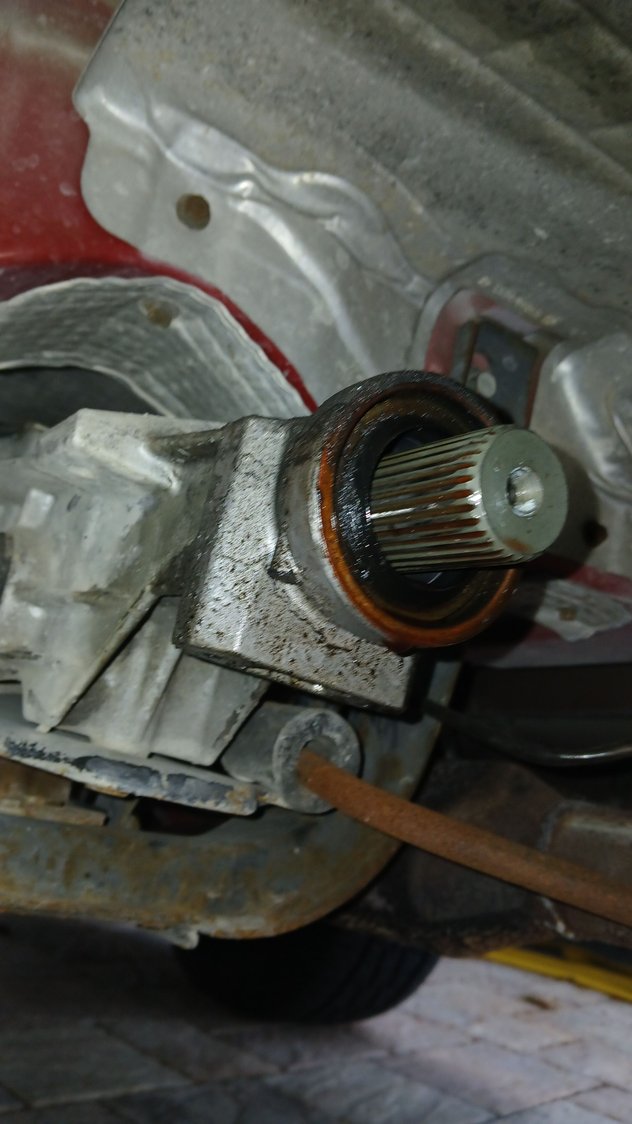

Im a little confused What do I have going on here? The seal I have looks nothing like this? thanks

There's a couple different designs used over the years, that's one of 'em, another has a longer 'cup' on it, that sticks out further, they both do the same job though.

It was kind of a pain in the a$$. to get out. It was pressed in tight. It had been in there for years and interestingly, the old seal's metal press ring was twice as long as the one I put on...it was almost an inch wide...
I had a seal removal tool and it didnt budge it. I had to use a small screwdriver all the way around the ring, then a larger one all the way around...and within all that action I used a small hammer tapping the screwdriver in between the case and ring. After about 40 minutes, it finally came out.
A 2in PVC cap works pretty much perfectly to tap the new on back in...
My trans oil needs to be change...it is dark red...no smells of being burnt - it is just OLD...the trans works fine...I am always skeptical about trans fluid changes - but I do have access to the machine...I should do it - right?
Here is what it looks like...
