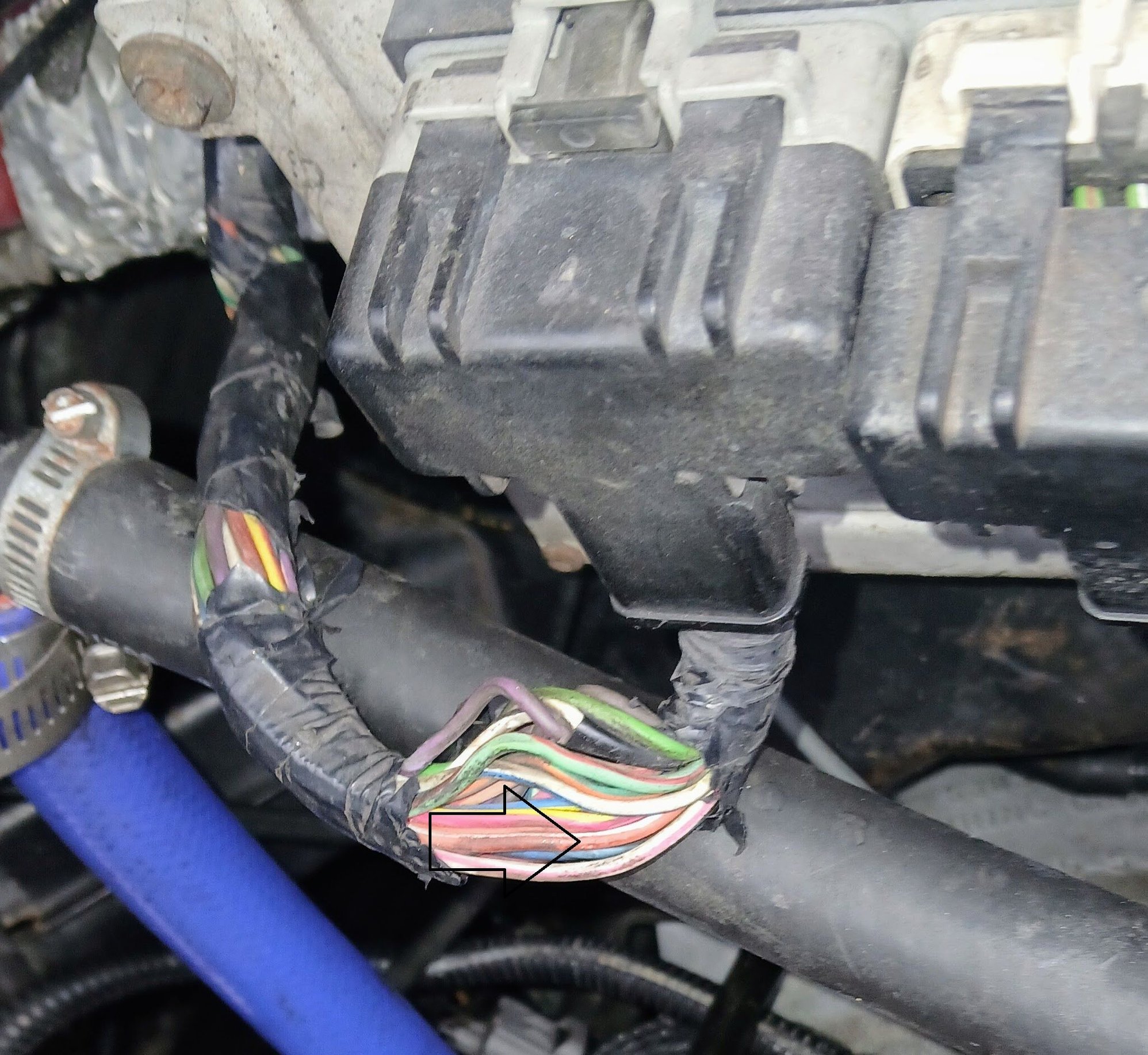

Does this look like the right wire?

Diagram says orange/white.... So, "probably".

sorry - here is the pic I was referencing

Wire should go to connector "C", cavity 13...... The resource I have doesn't show me which is which though.
Old Mar 30, 2025 | 10:55 AM
ElkCon's Avatar
ElkCon
Joined: Jul 2019
Posts: 574
Likes: 48
From: Florida
C on the PCM?
I think I am going to just try to ground it and see if the light comes on
