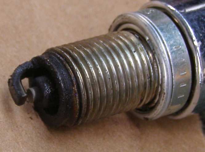

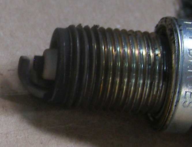

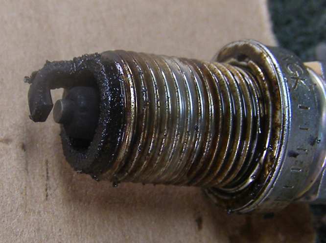

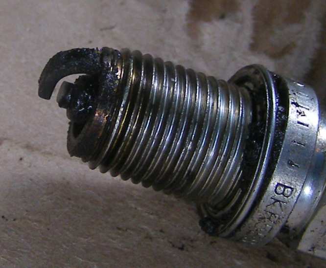

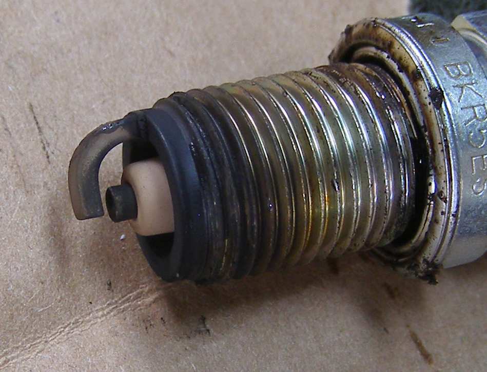

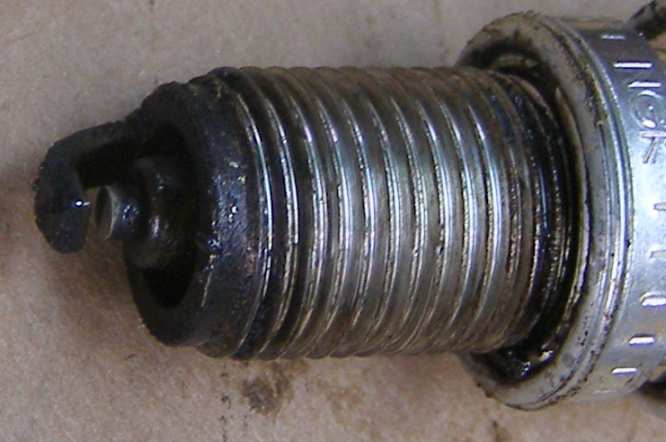

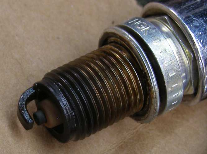

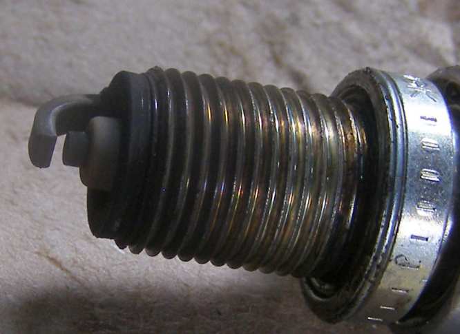

Do the plugs tell us anything?
All in the order they were fitted in the engine:

Not all cylinders running the same(bad). #1 is real bad. What is the condition of the cap/rotor and wires? Might want to do a compression check on all cylinders.

Basically it's the centre cylinders which are burning clean, front and rear looking oily...
Cap looks new, leads okay, but the right bank plugs have a sleeve around them, (No 4) appeared to have been rubbing fairly well on the stainless steel pipe (exhaust related) that runs close to the leads up that side. The sleeves look like they're fibreglass inside foil and are about 6" long, presumably to protect the leads from manifold heat.
Could it be very poor mixture distribution?
Old Jun 15, 2025 | 12:08 PM
Posts: 87,479
Port fuel injection, so, if it's a distribution problem, it is gonna be due to dirty/failing injectors.....
Fair bit of oil on some of those plugs as well, valve seals??
