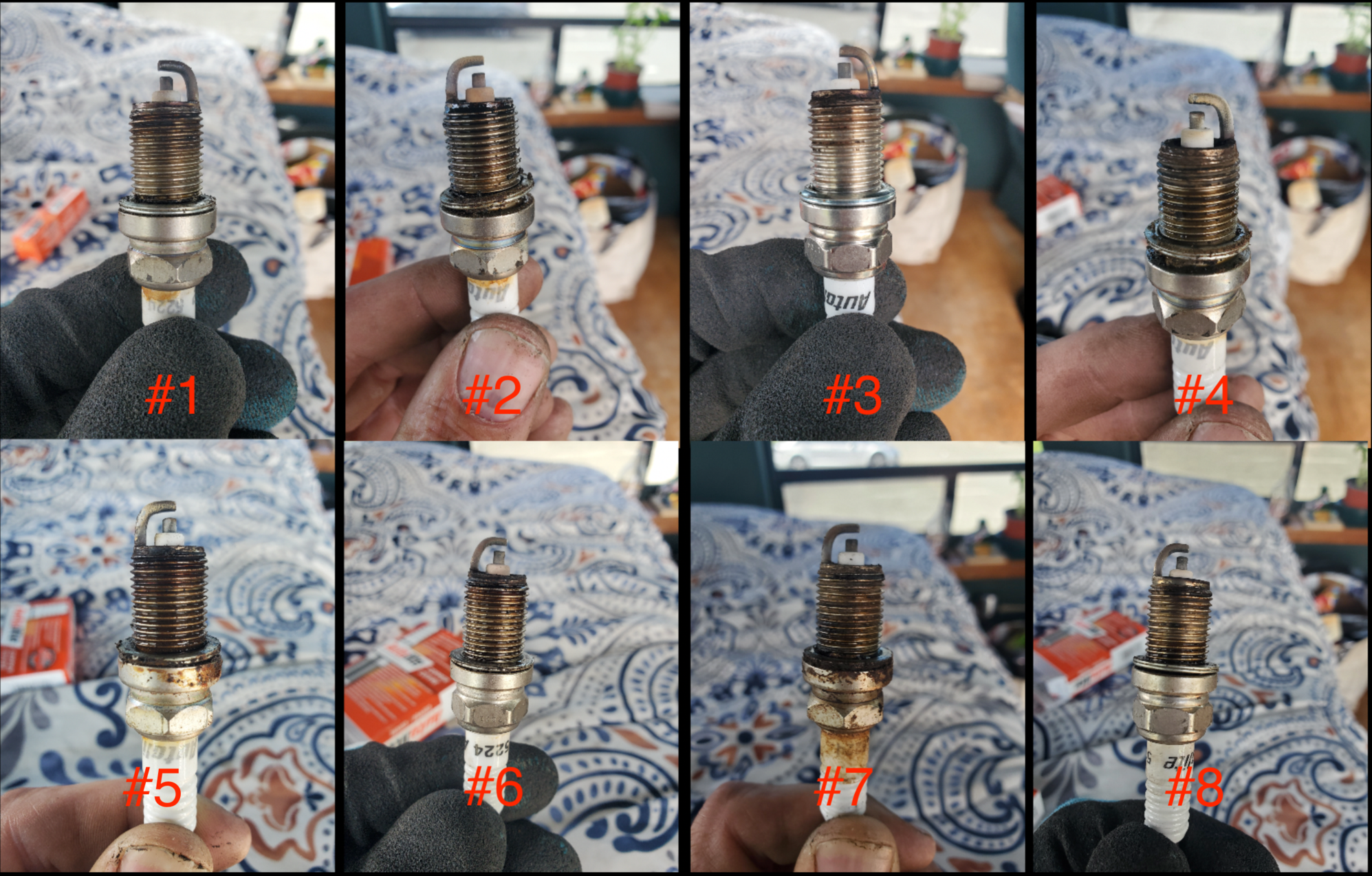

If you're invested enough to have read this far, I guess I might as well attach some pics of the old spark plugs that came out. They looked fine to me, but I'm not great at reading plugs. Replaced with new Autolites regardless.

The old plugs don't look like they have been in there that long.... I see some with rounded center electrodes, and some are whiter than what I would like...... Do you have a scanner? See if you can read misfire counters, and what the numbers look like.
yea they arent that bad - he does have a valve cover leak

@HeyYou - Indeed you are correct. The old plugs had not been in there very long at all. Do white electrodes mean lean condition? It hasn't thrown a misfire error recently, but I'll see what my scanner app can show me. Could misfire cause the shudder symptoms described??
Yeah, white like that is lean. And misfires can most certainly cause that shuddering you feel. See if your scanner will read misfire counters......

I put my glasses on - on the skirt of the plug - is that rust?
it looked like oil...so if you have oil there, it came from somewhere
