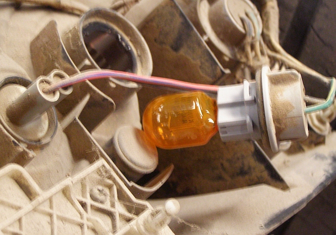

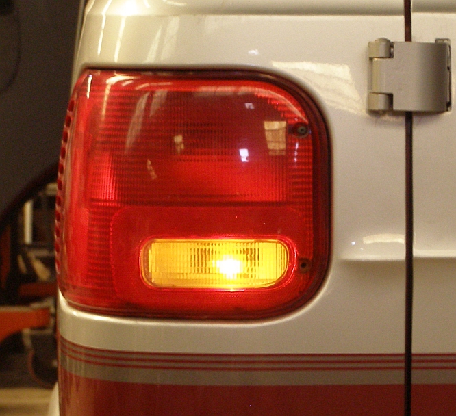

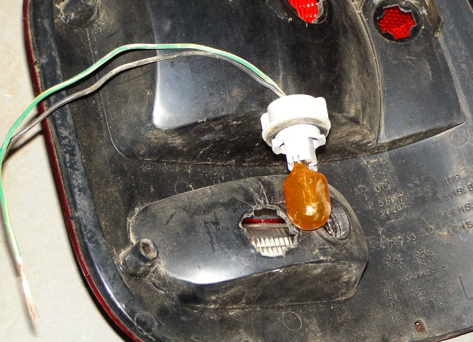

Starting with the turn signals at the rear, I sourced an amber globe and its fitting from a damaged Subaru Forester tail light assembly...
...and then duplicated the hole into which it fitted beside the globe for the reversing light...
...and so I had my amber turn signals at the rear.

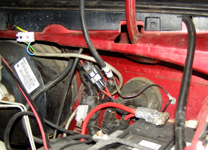

Then I had to get the power for them from the front of the van as they would only ever work properly if they were divorced from the brake light wire. Taking the power from the turn signal wires at the front, I ran a bit of a loom across the top of the engine bay, actually tucking it in under the plastic cover over the plenum, with a wire joiner to take the power from there via a piece of 3-core wiring through the various nooks and crannies of the van to get it to the back.

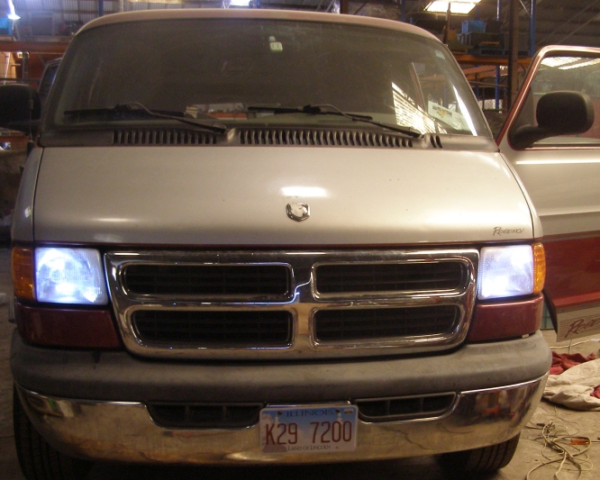

But while working at the front end I also did some work with the parking lights, another bit of Subaru fitting was plucked from my pile of spares and the headlight worked to enable it to show as the parking lights: Again, some judicious drilling (step drill used) and filing to get the shape...
...but only after sanding to get a smooth surface there so the O-rings could do their job and keep water out.
Using some LED 'wedge' globes the result was good:

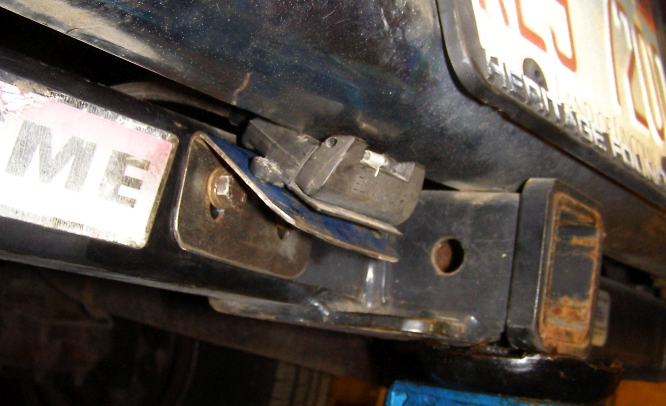

Meanwhile, returning to the rear of the van I had another multi-wire connector to fit up...
...with the added complication of setting in place the wiring for the trailer connector:
Here we have to have at least five wires in the connector - right and left turn signals, brake light, tail light and earth, while I also wired in the reversing lights and there's a wire there (the blue one) for electric trailer brakes should anyone want to fit a controller for these at some time. That took care of the third wire in the 3-wire set from the front, so it's all there should it be needed.

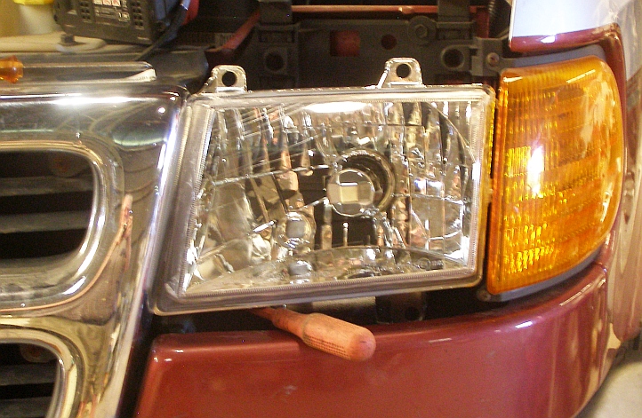

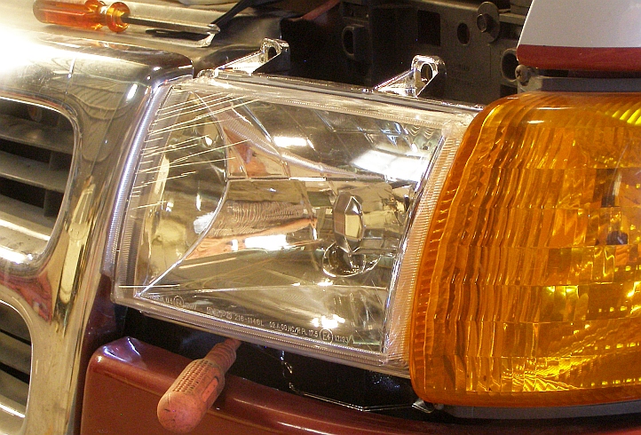

Now I've established that the headlights must be changed...
Because of the design of the lenses they will only be usable for driving on the right side of the road. Well, that's all in the past for this van. So the hunt began for headlight units which would fit into the original lights' location and not look out of place. The difficulties led me to come to the conclusion that simply fitting some 5" x 7" units and making some kind of shroud around them to make them look like they belonged there.
But mounting these brought some difficulties too, until I saw that the mounting units used in the 2002-5 Nissan pickup would make it possible. I ordered a pair of these on eBay, cursing that I was unable to find any in a salvage yard.
And then, the very next day, I spotted a Mazda pickup from the same period - and its lights would obviously fit!

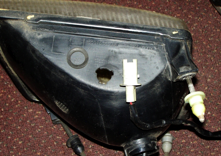

Back to eBay and I ordered a pair of these. They will need some mounting adaptation and a bit of blanking off of the spare space as they're just a bit lower than the originals. Just sitting in place as they will be mounted, how do these look?
They also have a built-in parking light fitting, and to make it all work I have to set things up so they attach via the original adjusters:
It's necessitated the cutting away of some parts of the plastic framework just to rough up the location, more will be required before they're mounted properly and wired up. I'm looking at putting a bit of a stainless steel 'eyebrow' over the extra space at the top, screwing this to the hood (I think), while the panel under the lights will be extended somehow to fill the gap at the bottom.
I'm awful glad that the next van I bring in will be the '91 model with its regular 5" x 7" units, much easier to deal with.
