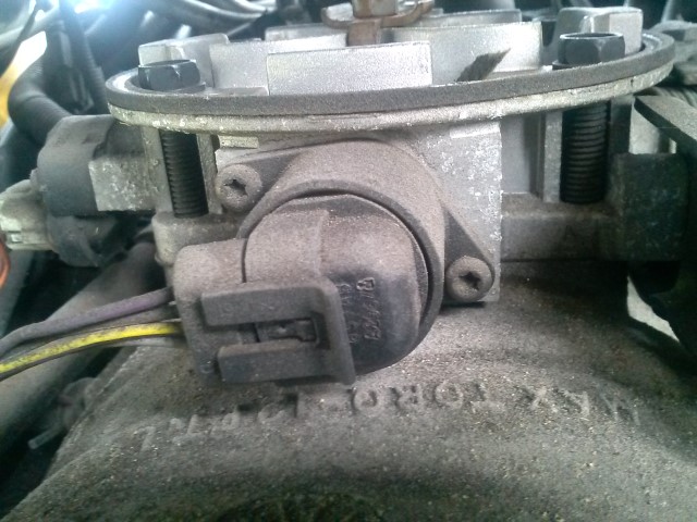

Was it mentioned anywhere what size/type of screws are on that IAC? I didn't see that information when I quickly skimmed the thread. They either look like a square head or an Allen head.

It's a torx head screw, a T-20 I believe.

Cool, I happened to have that screwdriver laying around.
It had a good amount of rust on the tip that needed to be removed and there was a lot of carbon build up in the port. The van really didn't have an issue, but I figured I'd clean it up anyway. While I was there, I also noticed one of my valve cover gaskets was leaking, so I'll be doing both of those soon as well.
