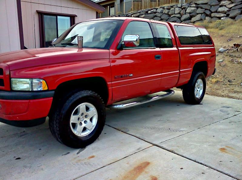

To Mobile Auto Repair,
Thanks for the quick and informative spot-on reply.
OK, read and reread your post. We held our finger down on 'hole' to the AIC for near 30 seconds, engine would not die. Removed finger, and engine surged to 2000-3000 rpms, then, guess what, settled down to 850, and steady. I'm happy with that. Smooth idle, no surging or dying now. I'm happy. Starts with no foot on the gas.
This spring I'll remove and really clean that throttle body.
Thank you all for this thread. Saved me some bucks and my truck is running smooth now.
