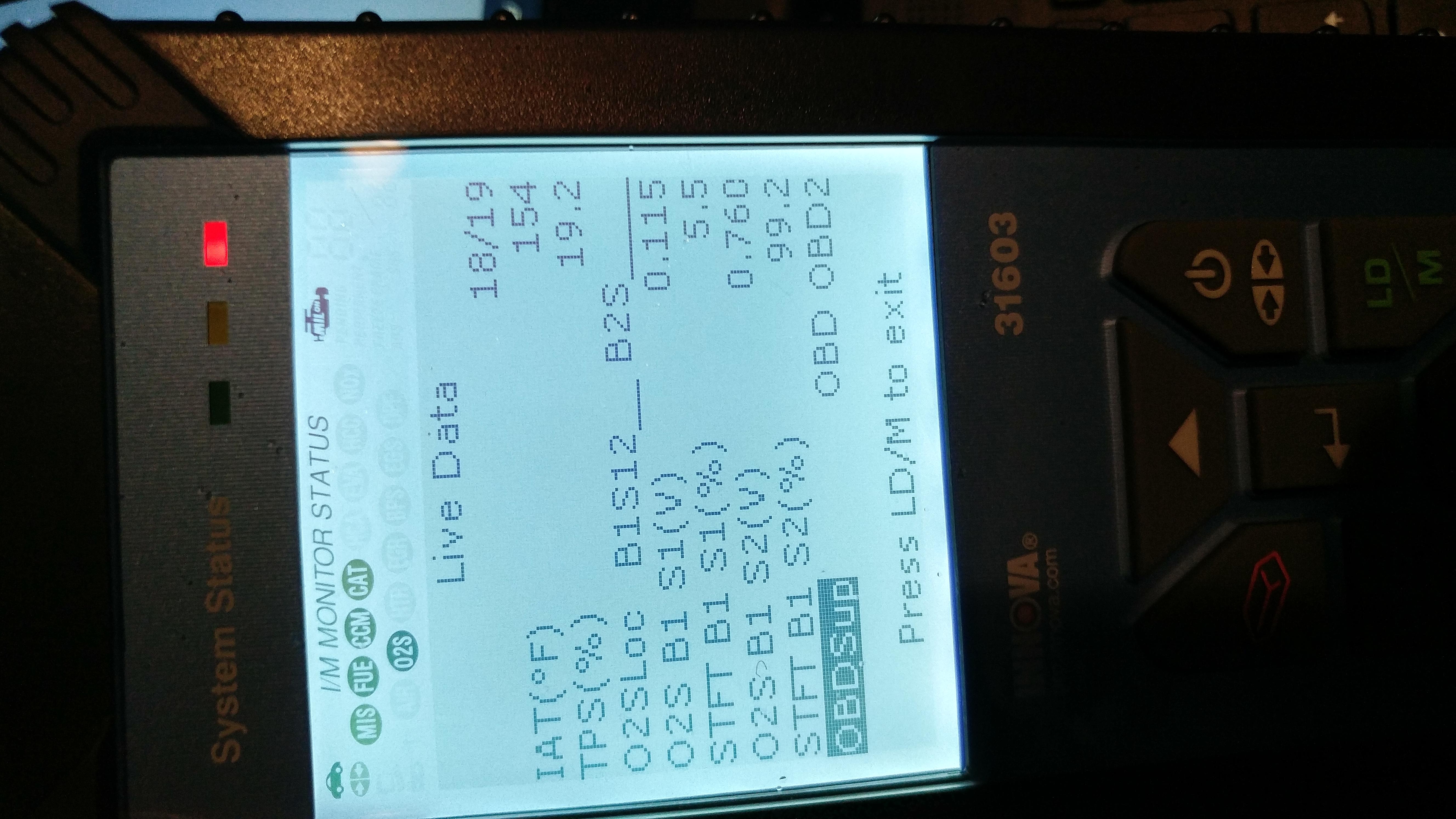

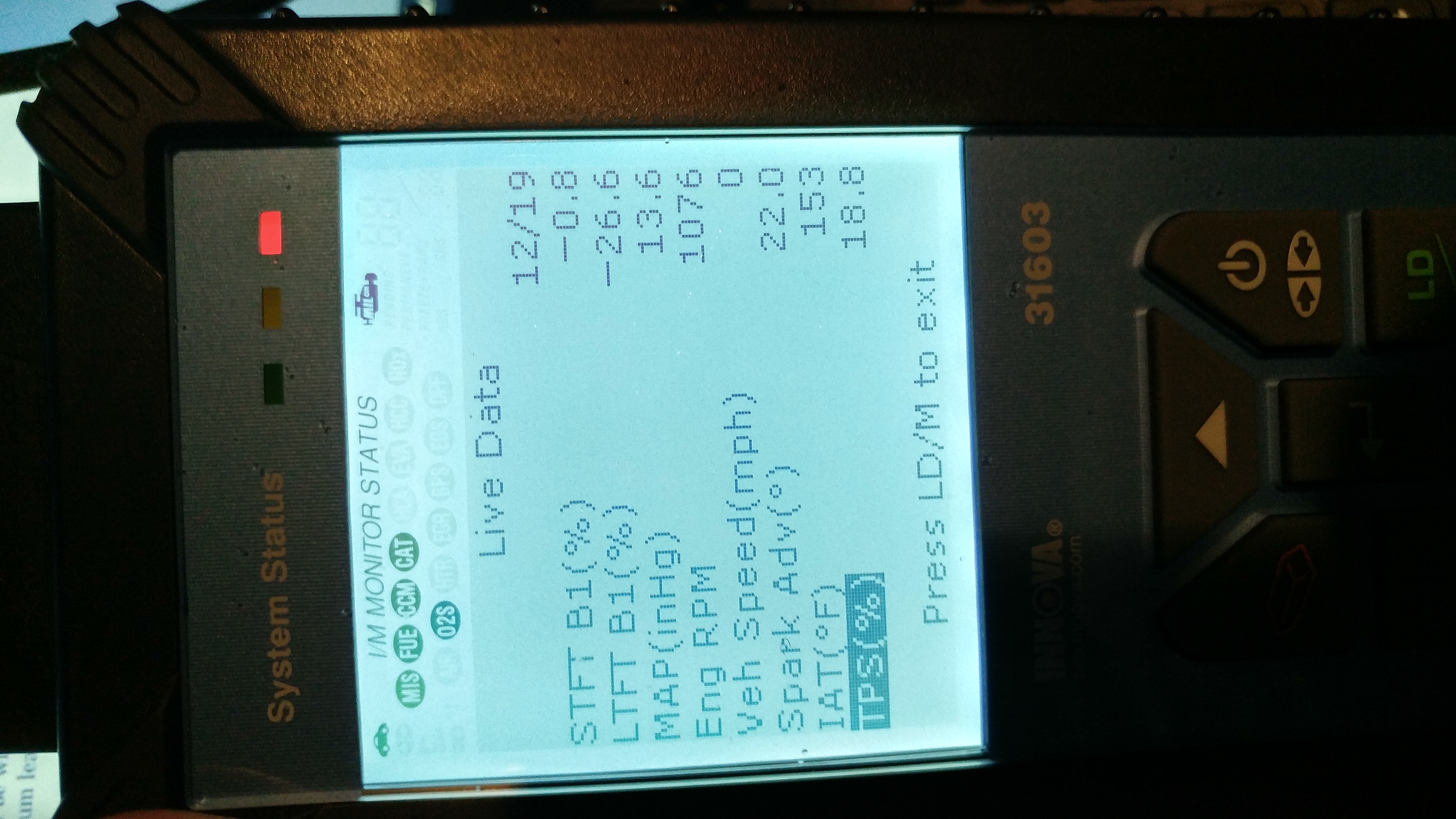

2000 Dodge Stratus Stalls when stopping-20180207_192811_hdr.jpg2000 Dodge Stratus Stalls when stopping-20180207_192741_hdr.jpgClick image for larger version
ID:	126855Click image for larger version
Originally Posted by fca tech
ok it looks like there's a block out plate installed that's ok it probably isn't the source of your problem if there's no egr codes being set information from Chrysler could be wrong and your car isn't equipped with it but code p0172 is going to be a hard one to diagnose so many things could cause this I would be looking at the reason your engine coolant sensor is reading -40 indicating your engine is very cold that could be the cause of your rich running attached is the diagnostic test for that code it will be a hard one to diagnose when I see that code the first thing I look at is the o2 sensors and coolant sensor hope this helps you let me know what you find
fcatech I got another scanner and read freeze frame data from it. I don't really know what all this means, do you? Any information there that would indicate the code P0172 with rough idle?
