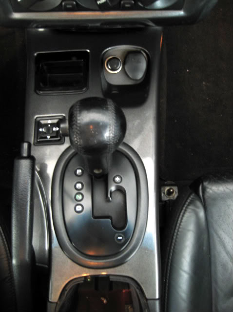

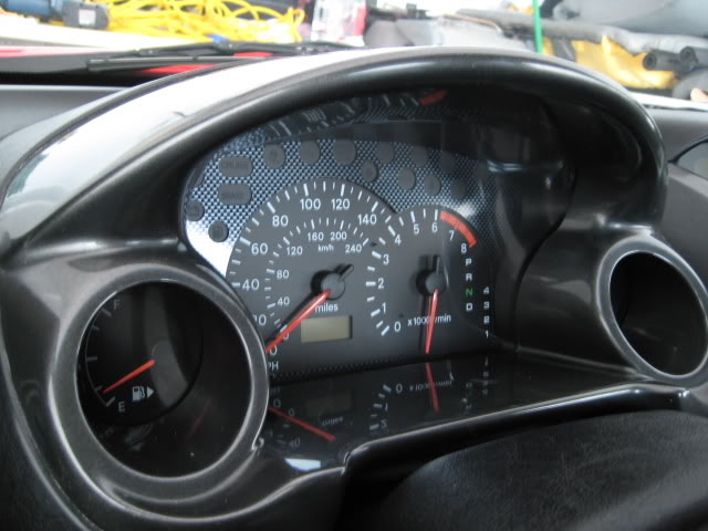

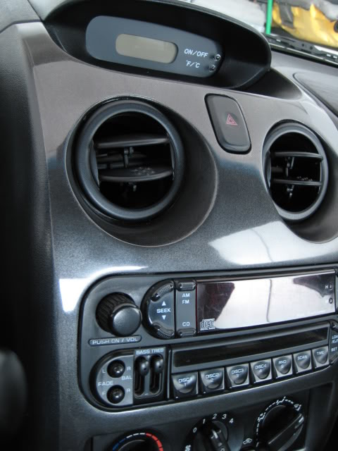

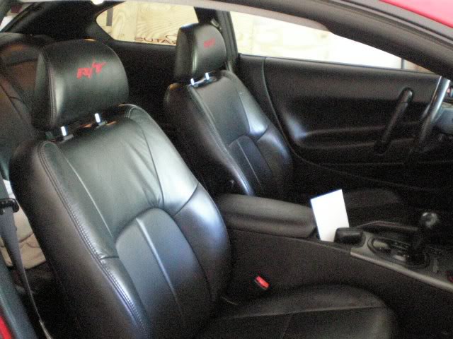

Here are some ideas from my car, I did everything myself except for the headrests.

Headrests:

PaintedRadio Bezel:

Painted Shifter console:

PaintedGauge Bezel:

hey nate what specifically ddi you do to sand the panels and the bezels before you painted
Old Feb 27, 2008 | 05:01 PM
nate_0022's Avatar
nate_0022
Joined: Dec 2005
Posts: 520
From: Cloquet, Minnesota
Default RE: 04 status sxt
ORIGINAL: zeropilot
For the door panels, no sanding was needed, went to NAPA picked a couple cans of Duplicolor Vinyl Fabric paint. My prep work for the door panels were Just getting all the oils and grease off with mineral spirits.
The Bezels I sanded all of the rough texture off where I was painting. I started with 120 grit, 320, 400, 800, 1000 grit. I would recommend wet sanding so the sand paper doesn't get clogged up as fast, Than I cleaned it all off with Mineral Spirits, taped off where I was going to paint, 3 coats of Duplicolor Adhesion promoter (basically a clear primer for plastics, worked great) 1 coat..wait 3 minutes, 2nd coat wait 3 min, 3rd coat, wait 5 min, than your ready for the color of your choosing. I used 3 coats total wait 15 minues in between coats ( remember light coats, to avoid runs, and sags.) let dry for 24 hours, than your ready for your clear coat I used Duplicolor Acrilyc Laqour clear coat(sp) 4 coats of clear let dry for 15 minutes in between each coat, than let dry for 24 hours. Now your turn to wetsand. I started with a 1000 grit remember to use a lot of water so you don't burn through your clear coat, 1000 grit till orange peel is gone than move to your 2000 grit. After your done wetsanding now you move onto your running compound. I used a 3m Rubbing compound. You have to work this stuff in very thourghly it;s not wax, more so like a liquid sand paper, do this until you see that thing shine really well. Fianlly install back into your vehicle, let the fumes settle for a couple weeks, than apply your polish and wax.. Any more questions feel free to pm me or post here.
