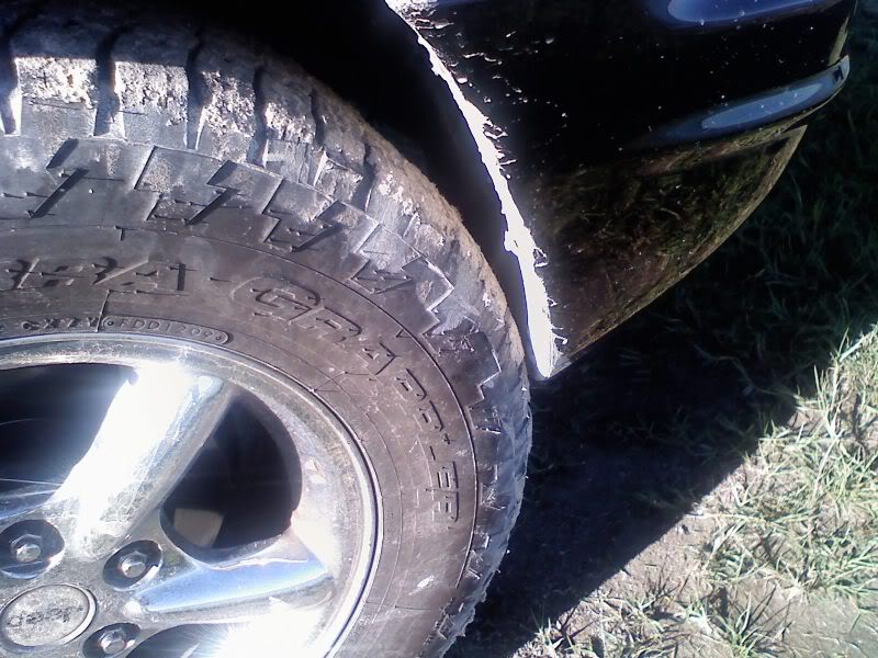

So anyway, 21k miles later, some mild off-roading, some carrying a 100# of winch in the front, a lot of traveling some pretty knarly trails to fish the intercoastal and I've now got this with NOTHING but a 5 lb. light bar stuck in the front receiver:

This gap WAS about 1 1/2" with the winch on the front at one time.

Sh*t, with the SFA in the front and lockers front and rear this thing is more off-road worthy than my truck. The isolators are a known issue with age/use and they will pancake over time. At least half of the 2 1/8" I'm down is the isolators.
But I figure since I'm doing springs, might as well get the heavy duty ones. Plus it's always better to do a lift with the springs than spacers, ESPECIALLY when the springs are cheaper than the stock ones.

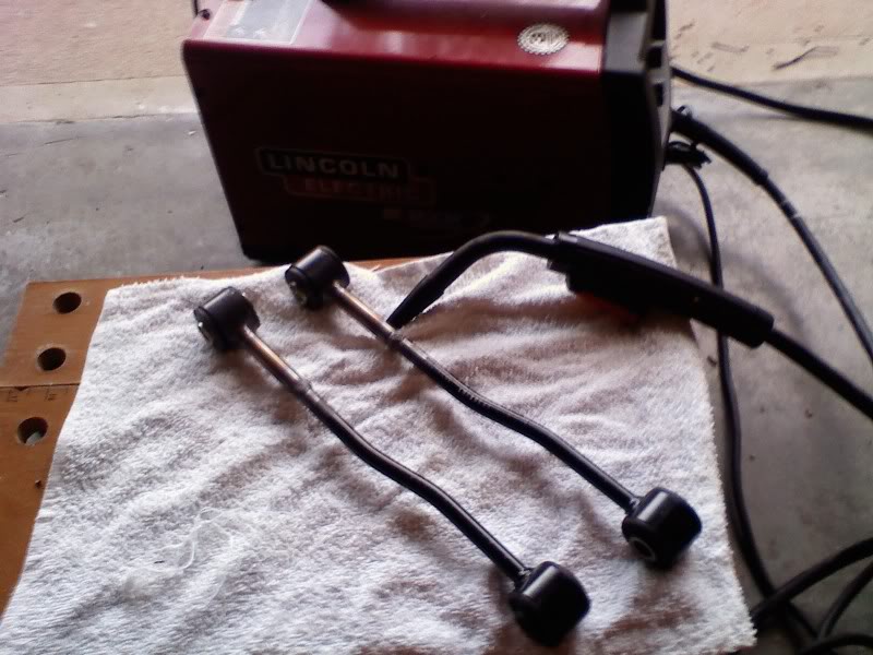

Well, I priced the IRO extended sway bar links and they want $150 for the pair!!!
That ain't in the budget right now, so instead I bought a set of stockers locally for $20, cut them and welded in a piece of solid round steel to make my own.

Now if the damn springs and isolators would get here I can button this job up!!!

I love fabrication! but it makes me hate spending money on dumb things like isolators that you really can't make yourself..lol
End links look good dude. With the money you saved, you should buy the darn addco!

Looks good. Put some black paint on them, just to give the finish touch.
