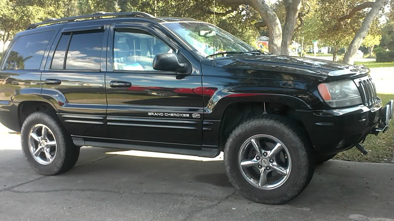

This was taken about a month ago at one of my favorite fishing spots on the intercoastal, every dip in the trail, I was scrubbing - no weight on the front receiver either, so imagine how bad it would have been if I tried to slide the winch on...

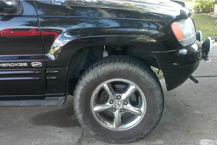

Yesterday after the OME HD coils:

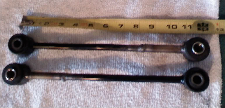

I ended up making my own extended rear swaybar links because the IRO ones are $150. I had $23 each in these Mopar ones and just had to cut and weld extensions on...

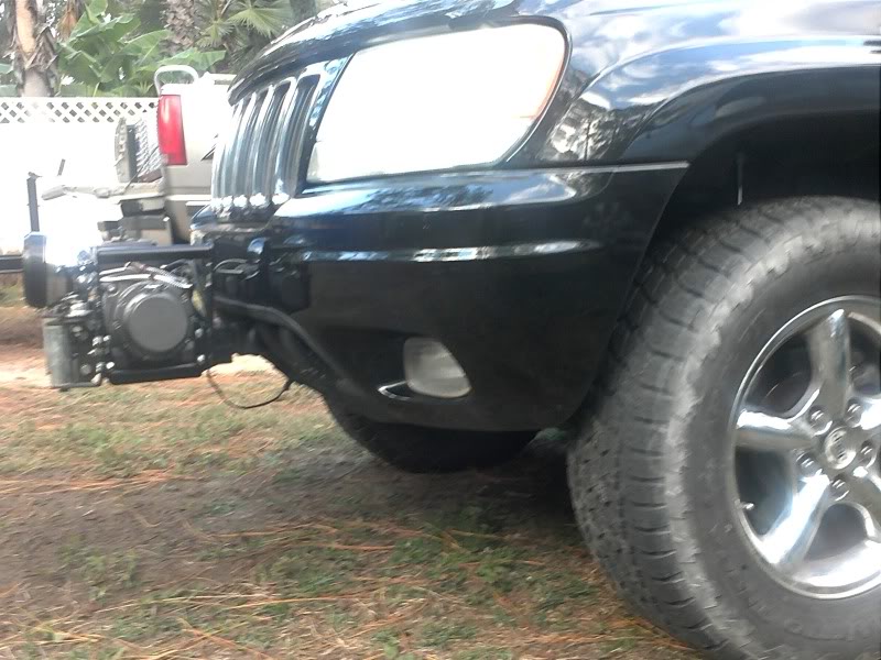

Here's a little bit better shot where you can compare the clearance of the front bumper in my 1st photo in the initial post (before) and now:

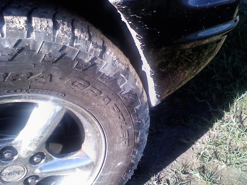

Well I believe I made the right choice getting the HD coils. Even before my stock coils started munkin' up, putting my winch on the front pulled the front down about an inch.
Winch on the front now, pulls down about 1/4":
