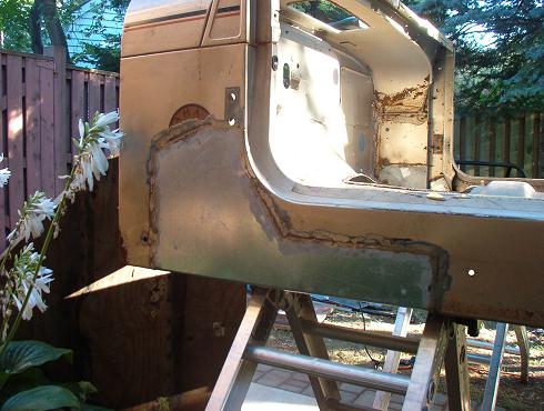

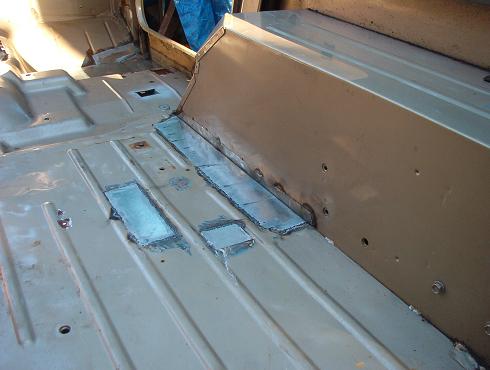

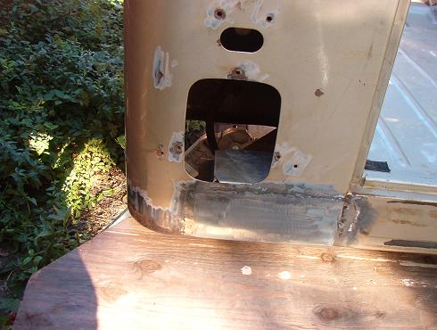

Around here, finding a YJ body that's in good shape is difficult. Chrysler made them with a lot of joints and cavities that tend to hold moisture and create rust. Most of the rust rot is easy to fix, but the various channels (these tend to hold the body mount captive nuts) & posts (the main ones are behind the doors & are time consuming to replicate). Here are some pictures of the body I decided to repair a couple of years back - these show the general sheet metal that I replaced on the floors. I also repaired all the body mount cavities and door posts but didn't take many pictures of these fixes. Most of these pictures only show the tacs and not the finished weld.
