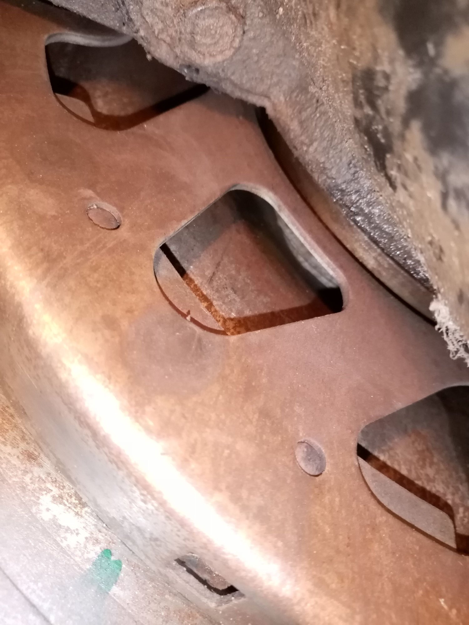

I've just tried to align the tc one more time, just to double check.. I looked closer through the gaps and saw an impressed sign on front surface of the tc housing, 2928M. I also noted that still there are two small round weight plates attached to the outer linning of the housing, so now i don't know if these are weights for neutral balance (as they are pretty tiny) or I maybe have weighted tc that can't fit here?
Done. I enlarged the offset hole so that the screw fits. Had everything installed and tested and TC seems to work fine, car accelerates from 0-60 MPH in about 7 seconds, shifting seems to be smooth, no jerks, excessive vibrations or similar. I want to thank once again for all Your help!
