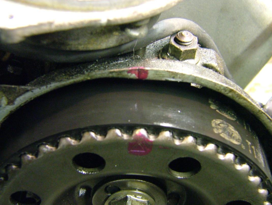

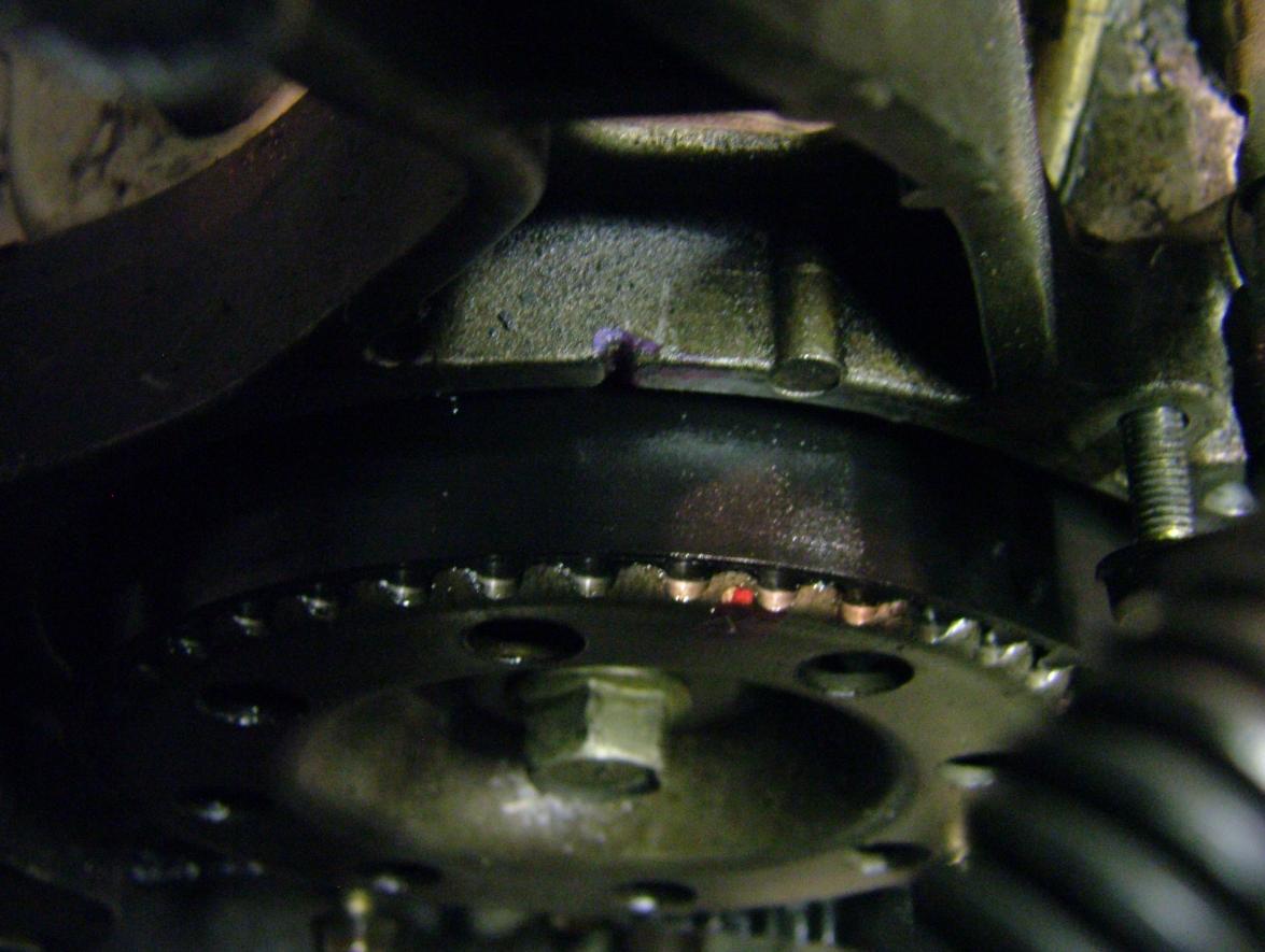

it looks as though my timing belt has jumped, im not all to sure how to find tdc for cylinder number one...
front cam
rear cam

any advice on the best way to proceed...

you are definitely NOT timed correctly . front cam is ok, crank off 1 tooth, rear cam off 1 tooth. So you need to fix it.

i would agree with 22dodge. i have put quite a few of those belts on and it is easy to have one or two of the pulleys a tooth off. the trick is to have them all lined up with any slack worked around to the tensioner side so when you rest the tesion it does not pull one of more pulley around.

i don't have any pics my camera wont focus correctly. it wasn't too hard to get the timing on the crank and cam sprockets back in line, it only took three or so attempts to get the timing belt on while keeping all the timing marks in place. the engine runs smoothly and there is no longer oil leaking from the front main seal. however there is a separate problem. it sounds worse at start up, there is an even violent knocking/klattering sound coming from either a messed up valve, valve guide, lifter, coming i think from the rear head assembly. ive taken the rear valve cover off but saw no sign of anything out of place in the rocker assembly. im not sure what is causing it. whatever it is it doesn't seem to affect the overall function of the engine in any noticeably drastic way other than the above mentioned sound. the knocking sound will increase directly with an increase in rpms. there is no hesitation or loss of power from the engine. i am hesitant to push the engine much past 2500rpm for fear that something catastrophic may occur.
