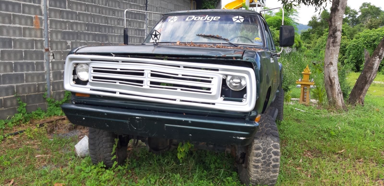

Its been a few years since I’ve had a Dodge truck, I do miss the 5.7 HEMI 1500 Quad Cab! Living in Thailand there’s not too many interesting vehicles around but a friend came across this and I bought it almost instantly. Its got plenty of character and needs a bit of attention!
Can you help me identify it? I was originally told it’s a D100, but looking at (photos of) it and doing some research, to me it looks more like a W300 with a stepside longbed? What do you think? It’s a 4x4 so that means it should be a W rather than a D, if I’m correct? The overall size of it looks to be bigger than the D100 but I’ve not had them side by side to compare.

I'm no real expert, but the engine mounts aren't as you'd find in a V8 model...
It likely had a Cummins diesel. The grille, I think, might be early seventies, before 1975 anyway. Overall length would be the same as the D100 long bed, I'd reckon.

It's a W300 according to the data plate.The front end looks like mid 1970's but Chrysler reused older tooling for export vehicles.It's definitely a gasser because it has the vacuum booster for the brakes. This truck could have had a big block. That may be why the engine and transmission are missing but the transfer case is still in it. That bed was used for decades.

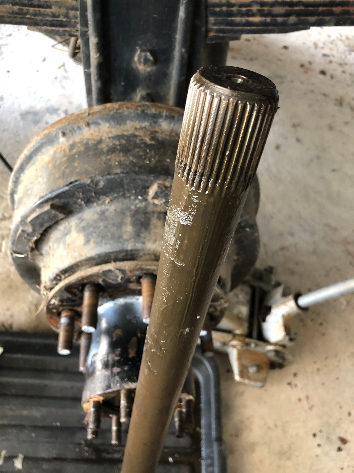

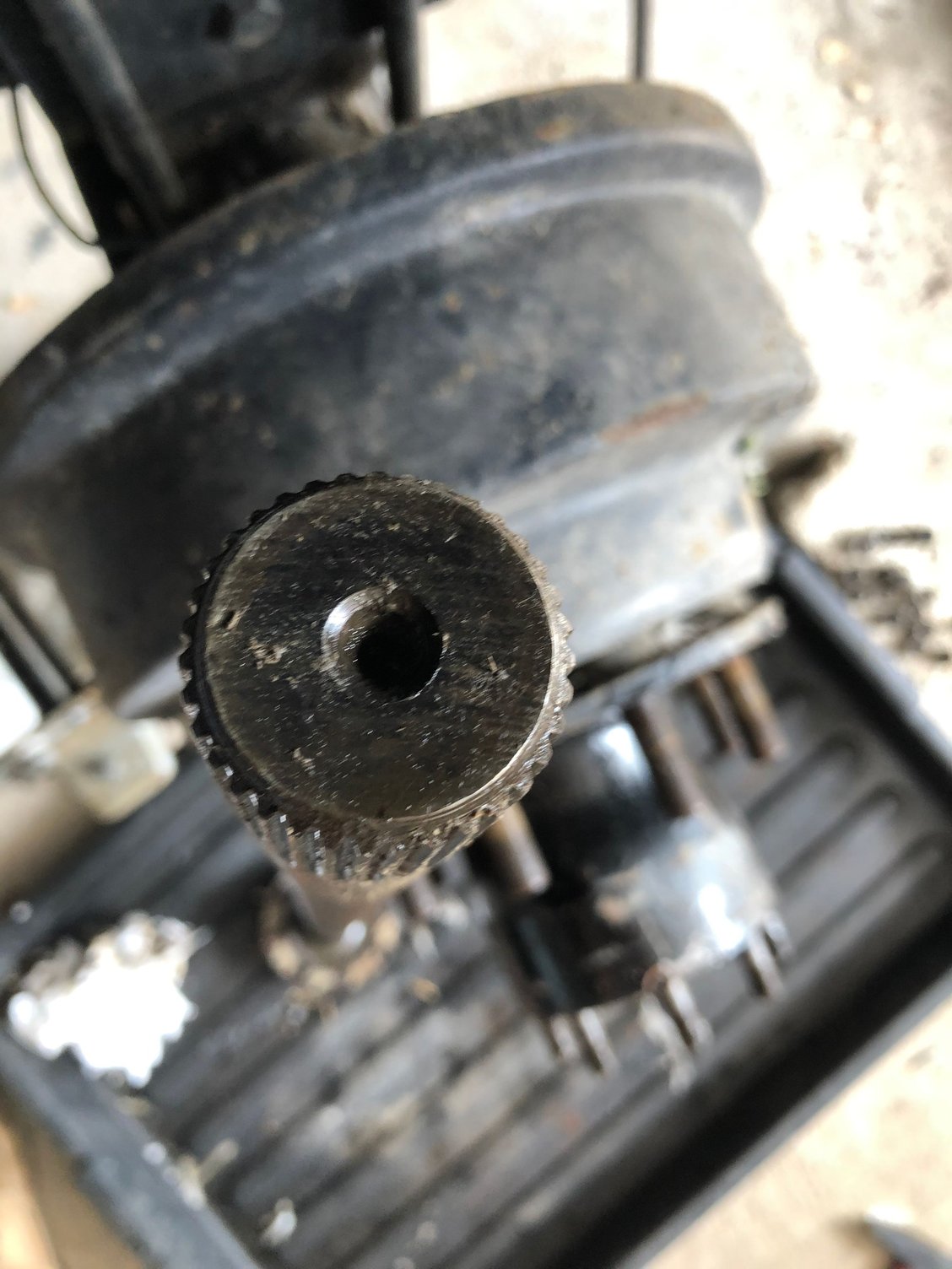

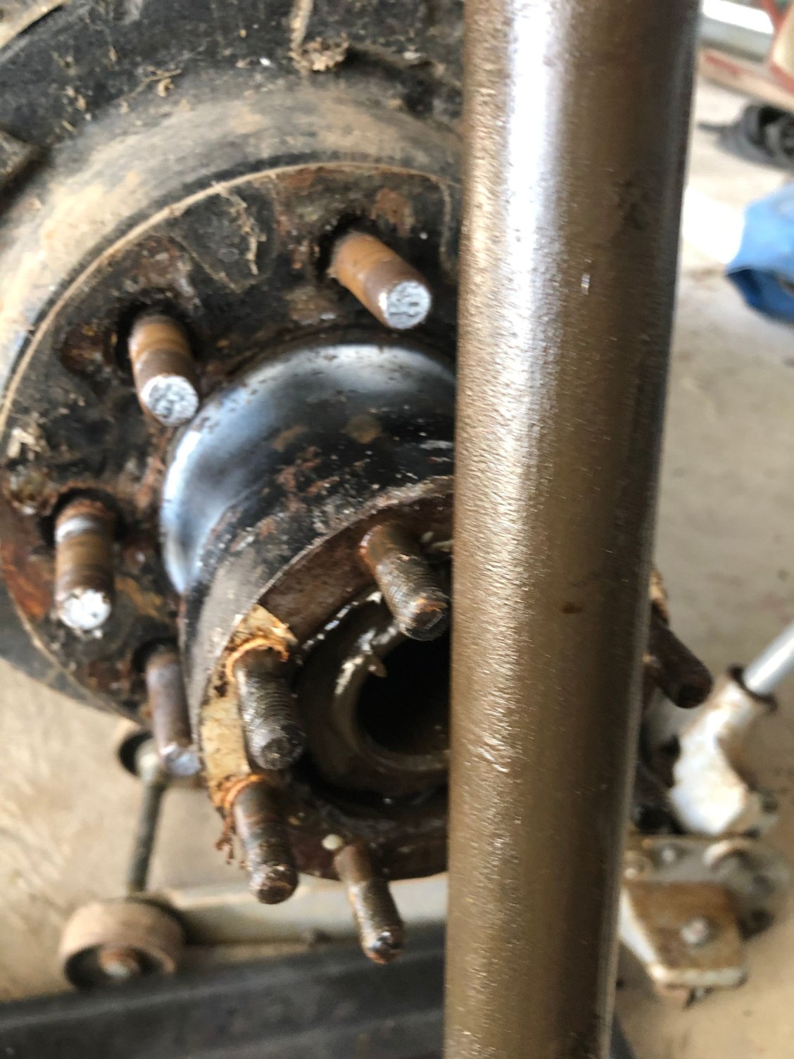

A bit more investigating at the weekend, the axles look to be a Dana 70 closed knuckle at the front, and a Dana 70 at the rear. I removed the rear drive shafts and the splines (35) look to be in great condition, so my hopes are the diff isn't too bad either! Thinking for the rear I'll do the wheel bearings as a precaution anyway, clean it all out, measure the backlash and diff setup, and see how it runs. The front I'll do the CV joints and wheel bearings, check the diff over and give it a go. Prop shafts I'll do the UJ's anyway.
Rear Right
Rear Right
Rear Right
Rear Right
Rear Left
Rear Left
