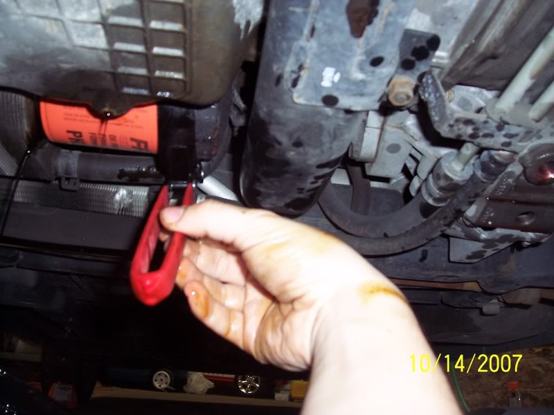

thanks a lot man. Drove the cararound the block and brought it back andit's still leaking a good amount.A friend of mine came by last night and we checked the power steering fluid and it was low (ADD).
Those lines I posted what are they called?
Also, the fill plug is the rubber plug with what looks like has a "nipple"on the driver's side (when looking at front of car) correct? Just making sure I don't pull the wrong thing. Thanks a lot for you help it's awesome. Bear with me though as I drove an auto SE forever and a day and never had to check for tranny problems or anything like that.

yeah, in the picture of the trans, thats looking from the front. the fill plug is on the side by the driver's side wheel can be seen in the pic. if you have a cai you may be able to see it from the top as well. but if you have a stock airbox you probably will have to look from underneath to see it.
i wish i had my car here to look at where the lines go. i thought they might be hvac related but another member said one of them was for the power steering. try to trace the lines and see where they go (power steering pump, a/c compressor, etc)

looked in the manual, it looks to be a power steering line running to the cooler (little radiatior you see behind the oil filter)
this sounds really strange but its in the manual:
"CAUTION: Use only MoparT ATF+4 Automatic Transmission[align=left]Fluid (MS-9602) in the power steering system.[/align]Do not overfill."
automatic transmission fluid in the power steering... uhh makes sense to me[&:]

^^Yea i have been reading about that. I think it is the power steering. Since it is ATF+4 do you think i can by the Pennzoil ATF i have at work and put it in or should I wait on it? I
t only leaks when I drive the car. When i have it running at idle it doesn't at all. Could that be an indication or if it was a tranny leak would it happen the same way (leak only when driving)?'
In the picture above, the hose on the left is the one where i saw the fresh oil around the seal.

Yes our Powersteering fluid is ATF+4, and those are the PS lines going to the powersteering cooler that are leaking.[/align][/align]No that isn't a common problem. But if you lost that much already, there really isn't all that much in the system to lose in the first place. Check the black resivor to the left of the intake manifold, if the car is an 04-05 it will have a black cap, if its an 03 early 04 built in 03 it will have a yellow cap. Fill that bad boy up with the ATF+4. Then definitely get it somewhere where they can definitively diagnose which portion of the PS system is bad, be it the cooler, the lines, the hoses a loose clamp, etc.[/align]

hmm, you could try having a buddy crank the steering wheel back and forth with the car just idling and see if putting pressure on the steering pump makes fluid leak out onto some cardboard under the car.
it all makes sense why it looked like tranny fluid after reading that. i never had to put any in mine yet, so i never looked up what kind it used. but tranny fluid? wow, i admit im suprised by that one.
just check up on the lines running through there for a loose connection where it may be leaking from. could be a very easy fix (loose or broken clamp, etc)
