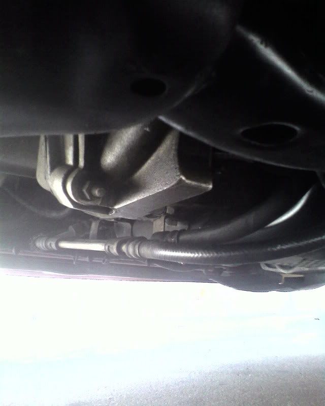

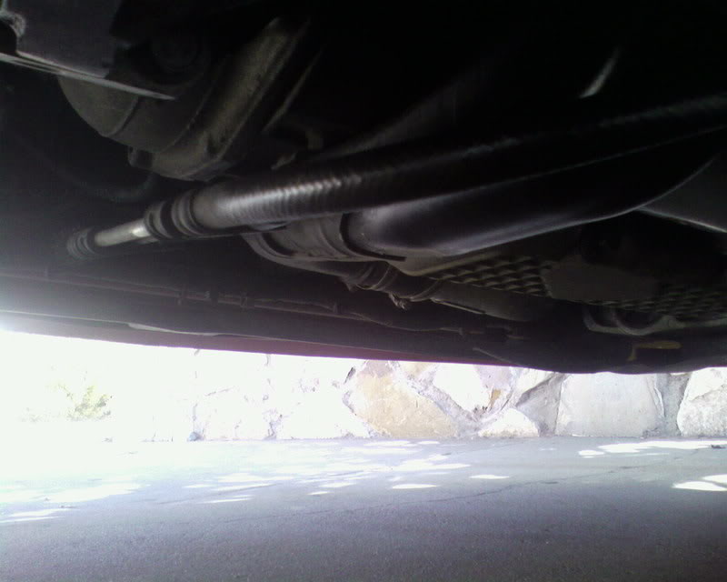

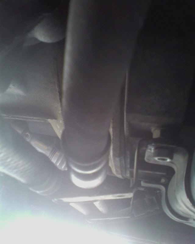

Anyway after driving it home and for a small test drive around the block (did not get on it at all). The next morning i noticed a pretty big puddle of what my dad says is tranny fluid. It can be seen in the pic bottom right. It looks as if it is coming from two lines under the car drivers side. Any idea what it could be? Is it even safe to drive around? I checked again this morning and it leaked a bit more but not as much as the first time. Any help is appreciated, THANKS!

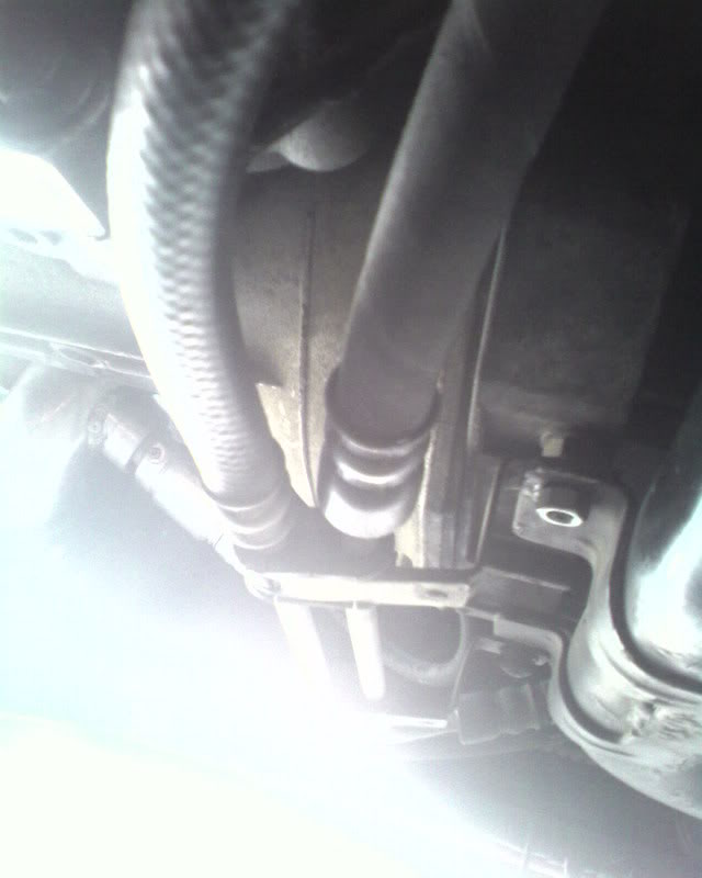

alright here are the pics. When I was looking at the line on the right, it looked as if that's where the leak (PIC#4 Shows it best)was coming from.Where the hosegoes into the metal piece, there waswhat looked like fresh oil around it.PLEASE SOMEONE HELP! would like to drive it to work but I go in in 45 minutes. ANYONE lol
is the transmission itself leaking? see fluid anywhere on the outside of the tranny housing?

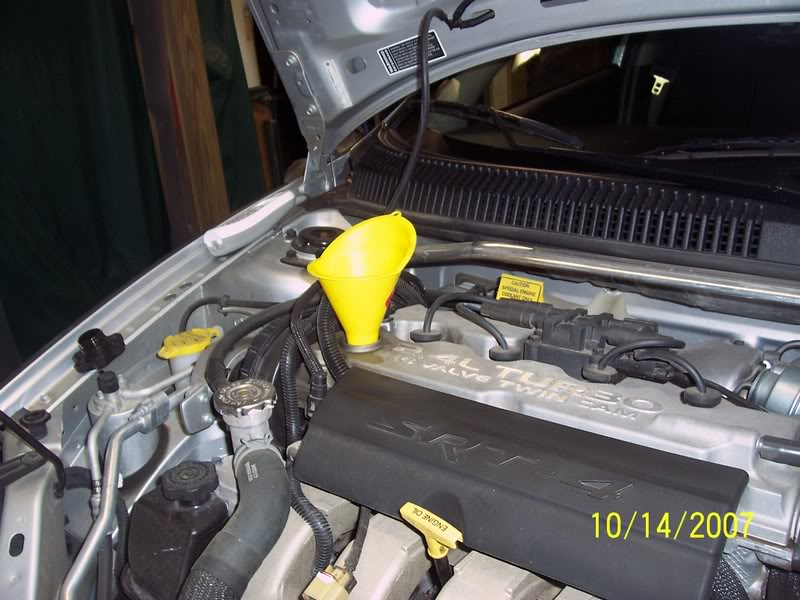

you can see in the pic a little more clearly here the lines your talking about. you could put your finger into the 'fill hole' up top and see if you can touch fluid. if not you may want to add some and keep it, and fill some in:
unfortuantley my wife has the car out so i cant go looking under the hood at where the lines lead, but from what i recall i think the lines running under the trans may be related to the heat or a/c system.
if they connect into the 'canister' on the far driver's side, where the silver lines (which connect to rubber lines), then its part of the hvac system

well its leaking a pinkish fluid and they only place I could see it was on those lines i took pics of. I didn't see anything on the tranny but I will have to look again tomorrow, as I'm going to work right now. Thanks and if you or anyone else has anymore info, please speak up. Thanks!

Hey unfortunately me and some friends ran into this exact problem the other night but ours was at the Power steering cooler. Those line you took a pic of...one of them is a power steering line...if your tranny is low on fluid. check your power steering fluid... SRT's are infamous for a power steering leak but thats usually from the reservoir. just to be safe check tranny and power steering fluid, both are a redish color.
um, they aren't infamous for a power steering leak. they're infamous for a pcv oil leak,as well asa coolant overflow leak (on 03's only).

now that I think of it, I could see very little fluid on the tranny itself but again couldn't determine where it was coming from. What you said aboutit leaking and making the lines appearlike they are the problemmakes sense flamingpinhead. i'll try to get the car up tomorrow. I'm gonna drive it around the block right now and put cardboard underneath to see if it leaks again.

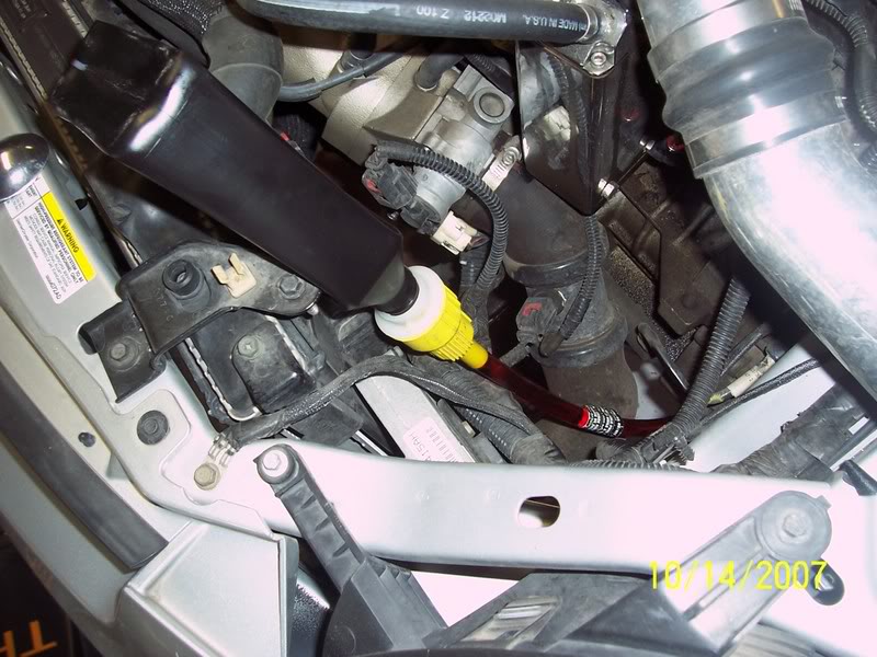

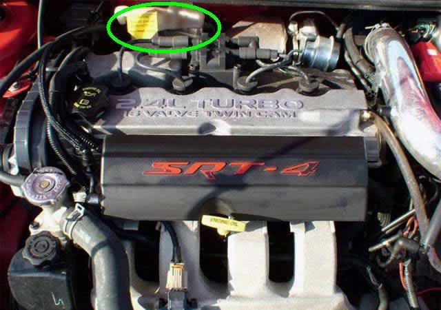

as i posted teh picture of where the 'fill plug' is on the transmission. pretty much you remove the fill plug, stick your pinkyfinger inside and downward and you should be able to touch some fluid. if you need to add some use "Mopar ATF+4" (i have seen it at walmart for $4 a qt but you may have to seek a dealer for purchase). power steering fluid resivor you can see from the top, not a bad time to check your brake fluid and coolant as well. ill find some pics to post up in a minute.

Coolant Resivor:
Brake Fluid (DOT3):
