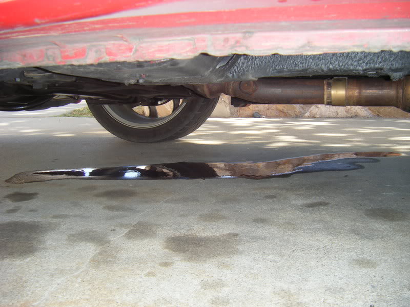

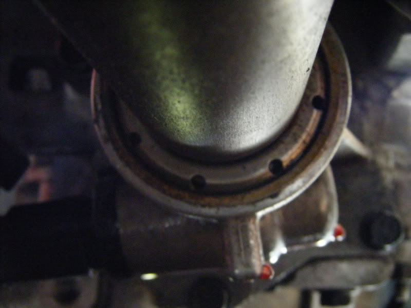

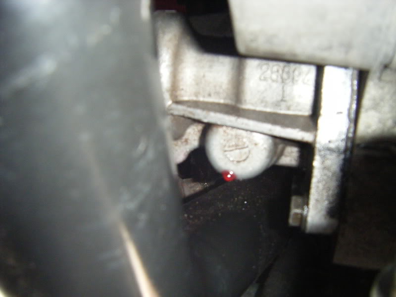

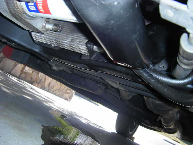

Well I'll know for sure hopefully what it is tomorrow morning the leak came back with a vengeance, so I had it towed to my mechanic. I'm thinking it's not the power steering anymore (see pics). Any ideas? The pics of the droplet is from the left side of the tranny (if looking at the car from front)

The hose on the left side of the car (Driver's Side) is a power steering line...We just replaced the power steering cooler on a 2005. The line on the inside (Block Side) i believe may be a a/c line. Dont take my word for it because i really didnt pay attention to that line when underneath the car. And yes can use ATF to fill the P/S reservoir as long as it is Mercron 5.

It was a bad speed sensor that was causing the leak. It was tranny fluid that was leaking. The car is now fixed and it runs like a champ!
