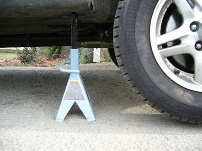

Removing the Wheel and Safely Supporting the Vehicle
Begin by loosening your wheel lugs (always do this while the car is still on the ground - for safety and for better leverage), then jack the front of the car up and rest it securely on jack stands. Always be sure your car is supported securely. A wobbly car or truck can lead to a serious injury or damage to the vehicle. There's no reason to take chances when you're working underneath an elevated car. With the car safe, remove the wheel lugs and take the front wheels off.
With the wheel off, turn the steering wheel all the way in, opposite the side your working on. For example if you're working on the passenger side, turn the wheel all the way toward the driver's side. This will give you easier access to the ABS parts both visually and in terms of your reach.
