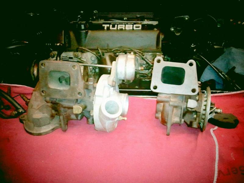

So, If many of you don't know the history of the TI,TII, TIII, TIV engines that came in these 80’s-early 90’s K style cars. Here is a very quick run down of the 2.2L w/the Garrett Turbo. The 2.5L’s were the same block but had a longer stroke crank, balance shafts in the oil pan. And came with the much smaller Mitsubishi turbo. And as far as I know were all not intercooled.
TI -SOHC 7 psi non-intercooled 4cyl turbo 147hp.
TII -SOHC forged internals intercooled 12 psi 4cyl turbo 174hp. (debuted in 1987 Shelby turbo models)
TIII - DOHC forged internals intercooled 12-14 psi turbo 224hp (early 90’s Spirit R/T’s & Daytona IROC R/T’s)
TIV – SOHC forged internals intercooled 12 psi 4cyl VNT (variable nozzle turbo, i.e. cuts down lag) 174hp
So back to the story. The car had a TI. And for years I’ve wanted to put a full blown TII swap into this body style because it was never factory offered. Or better known as the Shelby Dodge engine. So I got my hands on a very cosmetically beat down 89 Shelby Daytona for $250. It was the full package! It had the better engine, better transmission (A555). And all of the suspension and break components were the most beefed up from all of the models! That included 11" front rotors. And vented rear disc. And better yet, aside from the front bumper and rear bumper looks. Everything in between was the exact same body. So the swap was going to be cake. And it was easy. The entire parts swap took me 1 month to get the 89 Shelby torn down to basically a shell. And get all the parts bolted up to the 86 Turbo Z. Then came the engine harness wiring. Not much changed. It consisted of adding 3 pins to the harness for the AIS, MAP and TPS. Swapping out from the LM (Logic Module) mounted MAP. To and underhood MAP. And swapping position of some of the pins to bring it 1987 wiring specs. Also having to change the LM to one that came from one of the 87-88 Shelby cars. The 87 GLHS is the best one. But I got my hands on one from an 88 Shelby Lancer. Seems to work just fine. When I got it fired up, I drove it on it’s maiden voyage of 50 miles to its first car meet in 3 years. A small group here used to do monthly meets. Fuuuu that thing was fun! Aside from the engine temp running a little warmer than I’d like (3/4) it ran great! When I got back to my garage, I noticed oil leaking from the strangest area. I installed a 90 deg radiator hose on the DSM BOV to blow air under the car. It was dripping from that hose. I blew the turbo…. Luckily I had a spare. While it was down I decided to look into the overheating issue. Everything in the cooling system was brand new. Aside from the original radiator. I found out it was almost completely clogged. So from that day the car has sat due to life events and lack of funding. But it is in a climate controlled garage. Thanks for sticking around to hear me rant. Kudo’s if you made it to the end! Here are some of my favorite pics.

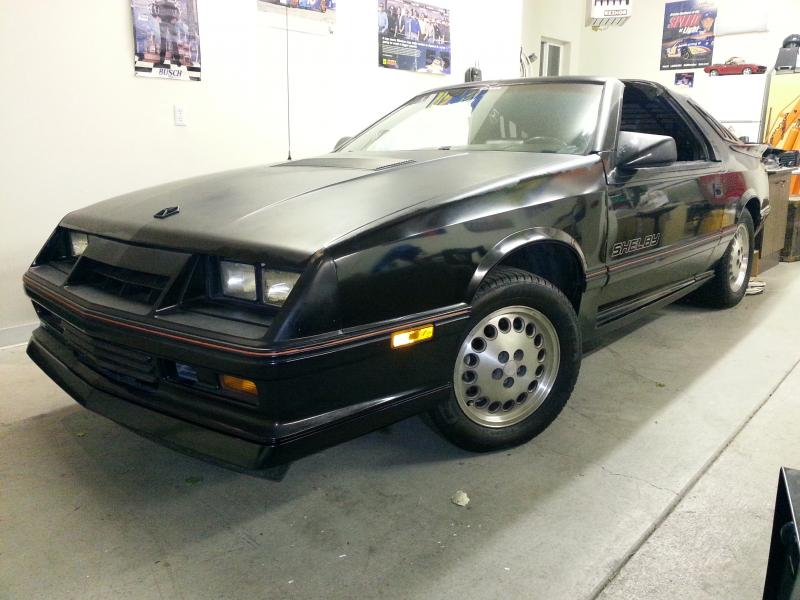

Her is what it looks like today
And I’m not a huge fan of this pic because I just recently acquired difficult to find and always destroyed front lower air damn that is in the picture above. But it’s still sexy.

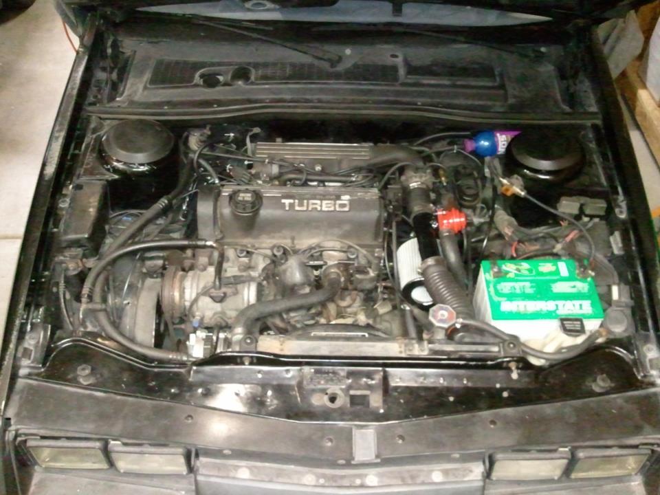

Here is a current engine bay pic also a split pic. The top is the stock TI. And the bottom is the current T2

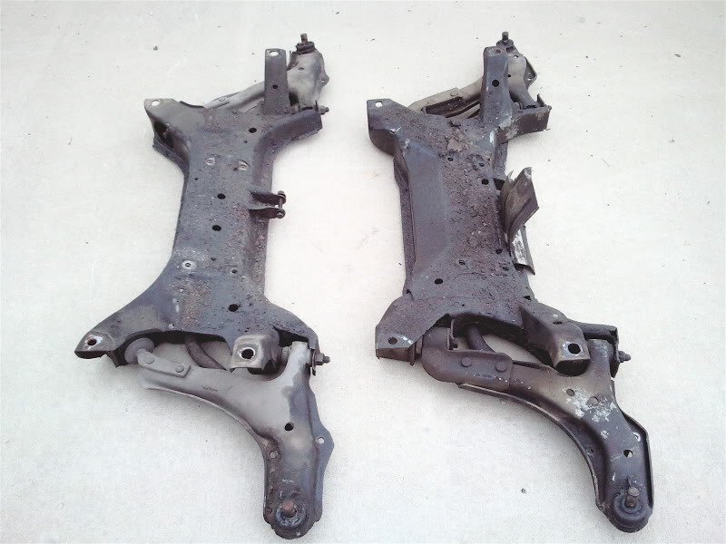

K-frame upgrade!
