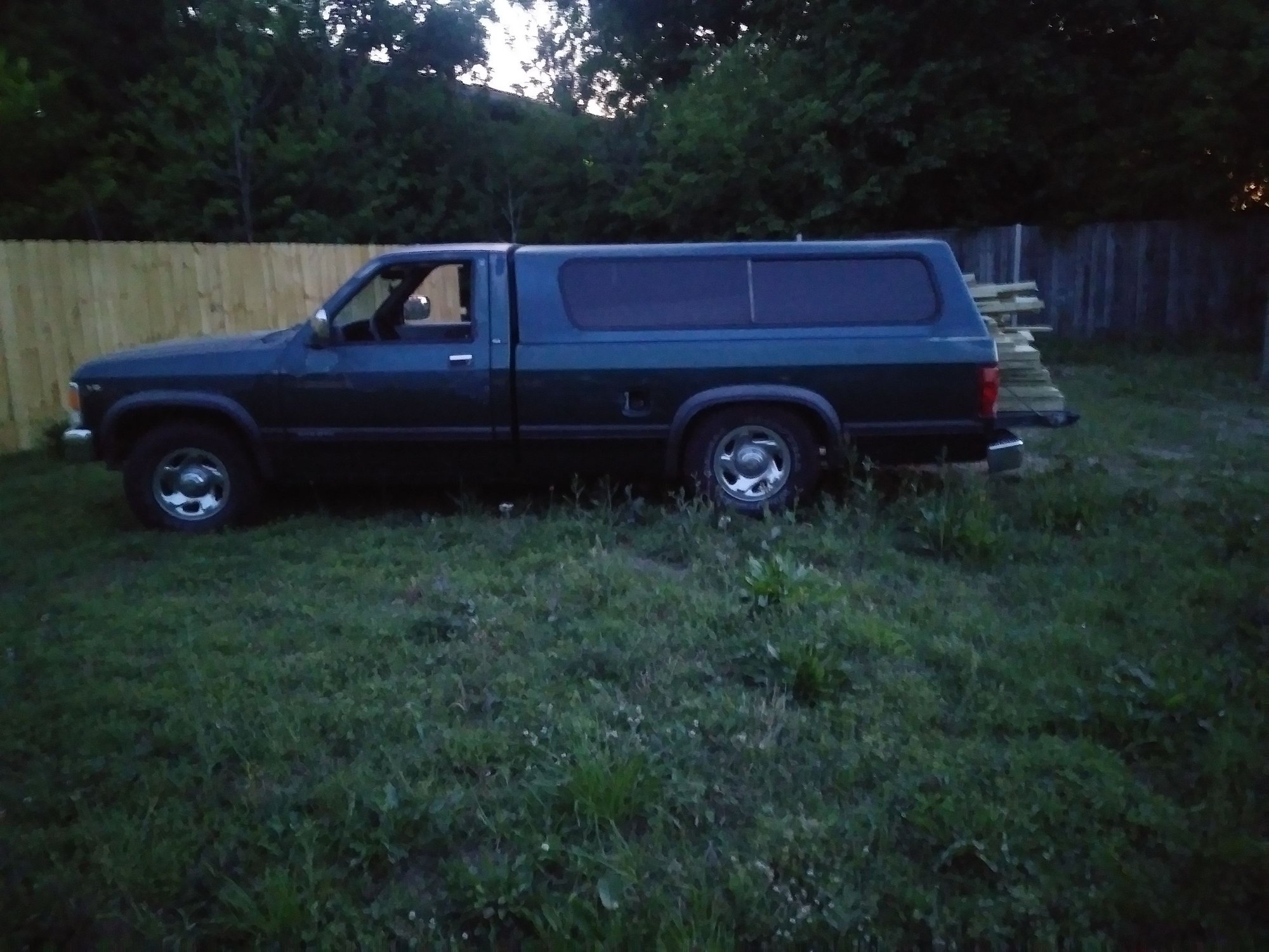

Well i used to be on here for a 1996 Dodge Dakota

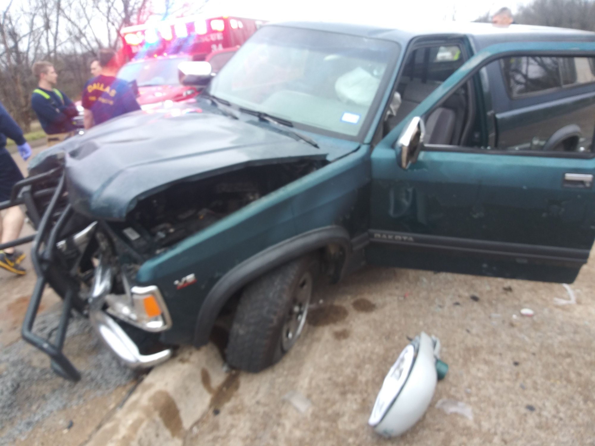

But unfortunately i totaled it in January
bent the frame and cab when i struck the lamp post.
I was glad nothing happend to be or anybody else but was heartbroken to say the least.

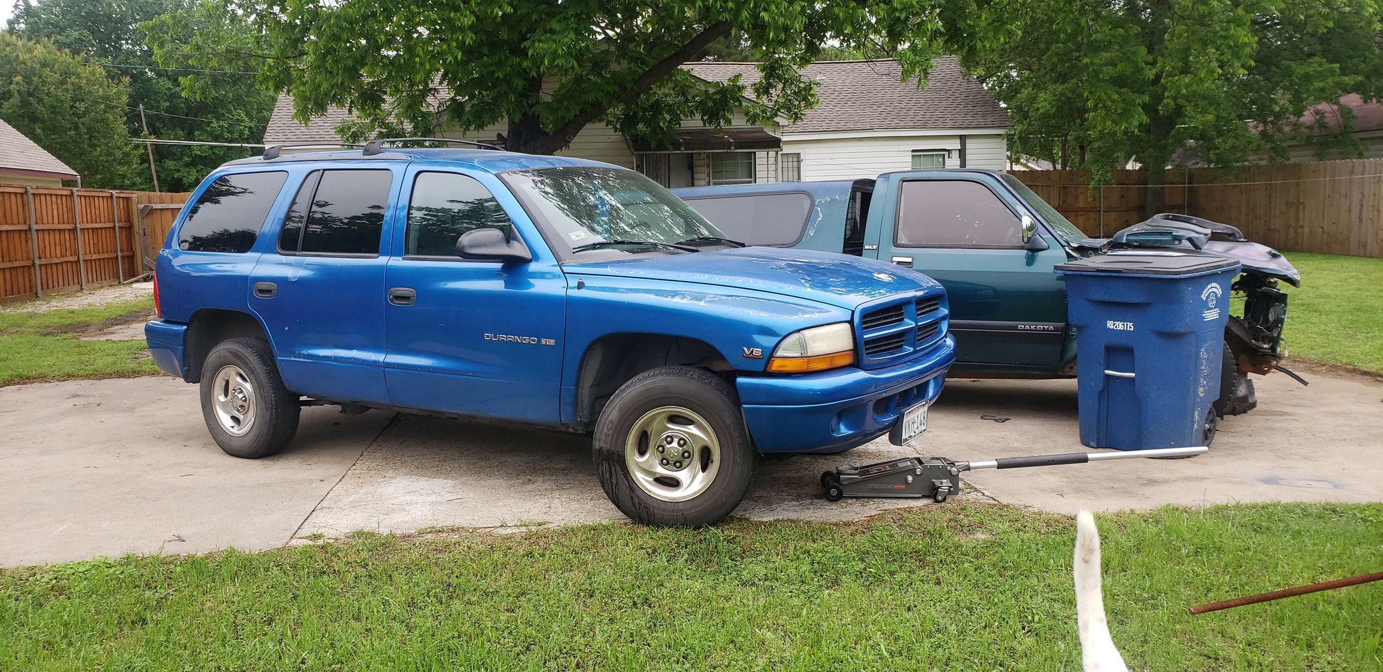

I found and a bought a 98(the exact year ive been wanting) with a blown 5.2, the piston went trough the block, for 400.
Before i bought it i thought to myself, "you wanted a car that needed work and was cheap, well here you go!"
Now, my first question is do you guys think my 96' Dakotas V6 will sit and hook up to this 98 Durango? Motor mounts are different, fuel pump might have to be changed. What about the tranny is there any major bolt pattern difference between the 42re (in my dakota) and 44re in the Durango? Thanks ! Hopefully i can be driving this cutie soon! Also its 4wd which is new to me.

You won't like the performance of the six in the Durango..... But, The engine should bolt right in, and hook right up. You will have a couple extra injector connectors, (and temp sensor as well.) and you will need to reflash the PCM for the six. You *might* need to move the engine mounts, but, I am not 100% sure on that.....
I think you would be happier dropping another 5.2 in there, or, taking this opportunity to upgrade, and drop in a 5.9. Granted, you already have the six.......
