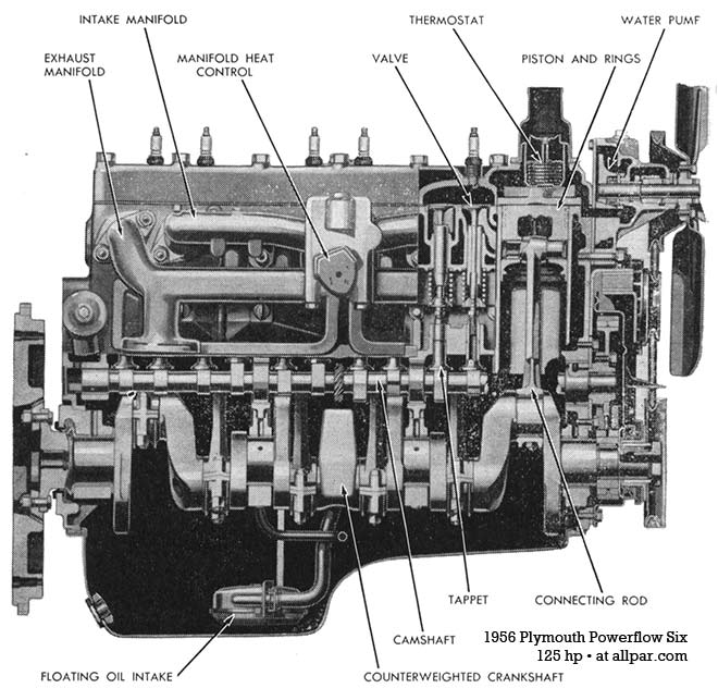

Heres a motor cutaway, you can see that it's gears, thus, if it jumped a tooth, you'd have severe dammage you would have 'heard' well before shutting down
