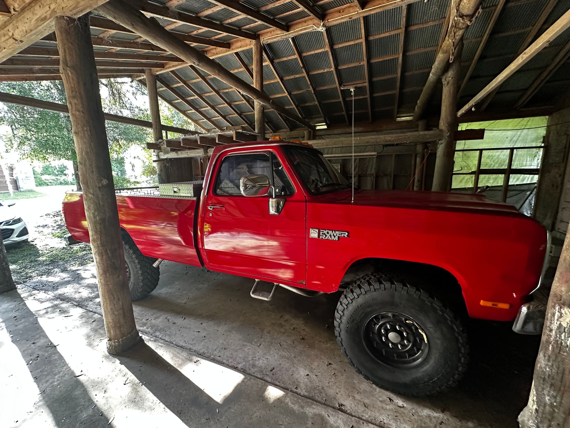

Hi I need help figuring out my truck’s fuel system issue. I have a 1988 w250 with a 360 carbureted. I just bought this truck and it is having problems staying alive when I shift it into gear. When it is in neutral, the truck idles fine and can rev with no problems. When I shift to second gear, it will run fine. shift to third, it will run fine up to about 30 mph or so and then it will start bogging down and surging in spurts. It will surge if I do not let off the pedal. But if I lay off the throttle it will idle at normal. I want to add that this will happen in 1st 2nd 3rd and 4th gears. Just mostly in 3rd is when it happens. So when under load, it hesitates and dies, Boggs down and almost shuts off and can’t go above around 40 mph because it will bog down if I throttle any more. I appreciate any and all help! I am new here and trying to learn everything I can! Thank you!

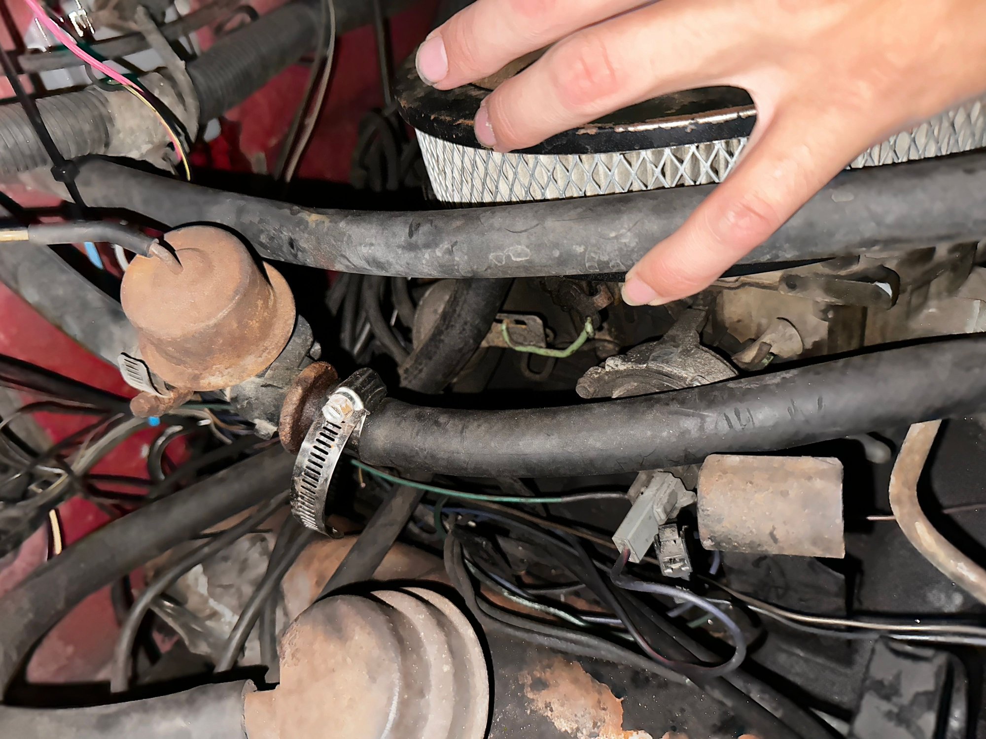

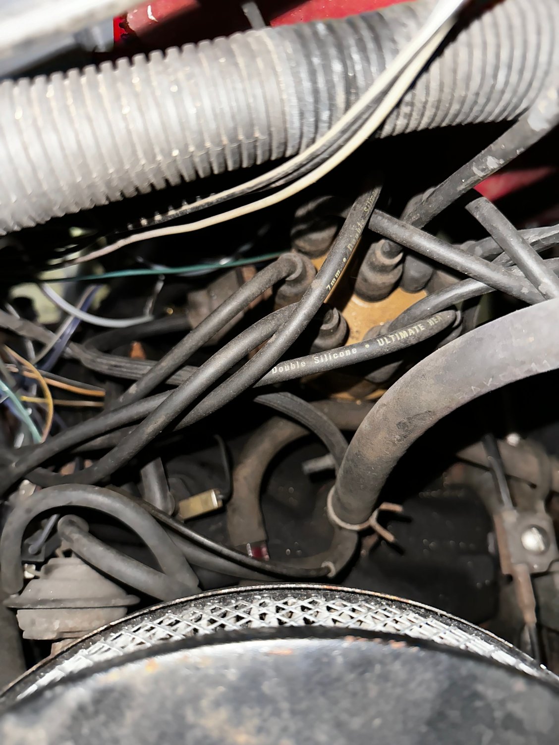

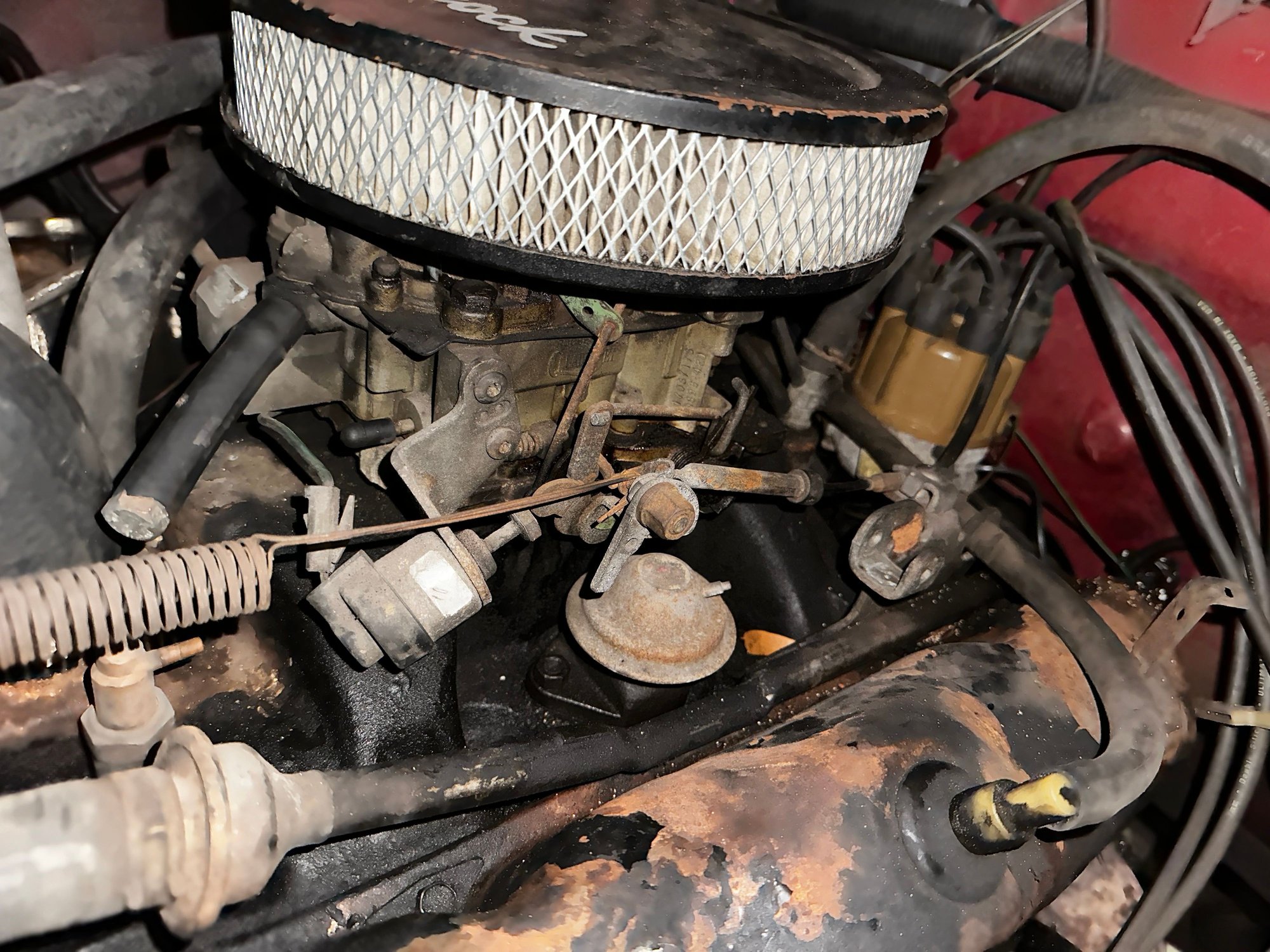

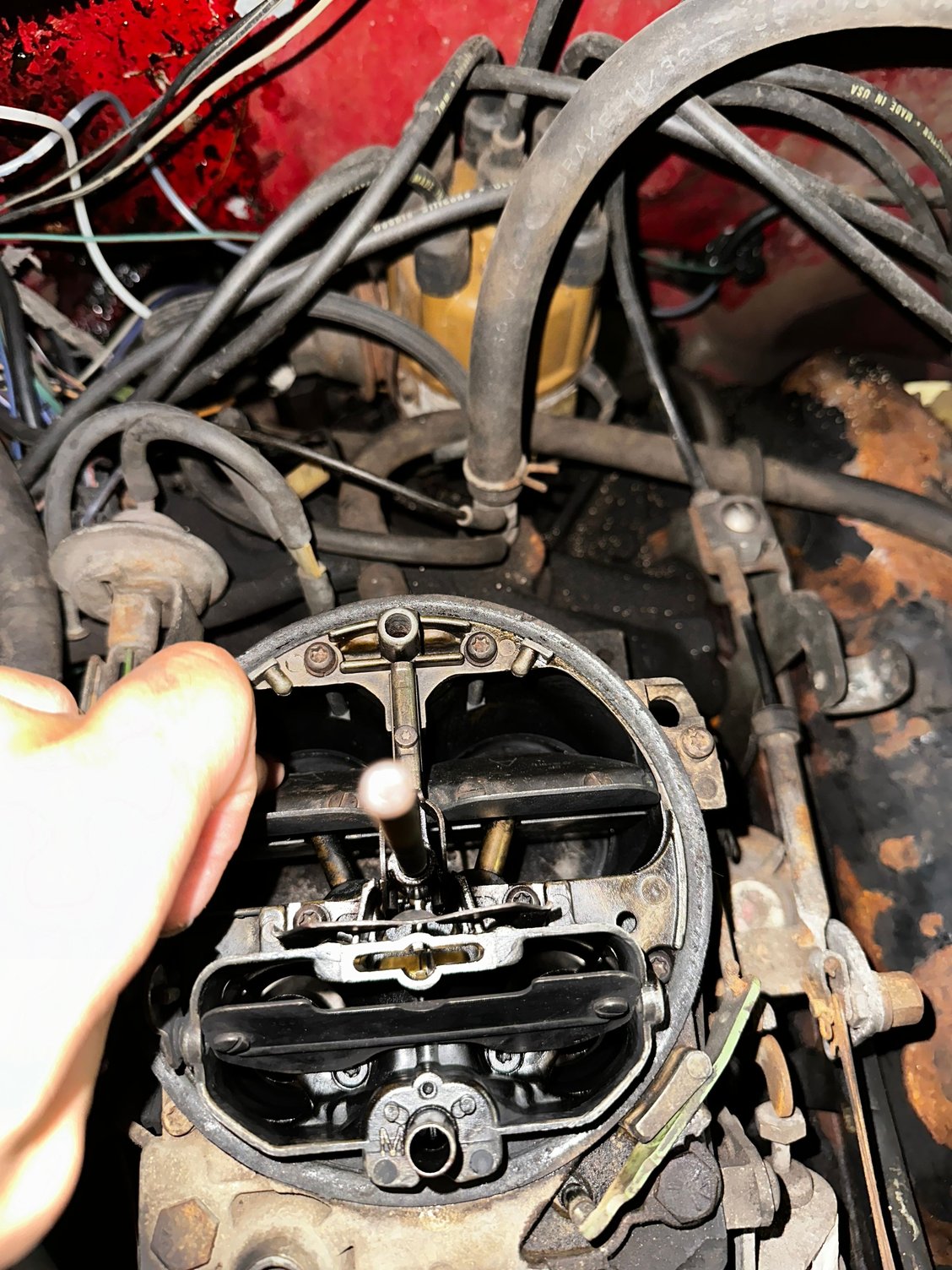

Default Pictures of carb
Right side from front
Left side from front
Back
Carb resting
Carb held open
Carb held open

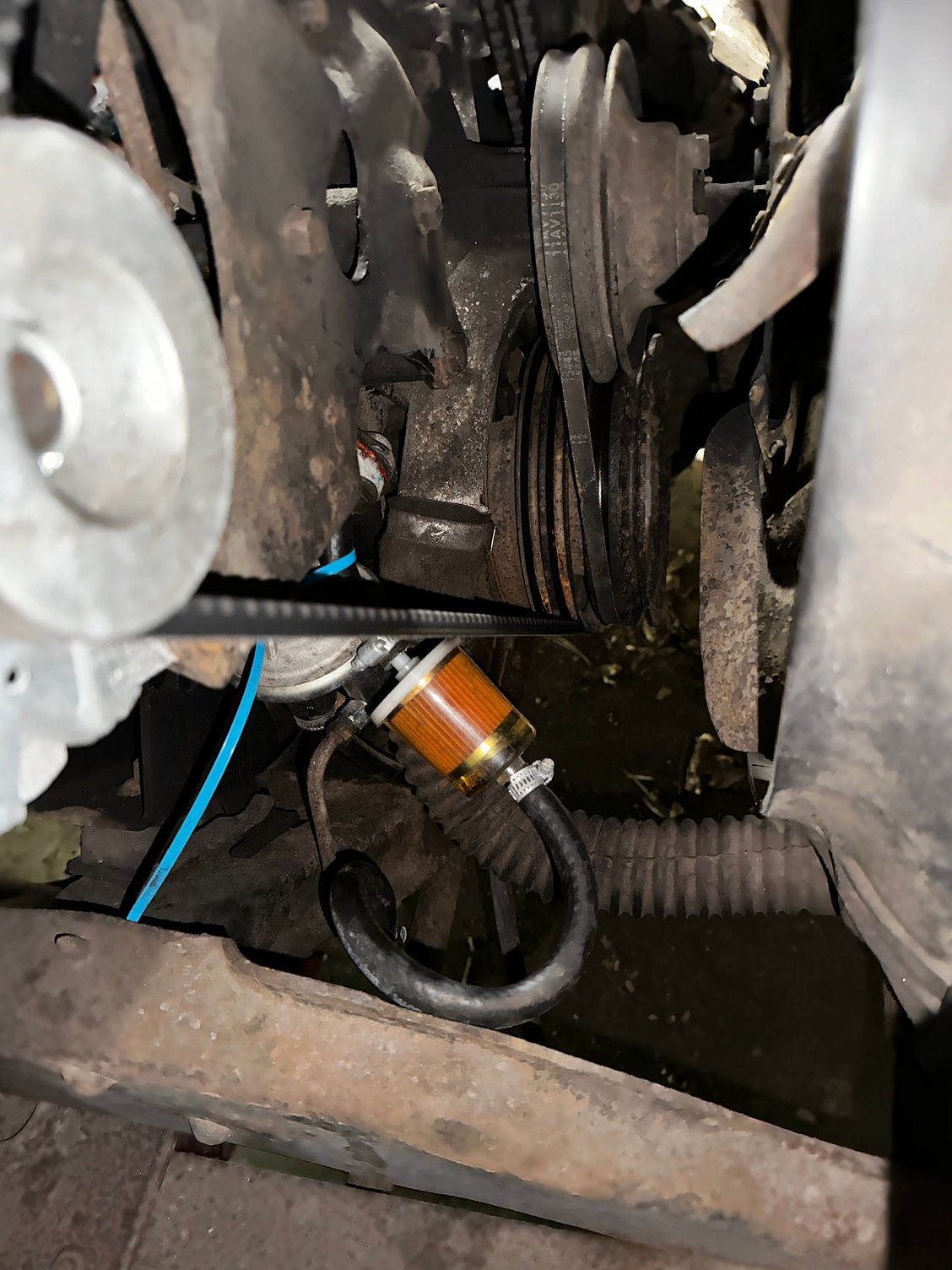

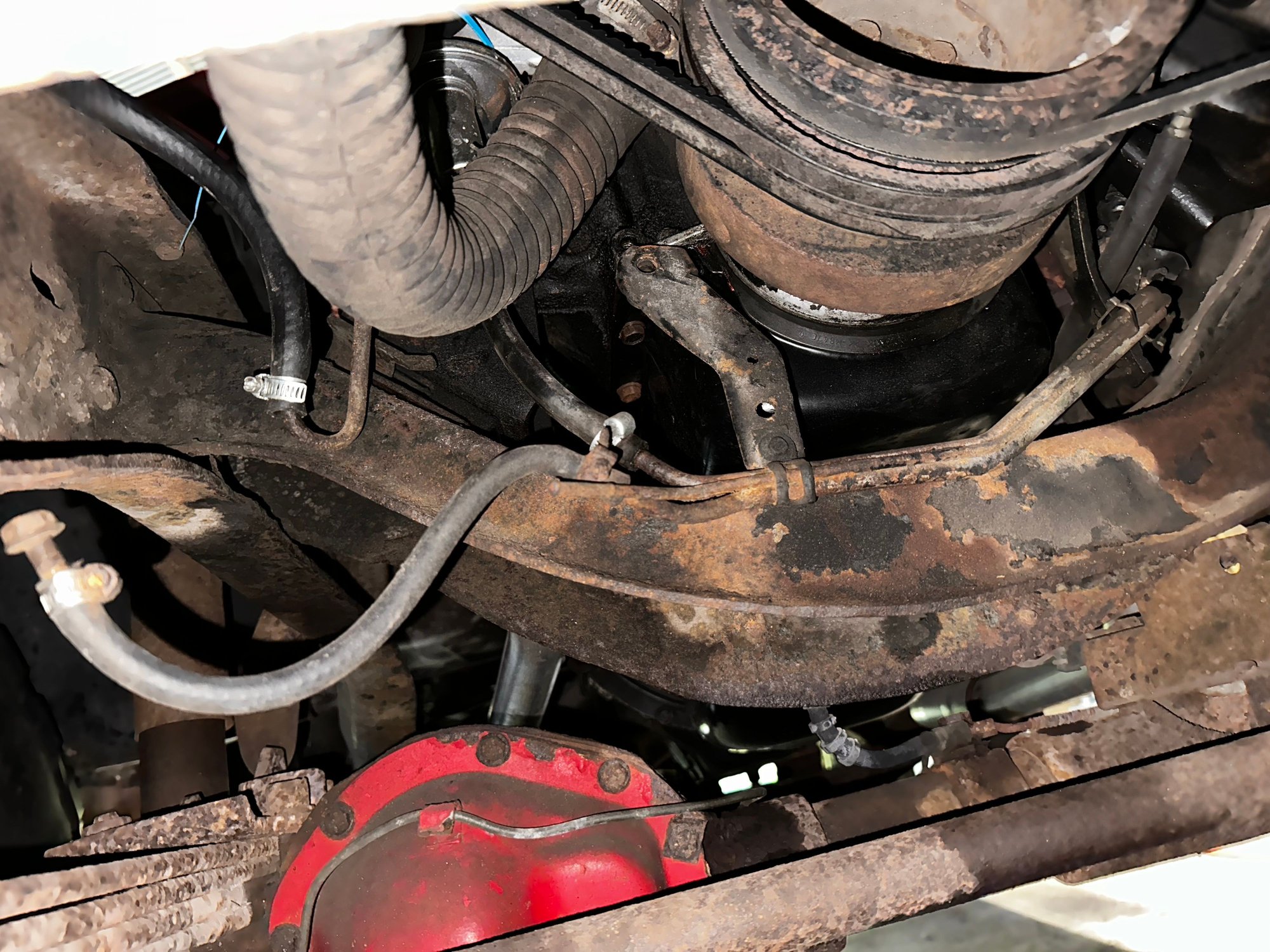

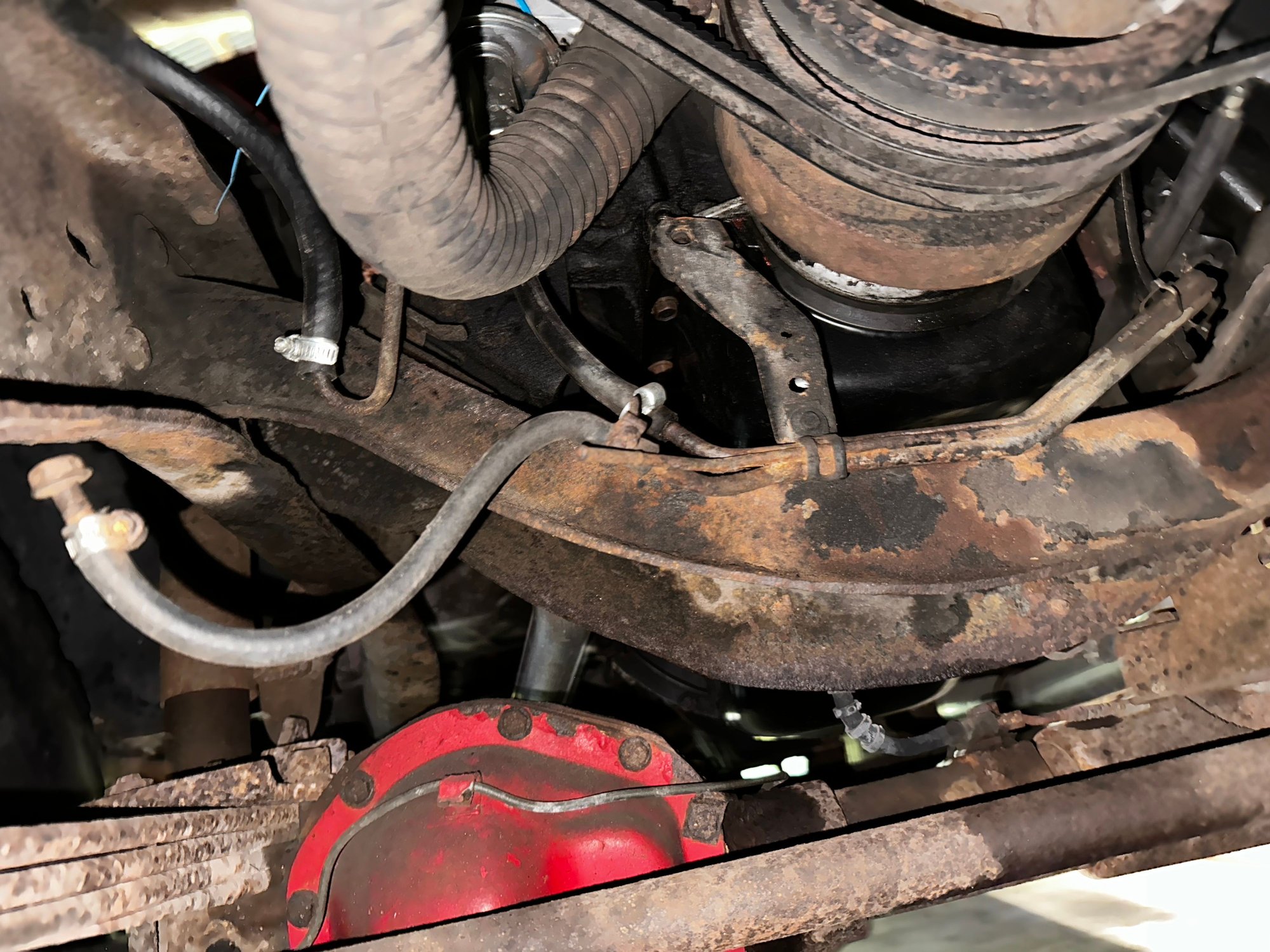

Default Fuel line pictures
You can see the small fuel line that is cut here and another line that is plugged. I have not traced the one that is plugged to see where it comes from.
Fuel filter that guy has on truck.

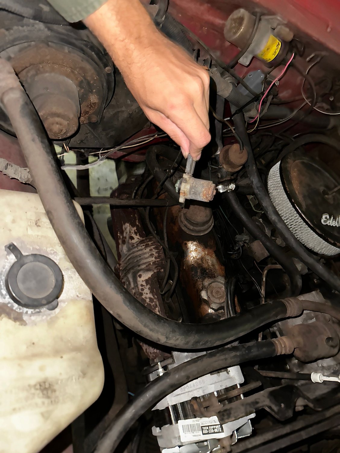

Joined: Jul 2023
Posts: 12
Default Unknown sensor
I’m not sure what this is or where it goes

That's a carb alright.... not alotta fuel in the filter there though..... Did someone put an LA motor in there??? I didn't think the magnums had the provision for the mechanical fuel pump.
