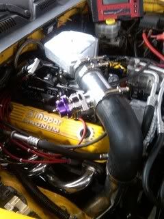

procharger is prone to horrible belt slip when you go above 8psi. Vortech is what I ran and it was top notch. There is a pisc which is a 1000cfm procharger, and the d1sc which I believe is 1400 cfm. Vortech head units are a v2sq (super quiet) and that is a 1000 cfm blower, and a v1-ttrim which is a 1200 cfm blower, and then the all mighty ysI trim blower which is 1600 cfm.
There is a kenne bell, but that will have to be found used on ebay or somewhere which is a manifold blower, and offers boost instantly. Powerdyne is a blower for about 6psi, NO more, it has internal belts rahter than gears, and belts break/snap. Paxton is a great unit, they have a novi 1000 and a 2000, I believe the 1000 is 1000cfm, and the 2000 is 1400cfm.
If I was looking to do a blower, I would go vortech for a few reasons. Since none of these kits are made anymore for our trucks, they will have to be pieced together from another mopar, brackets etc. With the vortech, rtmods.com sells the vortech brackets etc, so you can buy any head unit you want, and then buy his brackets for $1000, which includes plumbing etc. This is my truck @ idle with the vortech t-trim. You can hear how loud the blower whine is at idle, it's very nice
