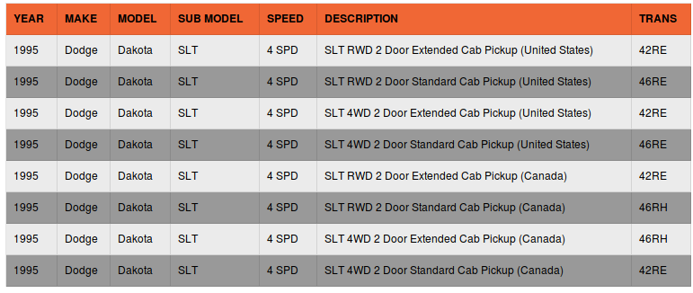

The 42 / 46RE transmissions use a temperature sensor removing the cooler is going to give you grief.
Here's the link for the full document, http://shop.ukrtrans.biz/wp-content/...alogs/42RE.pdf

I dont believe that will apply to the OP. His is a 95 and should be a RH series rather then the RE series. BTW what year does the above infrormation come from?

MoPar is doing its best to drive me insane, 95 Dakota's used both the 42RE and the 46RH.
