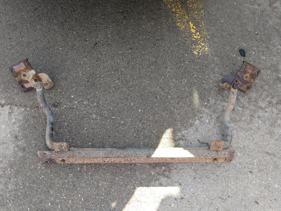

Thanks for the info Ralph, here's a photo of the bar assembly that was installed on the 90 Dakota. I removed it as a unit because it seemed easier than struggling undoing all the bits and then taking it out.
It seems that this Dakota had had some aftermarket work done, the rear window was a tinted slider that had some companies badge on it, and there was some other interior stuff too that seemed odd.
Anyway, I think the pic is self-explanatory.
Steve A

glenlloyd - I'd take that apart, get the parts media blasted and powder coated, and then either put it back on, or sell it.

That's some good advice, I need to spend some time with it and find new links for it. The old red poly bushings are cracked, not sure about the ones at the main mounts.
That bar measures 1.25", that's pretty hefty for a rear bar, especially on a Dakota.
Steve

That is; I'd be concerned with that much on the rear, without a monster bar on the front.
For the end links, you CAN buy just the poly bushings. Or measure the end links and order the "generic" ones from Energy Suspension and/or Prothane.

Yep and yep. If I use this I will definitely be upgrading the front to something more compatible. I actually think I can get the links undone, at least I hope, that way I can just replace the poly bits.
