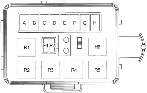

Using this diagram, I have .04 with the black on the battery ground and the red lead on B
When I jumper A and D the truck will start
i have voltage on fuse B from this diagram.

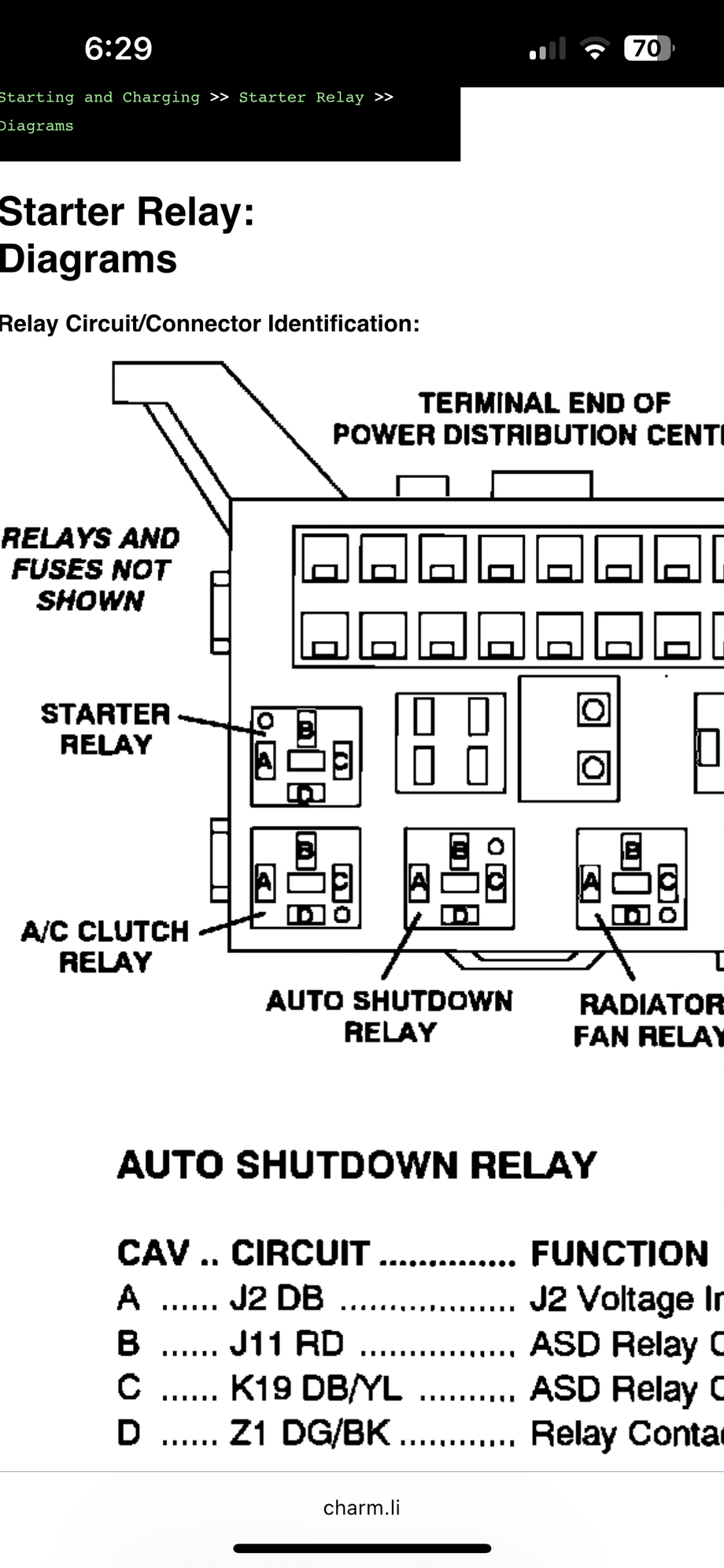

Swap the starter relay with the AC clutch relay and see if it starts.
Same thing. No crank. The relay engages and I can feel a click.

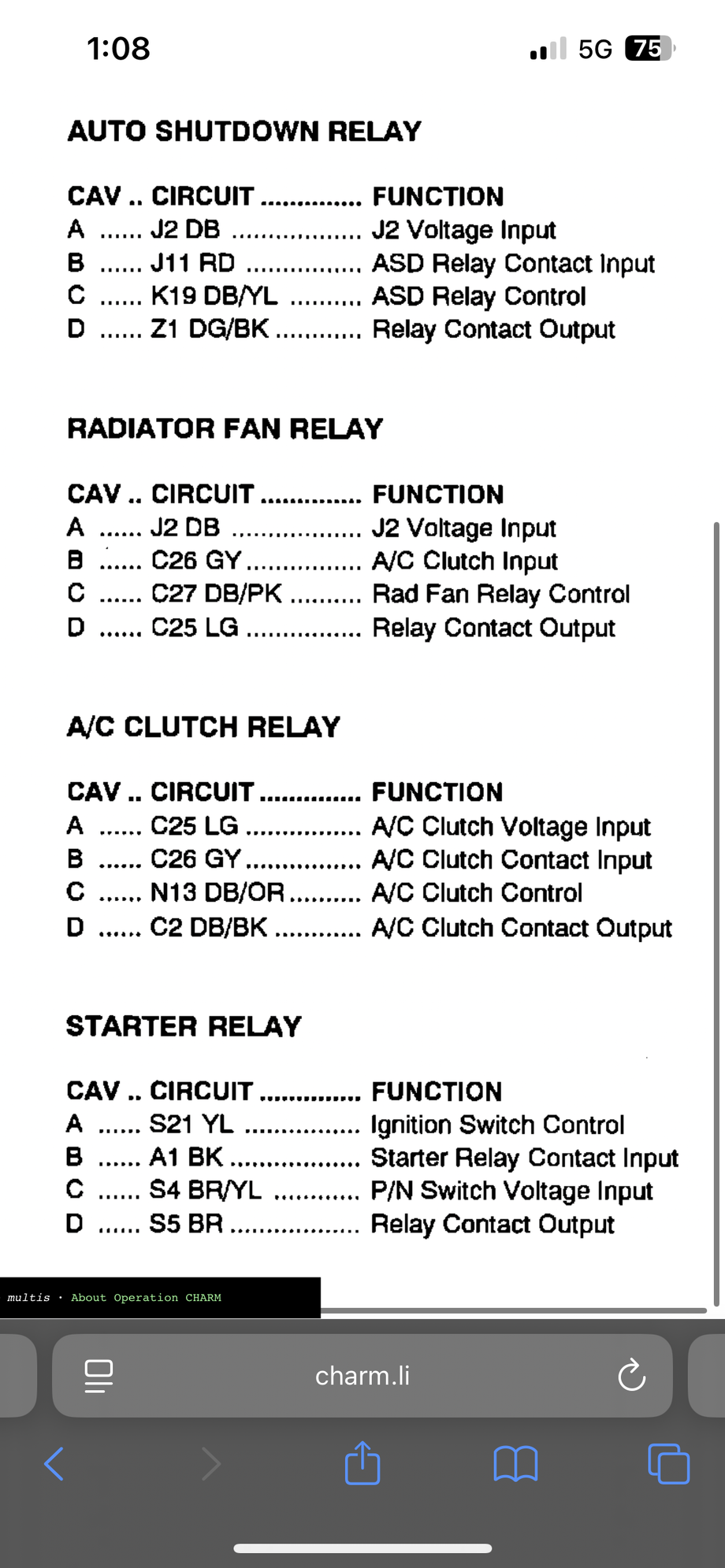

Wiring diagrams I have access to don't label the pins on the relay. But, there should be one pin that is hot at all times, that runs thru Fuse B..... If the relay clicks, then the other side of the circuit is working the way it is supposed to.

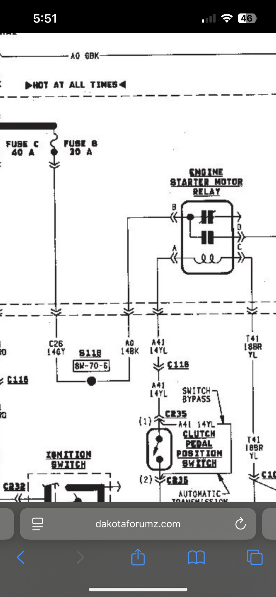

from the looks of this diagram the B contact would be the live one. I’ll look into that tonight and follow up.

Posts: 8
I agree. Check it out, let us know.
OK, according to this diagram the hot for the relay comes from fuse B and goes to “S118” then to the B connection on the relay. Any idea what the S118 is? I’m having trouble following those wires.
Old Dec 3, 2025 | 09:03 AM
Posts: 87,483
If you have the service manual, there will be a selection for splice/component locations....
